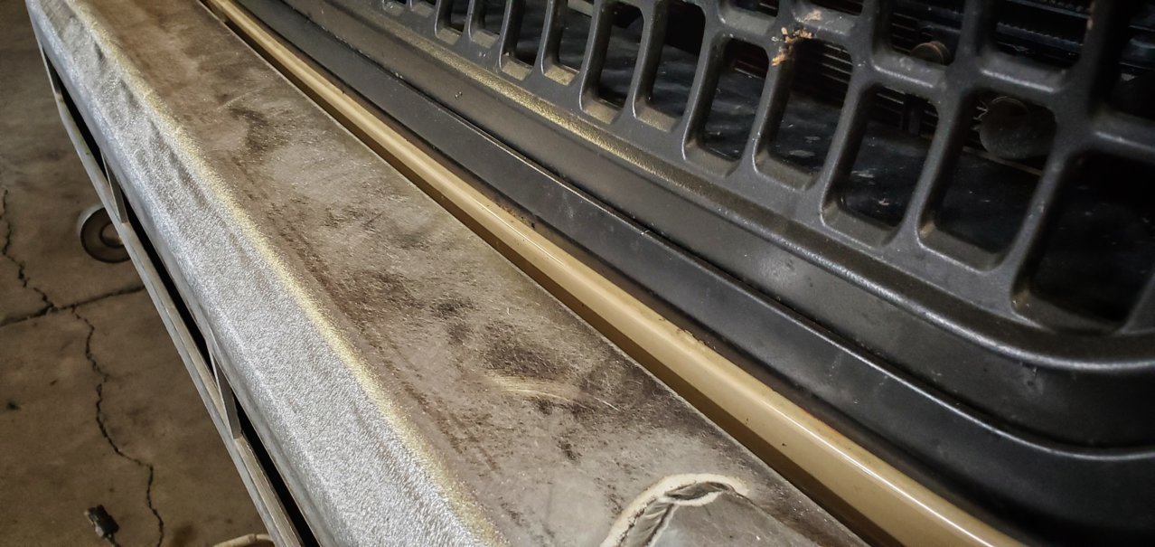

    Really? We were not able to remove the grille after installation. Do you have broken clips in the grille. The bumper should be in front of it not allowing the grille to come straight off.
    Not sure how your getting that off with the bumper installed without scratching it all up in the process.

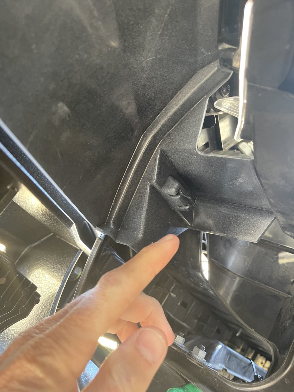

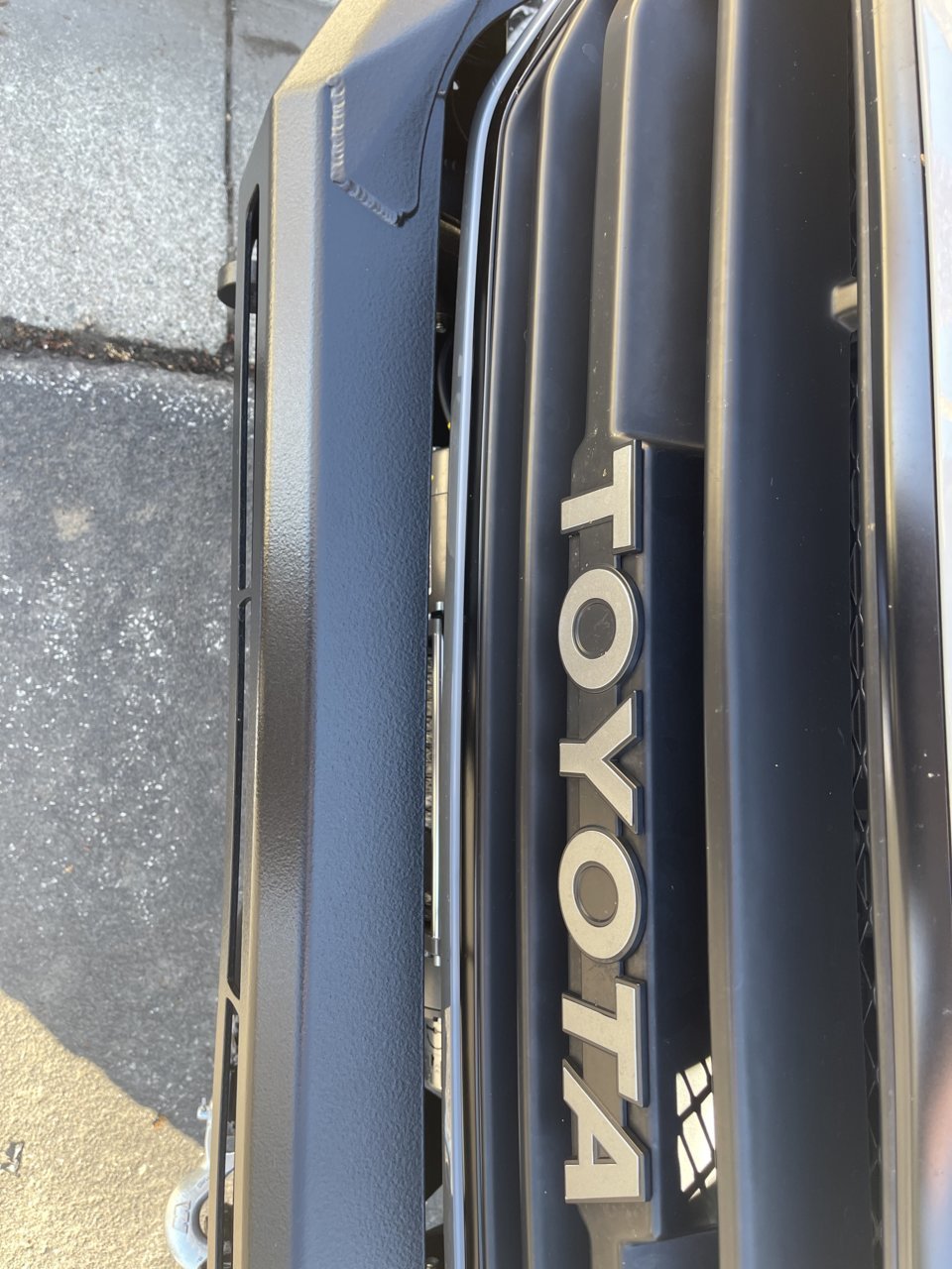

    @JLee no broken tabs but I am using the Running4Taco caps verses having cut the factory skin. See pictures below. I press the tabs out from behind and I lay a towel in the gap up front to protect the lower portion of the grill. The gap in mine seems to be a bit more than your picture though.

    Note the section under the black fender cover is a bit of a bear to press in...really have to use some force with your thumbs to get them to snap in and seat correctly.
