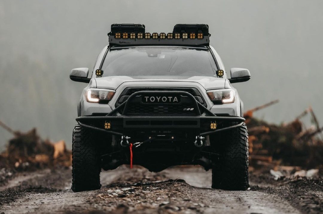

    I also had the photoshop thread mock this up for me with @Chaury08's truck with the recessed grille to see how the full hoop would look.bamfgrill.jpg

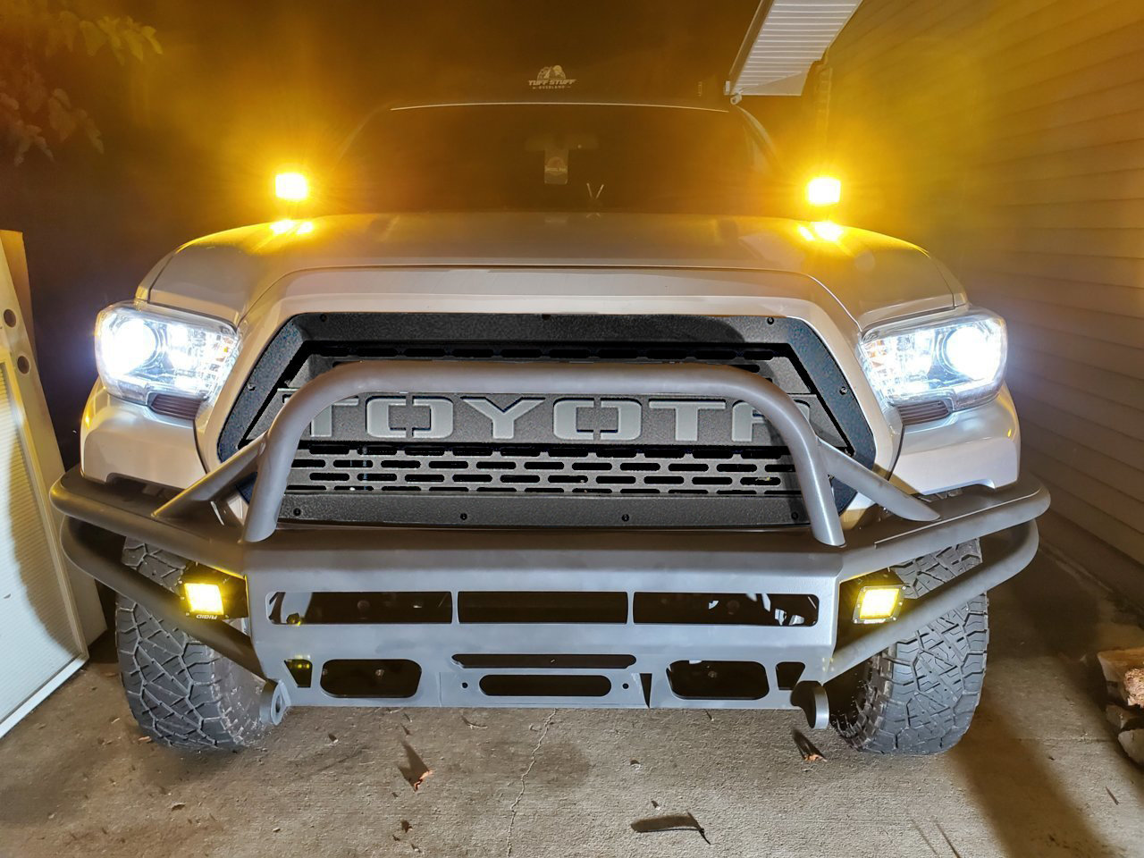

    well, ended up pulling the bumper a couple inches to get the grill back in.
    looks great, had to mod the hood latch support structure a bit to get the winch control box to fit without a relocation kit.
    So happy there are those giant holes to get your hands into for various things.
    what gap is everyone running between the wings to the bumper corner/fender flare?
    I'm at 1/4" now, not sure if i need to increase the gap to keep from rubbing?

    Looks great! if your not twisting the truck out off-road 1/4" should be good. If your wheeling it I'd go a least 1/2" or you could pop a flair off flexing it out.

    sounds like I'll need to do a bit more trimming then!

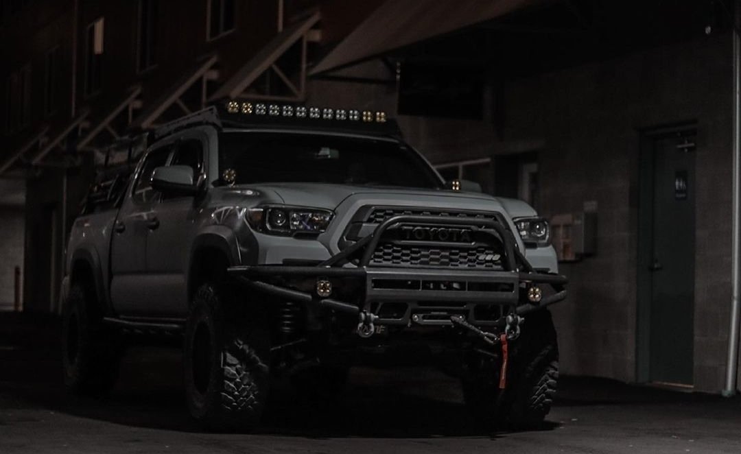

    High center hoop action. @the_dark_yota on IG
