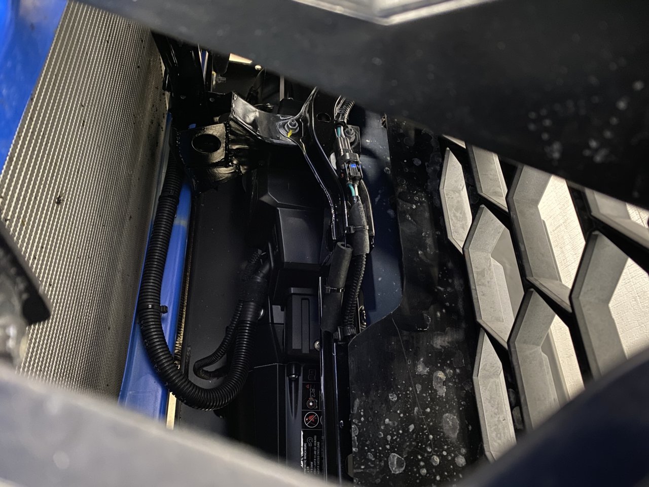

    if you don't want to mod the hood latch bracing / cut the bottom of your grill (not visible area), you definitely wont be able to mount it on top of the spool

    That will be with just about all winches. The grille support gets in the way unless it's off to the side.

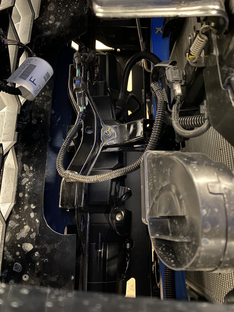

    Probably pretty hard to tell unless you’re familiar with the area but you can see what I did to the supports to fit the top mounted control box on my warn 9B33AB17-8F5D-4030-A264-ECBC356FC797.jpg8969FDF3-4C86-4875-BBEC-27C06D153606.jpg

    Thanks. I pulled the winch out of my previous bumper. Had to relocate to the side. Wondering if i can do the same without modifying anything?

    there's basically no room above the winch body to mount the control box unless you modify the support/braces.
    you'll have to relocate and make different brackets to attach that control box to somewhere. Plenty of room above the brace, just need to get above it.
