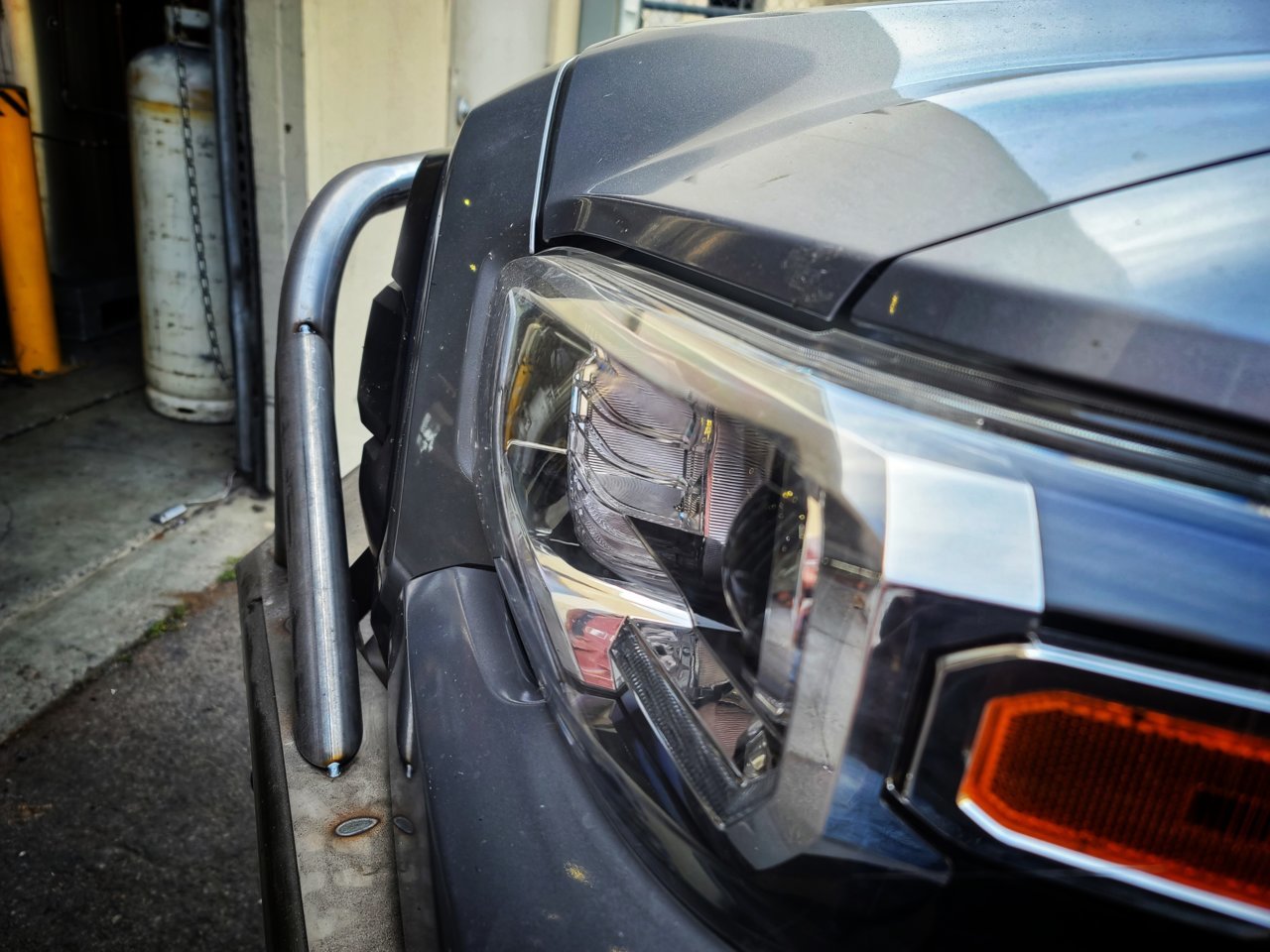

    this cut is super clean but if you are seriously wheeling a gap is necessary. The amount of flex between the body and frame can cause the bumper wings to rise and lower up to as much as an inch in some cases depending on the positioning of the truck

    damn, didn't realize the movement would be that much. I plan on pulling the bumper to install the winch and put another coat of paint on it, so I’ll recut then.

    Anything less then 1/2" gap and you will be popping off fender flairs if you really flex out the truck on a 3rd gen.

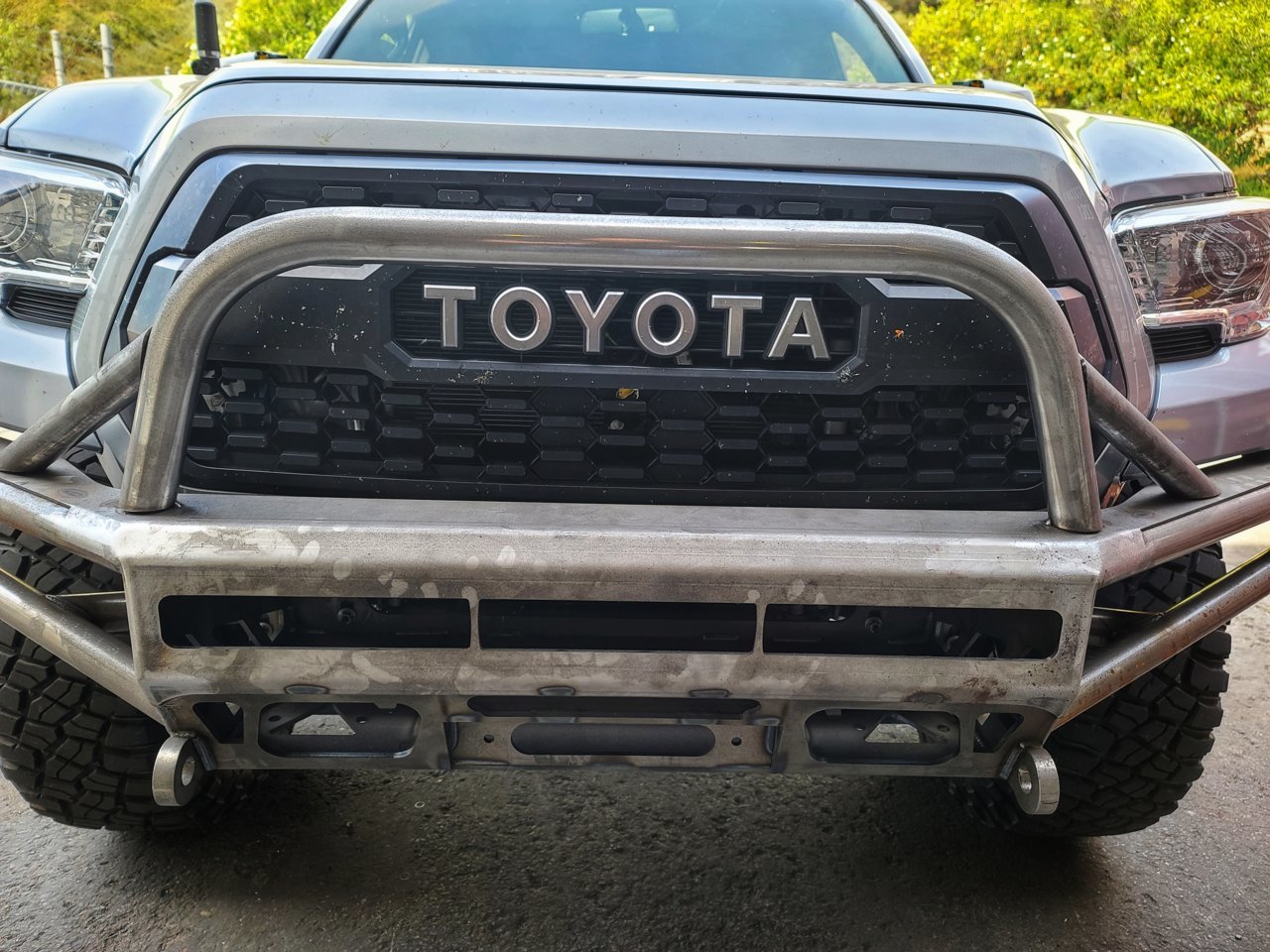

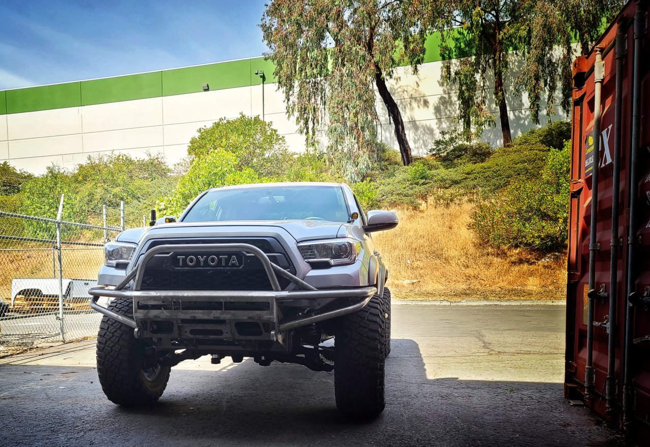

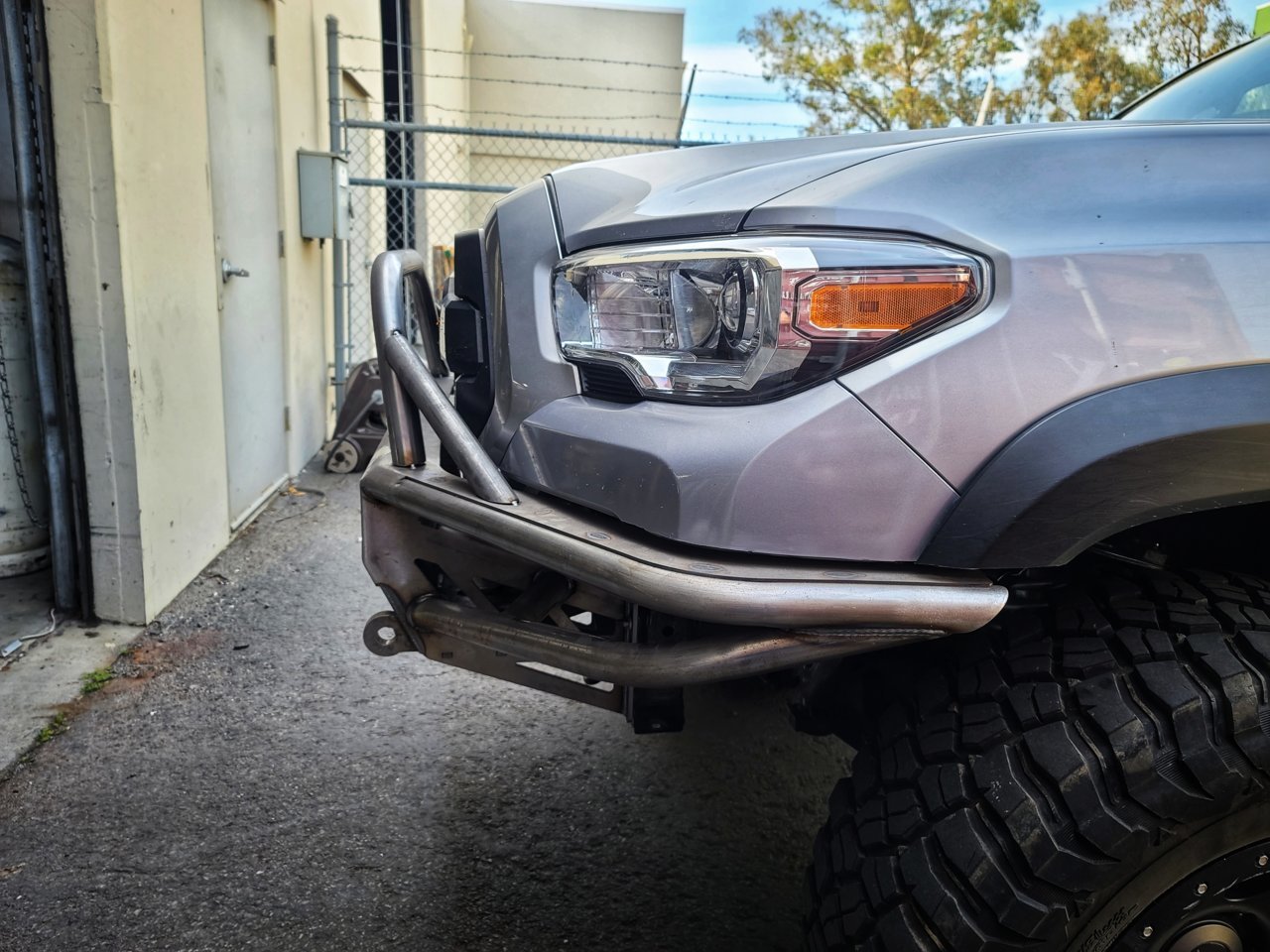

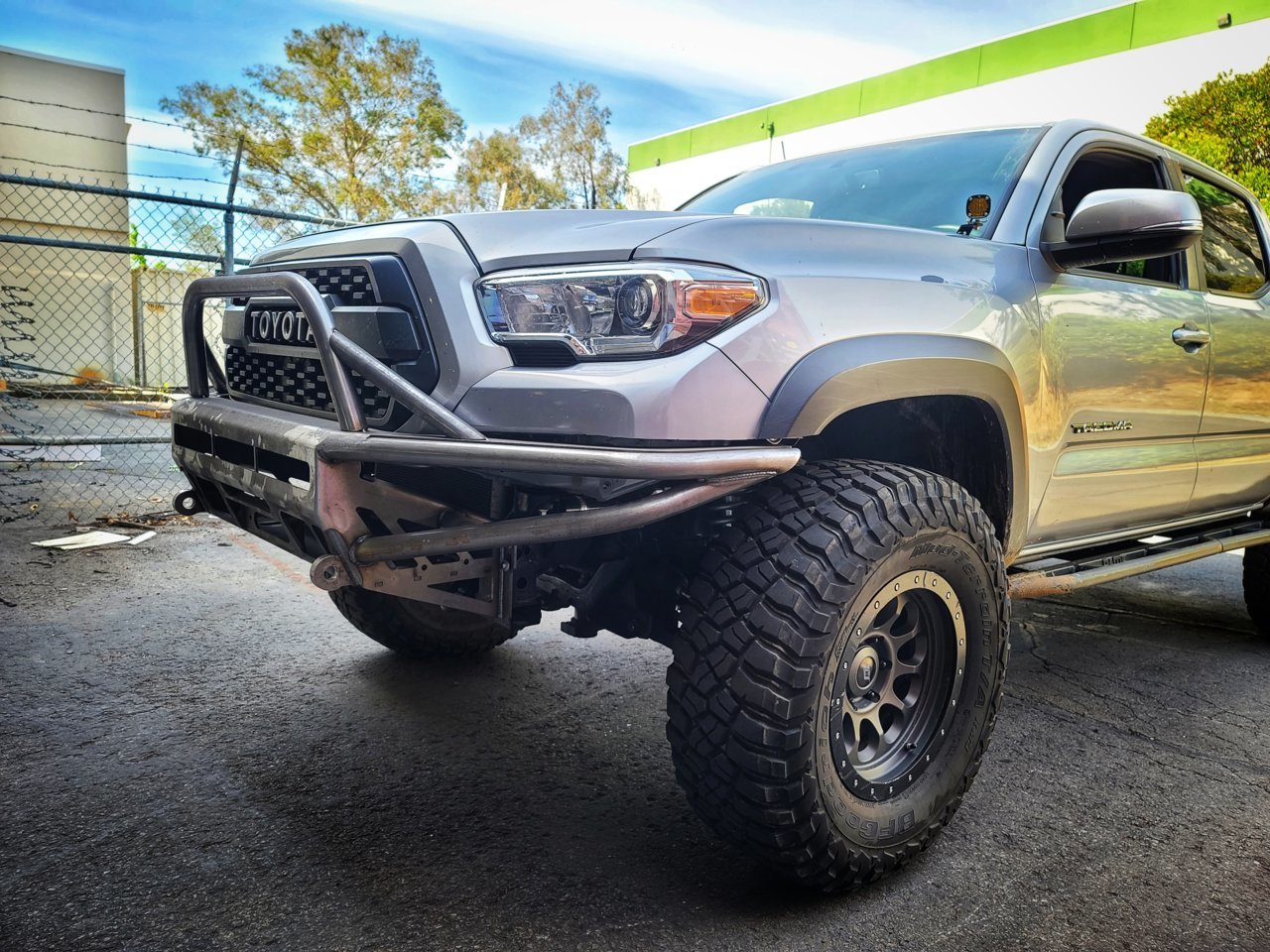

    And here is the installed pics of the high hoop.
    We kept it tight so we had to check the PRO grille clearance before we started shipping them out.

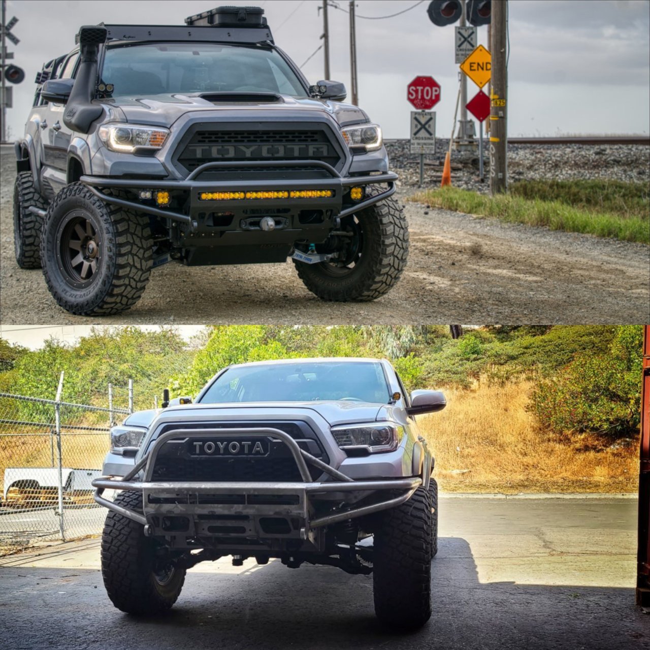

    For those people like myself that need a direct comparison to help with their indecisiveness. 20200512_122126.jpg
    Incredible work @JLee :hattip:

    Daaaang. Yeah definitely knew the frame mounted bumper needed space from the body, but that certainly puts it in perspective. Gap time!
