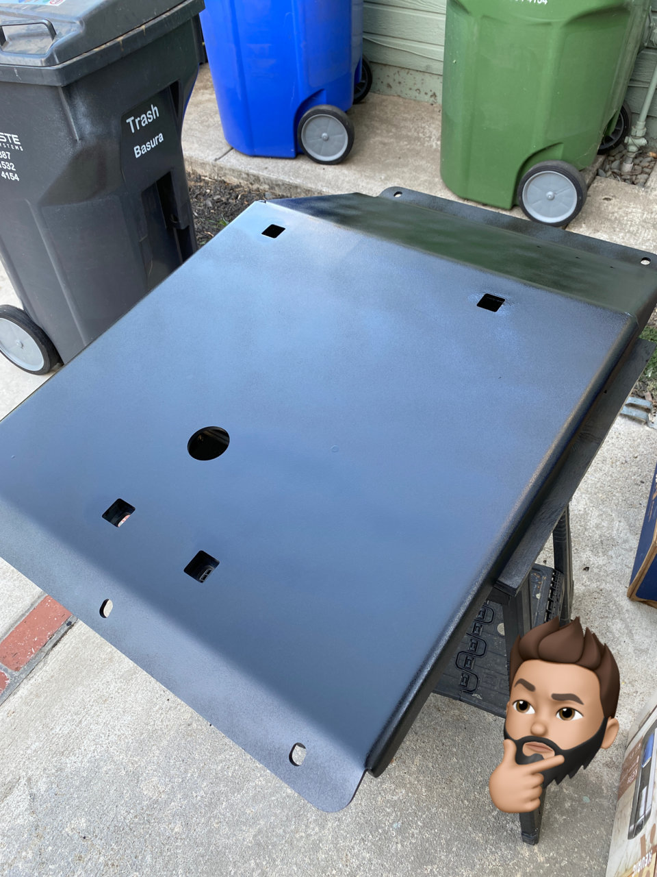

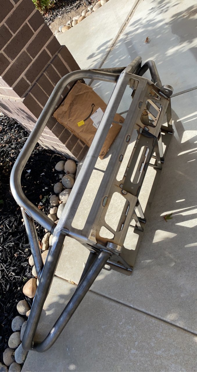

    Scooped them up today. Dropped off the bumper to get sprayed, Doing the skid myself. Fucked up & forgot to buy the bash plate ‍♂️

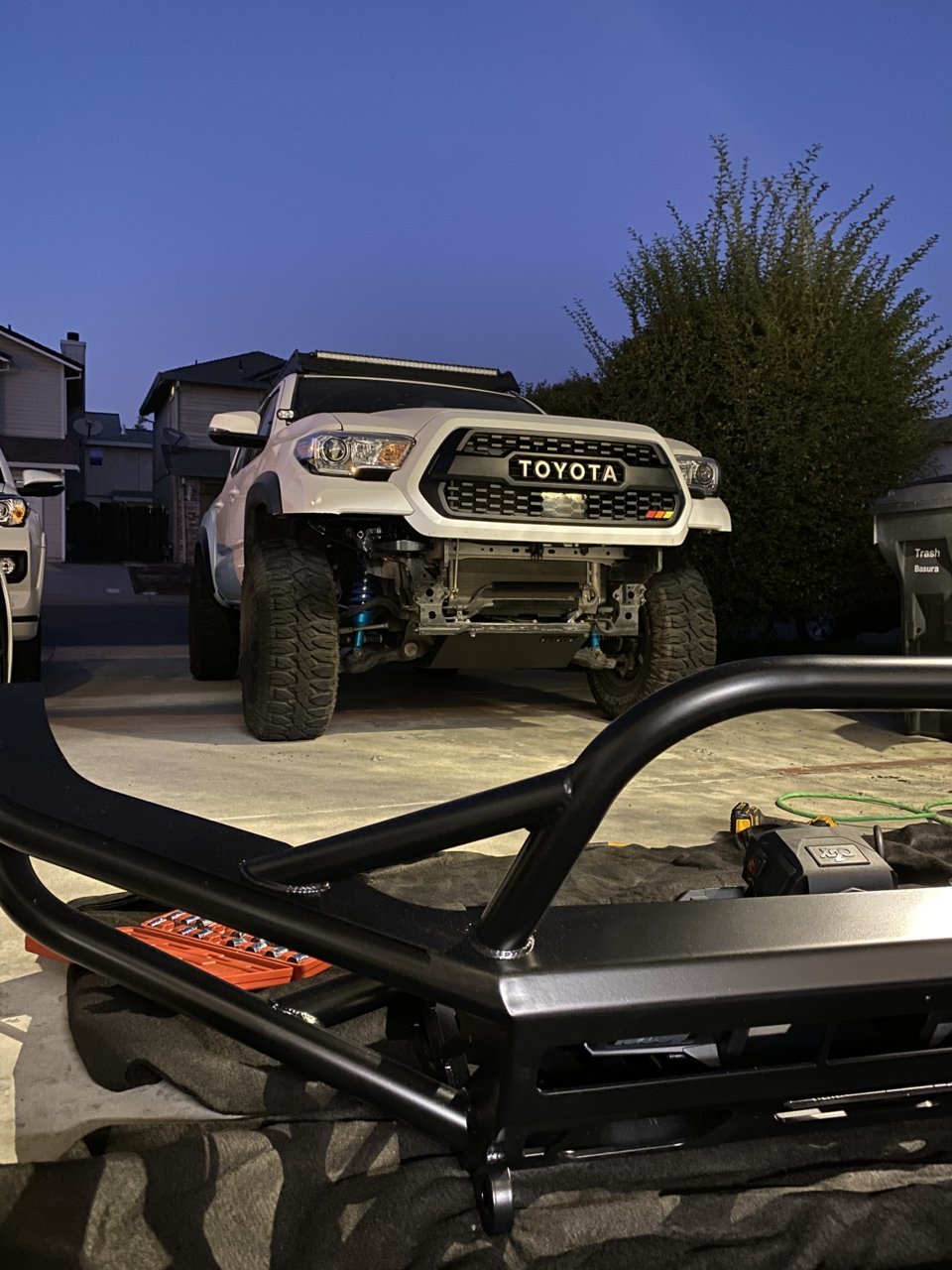

    The light bar bolts right up to the tabs on the bumper via new bolts hex head and a wrench?

    Correct if your light bar has socket head cap screws on the ends you will want to swap them out to hex bolts so you can tighten the bolts or modify an Alan wrench to fit in the location.

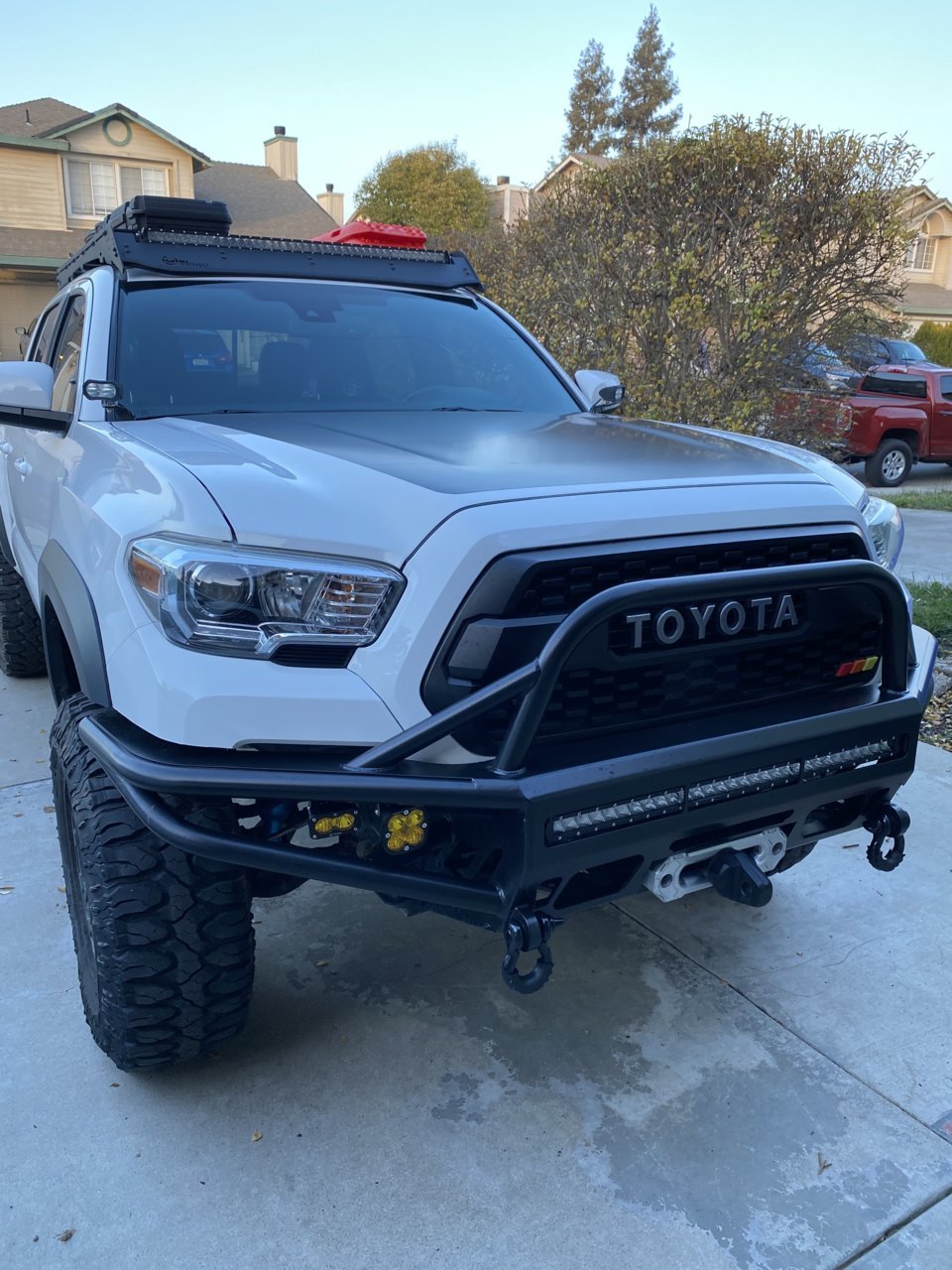

    I’ll end up taking it off to install the light bar on & to re adjust it. It’s a little lower on one side.

    Can’t wait to put the Bar light on and the fogs to add some color. No problems with the TSS sensor. If you are having issues with the sensor it might be from lifting the truck or switching out the grill to the pro grill. Which I encountered both issues not related to the bumper

    Bumper looks awesome on your truck. What size Springs are you using?

    I’m currently on the 700s the 600s dropped down like 1.5in with the winch on the bumper. Added the 700s and adjusted the height we good now. Bumper & skid plate so far later I do skids all the way back & sliders

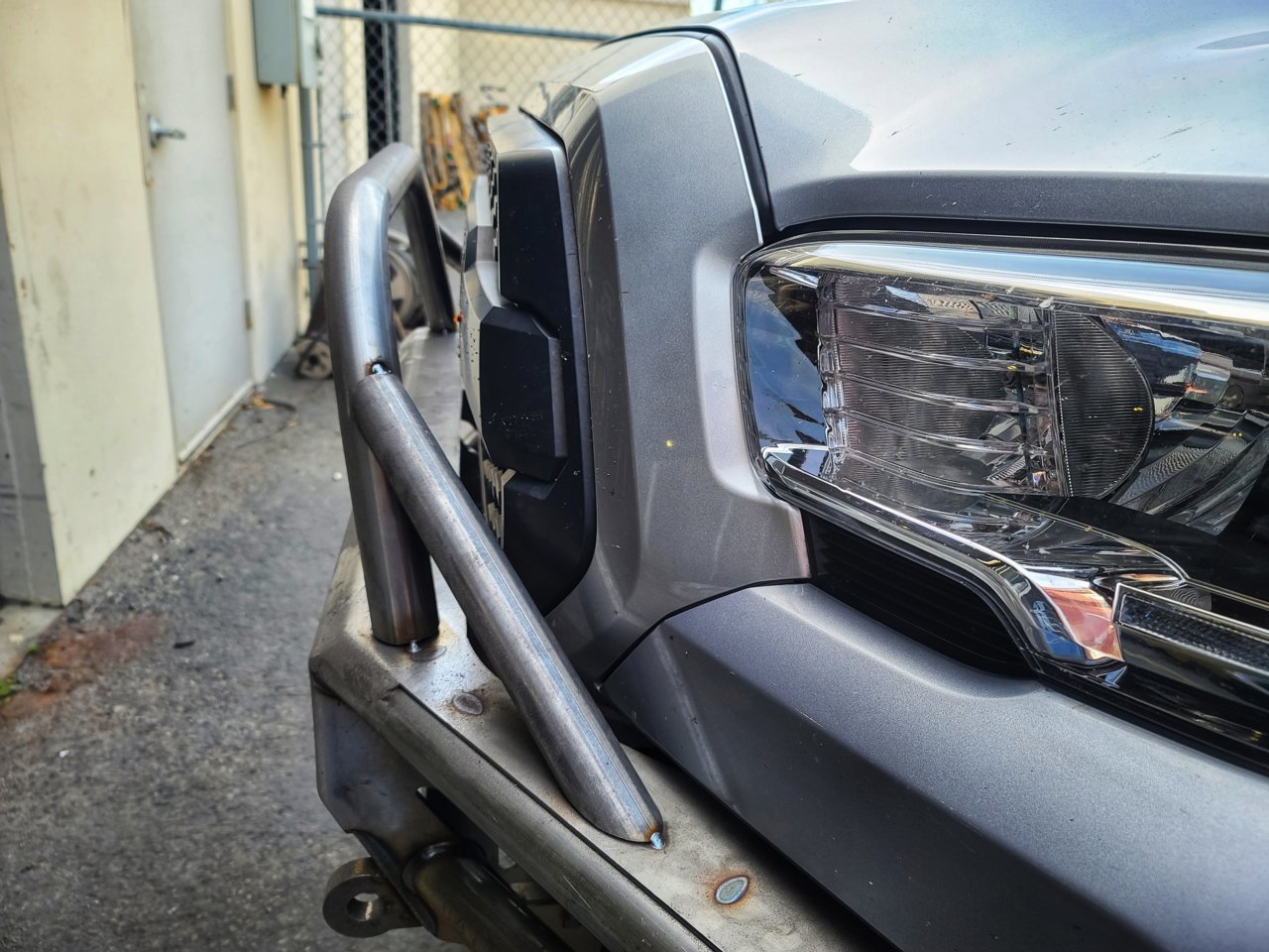

    guys with the tall hoop, can you get me a rough measurement on the gap between the top of the hoop to the grill?
    I haven't bolted on the bumper yet (won't be able to for a bit) but welding on some tabs for antennas/etc and wanted to make sure it's not going to interfere/poke through the grill.

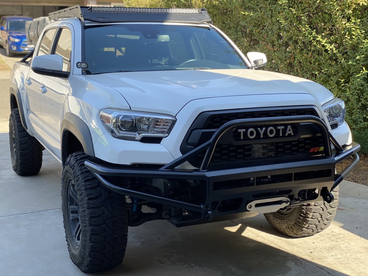

    thanks! I did find this picture a couple pages back and think I'm in the clear but it'll be nice to know for sure how much room that is

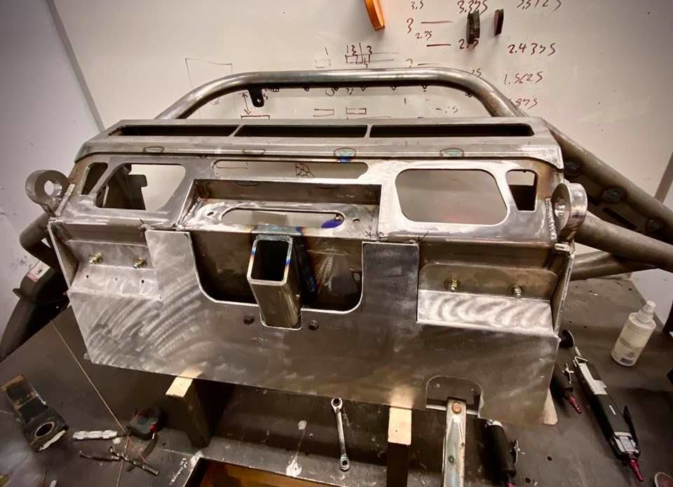

    you can see the tab i added up on the left of screen here

    We did one like that for a customer I like what you did with the bash plate. I never took a measurement But it's about 2.5" from the grille on the pro grille. All the others have even more as they sit more flat in the surround.

    Awesome, thanks! Good thing I haven't gone to the pro grill!
    Sounds like it should be enough clearance as-is.
    not quite done with the bash plate yet, right now it's just a scoop for crap to get into!

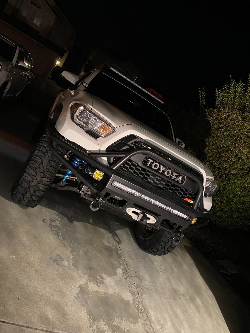

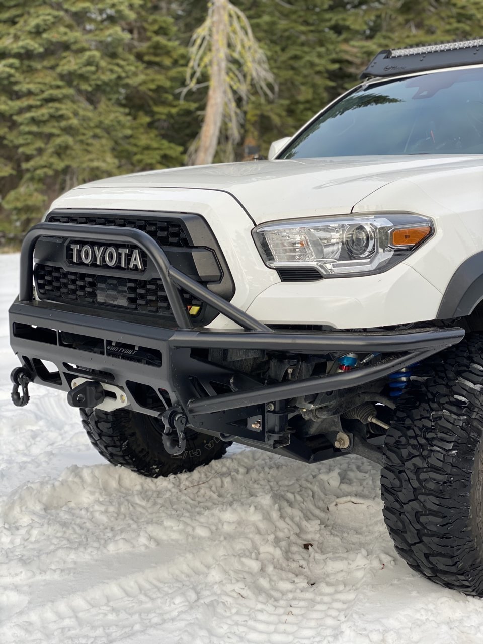

    Hopefully this is what you wanted
