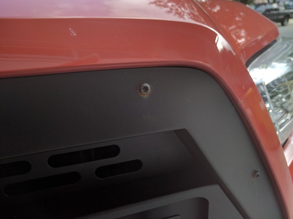

    Is anyone having rust issues? It's been raining here in MD for a few days straight now and I went outside today and realized there was running rust coming from every one of the bolt holes. It is very unsightly and I certainly didn't expect any rust issues from a 500 dollar product within a few months of owning it. What gives here? What can be done to remedy the situation? Taking the grill back out and anti-rusting the bolt holes is something I shouldn't have to do and do not want to have to deal with.

    I think it's either;
    1) inner lip of the screw hole that did not get covered during powdercoating (resulting in exposed bare metal)
    Or
    2) tightening down the torx screw too tight which caused the screw head to chip off the powdercoat underneath.(resulting in bare metal)
    I don't think the screws are rusting themselves?

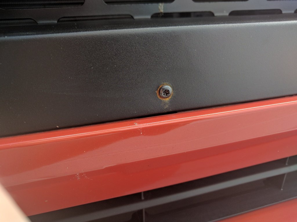

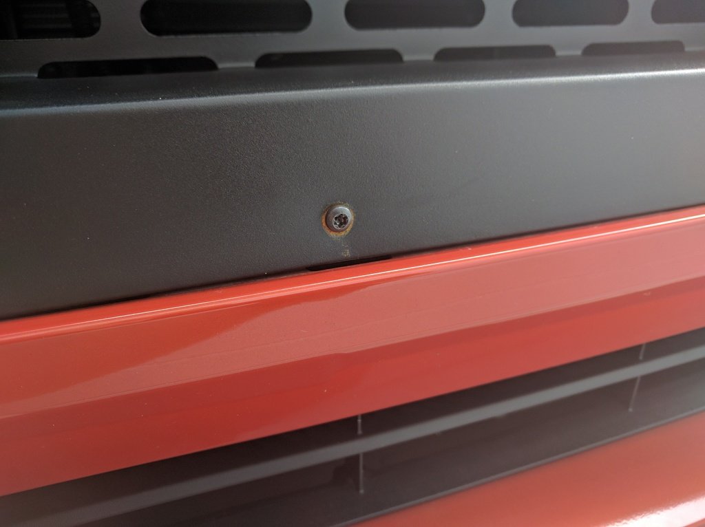

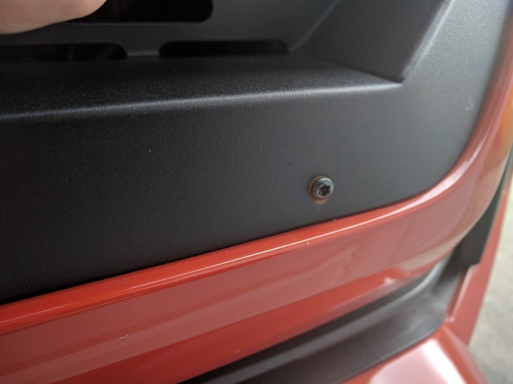

    Not sure why the other member's pictures were taken down, that is interesting. Here are mine for reference through, they are quite bad and I am not a happy camper. I'll be contacting BAMF for recourse

    The coating on the holes is compromised the bolts themselves are stainless steel you need to make sure when installing it that you don't cut into the coating. All you need to do is put a little black rtv on the hole to cover up the bare steel that was exposed during the install.

    Was this from the first batch of grilles? The first 10 that went out had smaller holes causing the coating to be chipped away when installing. I contacted every customer that were in the first 10 and they were aware of it. If that's the case they should of told you about the under sized holes.

    After a (brief) conversation with JLEE over PM, the official answer seems to be "put some RTV or clear coat on it". I don't believe that is an acceptable answer once again given the vast cost of the product. But to each their own, I will do my best to contain the rust utilizing touch up paint and some type of method to prevent contact of the hole edge as I am bolting the grill down (it is asinine this is required IMO.)

    I'm sorry you feel that way but the person you bought it from or you compromised the coating on the holes when installing it that is the reason it's rusting on the holes. So touching it up Is your only option it's the same thing as if you had a rock chip it would need to be touched up just like the paint on your truck.
