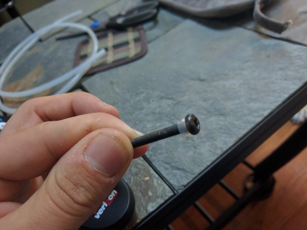

    This is my plan as of now. This is a sliver of Nitro R/C fuel tubing that should prevent the bolt from moving around as it is getting tightened down.
    spyh0p[QUOTED] likes this.

    That should work as long as it does not make the head of the bolt stick out. You might want to share exactly what size tubing it is so that anyone else could do this to as a preventive measure.

    I will post the exact tubing once the paint dries and I test fit inside the hole and make sure everything fits well. It is compressible so I think it will fit within the bolt hole regardless.
