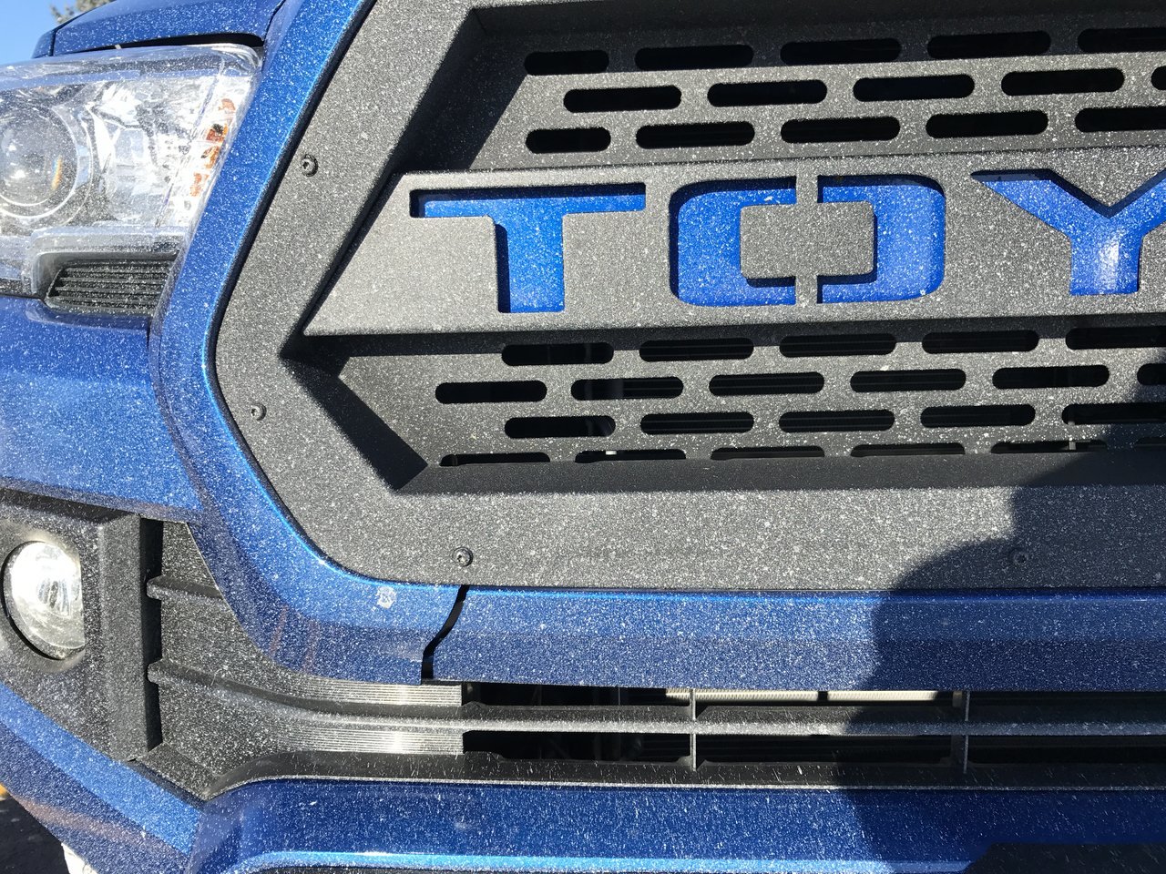

    Drove to work this morning, -8 out, parked, POW, now I don't need to wonder if my surround will break.

    -8 :eek: I'm freaking out in the mid 50's over here. You guys in sub zero temps should run the stocker for the winters or fiberglass the back side of the grille surround.

    Uhhh I didn't know this was a thing...these breaking in cold temps? It's 18f where I'm at right now...

    If mine didn't already have a hairline crack from last year I probably would, its 16* at the moment.

    There was a few last year that i seen and with the cold front going on in the mid west and back east I'm sure a few more will pop.
    The surround gets brittle and shrinks in the cold temps and the insert will not shrink like the plastic.

    Damn dude, that sucks. At least mine is a straight break. Really no way to make that look good. :annoyed:
    With this cold weather that has settled in the midwest I suspect there will be a chorus of POWs as all of our surrounds crack.
