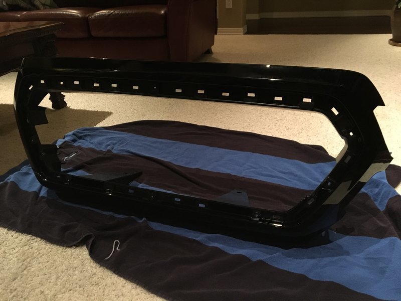

    Could not wait... took off my grille in preparation for JLee's.
    Here is a youtube video I found helpful.
    https://www.youtube.com/watch?v=0K0Q2XJwlMk
    Few Hints about removing the grille.
    1. 2 screws and 2 plastic tabs on top ( center plug on plastic tabs need to be pryed up first to remove).
    4 plastic tabs along the bottom.
    2. After removing above, gently lift up on plastic that is resting on where the 2 screws were. Pulls out easily.
    3. Video does a good job of explaining which screws and tabs to address. HINT: When unlocking the tabs I found it much easier to get one started, then pull that piece( bezel first, then chrome grille) from the front slightly to maintain tension while I used the other hand to loosen the next tab. I went around the grill using this technique and did not break any tabs. I gently used a standard screwdriver head to push the tabs in to loosen. Don't push too hard into the tab otherwise the center piece will break off. Only matters if you want to keep the original grille.
