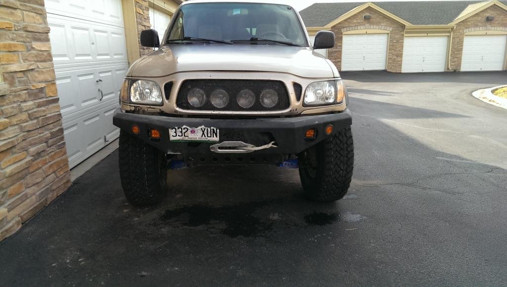

    i ordered and installed a BAMF light mount for behind the grill, without making a new bracket to kick my current LED bar forward, it wont fit. Any of yall have this mount? what lights do you use? ive reloacted the horn already, i was just having clearance issues with the center support bar and the back of the light.
    i was thinking of if some 4-5" HID's would fit, that would get me the light output im after and i could mount the LED bar on top of the bumper.

    The only thing I could get to fit in my was a slim single stack I'm hitting the grille and the center support.

    Would the LED bar mounts pictured with the 2nd gen brackets work on the 1st gen mount? looking at the pictures, it looks as if that would give me the clearance i need by pushing it forward a tad. I have tons of forward clearance with the Grillcraft griil installed at the very front edge of the grill surround.

    Sr.-20 mounted perfect behind my grill with all BAMF equipment.

    yeah i had no issues at all with the BAMF mount on my 2nd gen, even had 2 21" light bars mounted on that truck. first gen gets a bit tighter,

    I manged to fit 4 - 5" Procomp lights behind a thin lip Satoshi. There was a little bit of wiggle room, but not much. Problem with HIDs I would think would be the depth.
