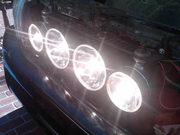

    Four 130 watters!
    I AM A BAMF!

    LOL, I got a pair of 130's bulbs left over because I wanted all KC bulbs. The only problem is that you have to upgrade the wiring or else you will melt the 55w wiring. The KC's and the 55w's had 16 ga wires, now it's all 14 ga.

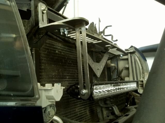

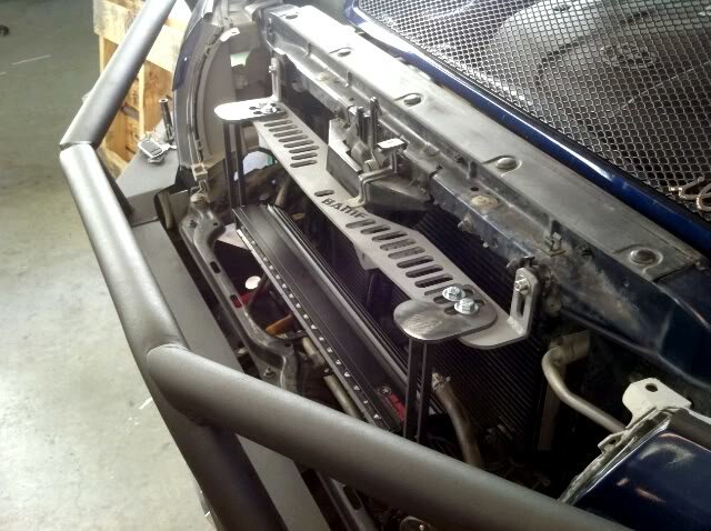

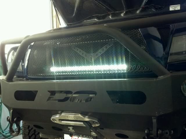

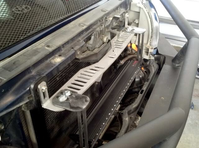

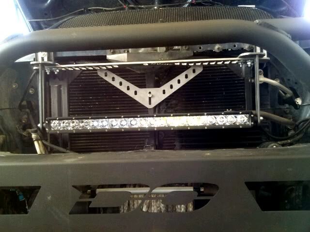

    We fabbed up a bracket to mount a 20" LED light bar today you could put 3 20" bars if you wanted to on this thing :eek:
  18. Jun 26, 2012 at 8:39 PM
    #278
    ian408
    ian408 Well-Known Member
    Nov 8, 2009
    #25619
    19,685
    Ian
    Santa Clara, CA
    09 Tacoma
    Damn! That's gonna be bright with three bars in it :D
