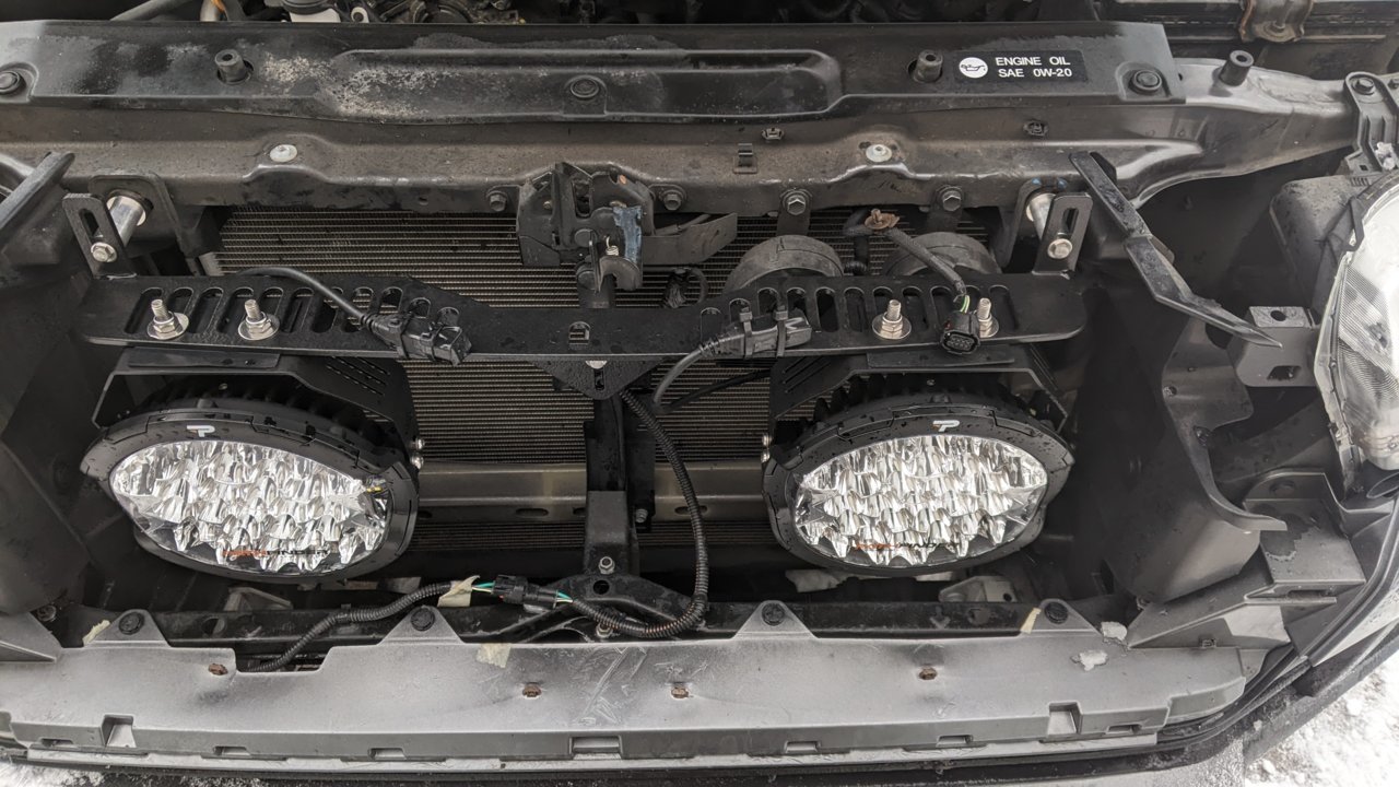

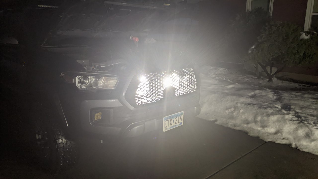

    Rough installed my new grill, BAMF light mount, and 9" prowlr lights.
    As it sits the lights are about 5 inches away from the grill. So I think I'm going to buy some spacers to push the mount closer to the grill and free up some space so the horns aren't right next to the radiator.
    More pictures to come.

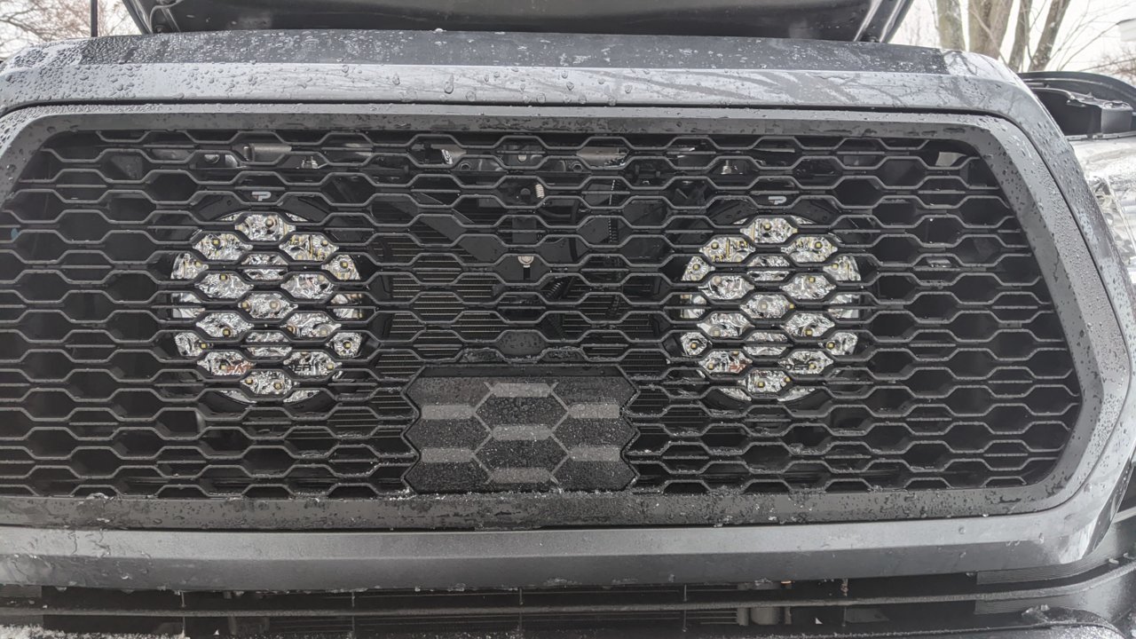

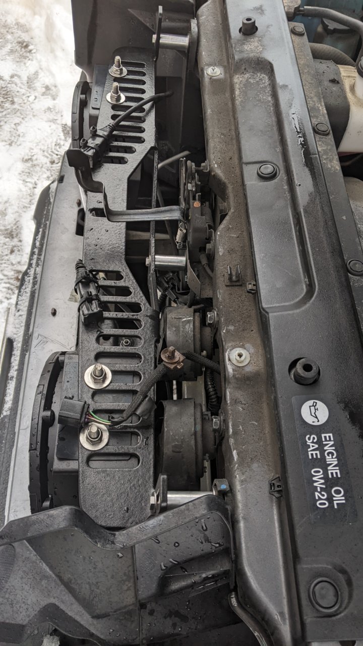

    Got my spacers installed on my BAMF behind the grill light mount.
    With the spacers the horns can stay mounted in the factory position, before they have to be flipped around and be pressed against the radiator.

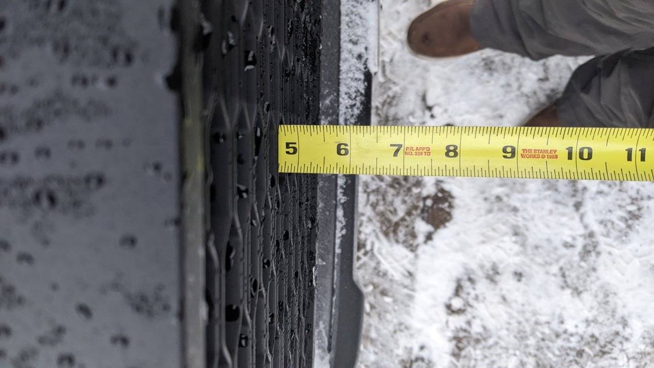

    As you can see in one of my pictures the lights are still over 4" inches away from the inside of the grill.
    My one main concern is pushing all the weight of the metal bracket and lights 1.5" further out will put extra strain on the mounting points.
    I will definitely monitor the bolts regularly to make sure nothing breaks.
    To do this I used:
    3 - 1.5" long aluminum spacers with 3/4" O.D. and 5/16" I.D.
    3 - 80mm long stainless steel m6 bolts, cut down to 75mm for the top 2 and 60mm for the bottom bolt
    2 - m6 stainless steel fender washers to go between the spacers and radiator mounts.
    Reused all the washers and the 1 m6 locking nut that came with the light mount
    The lights haven't been wired in or aimed yet, that is a job for a much warmer day.

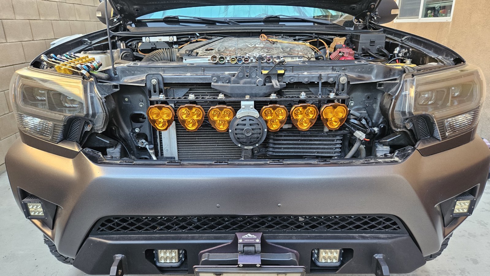

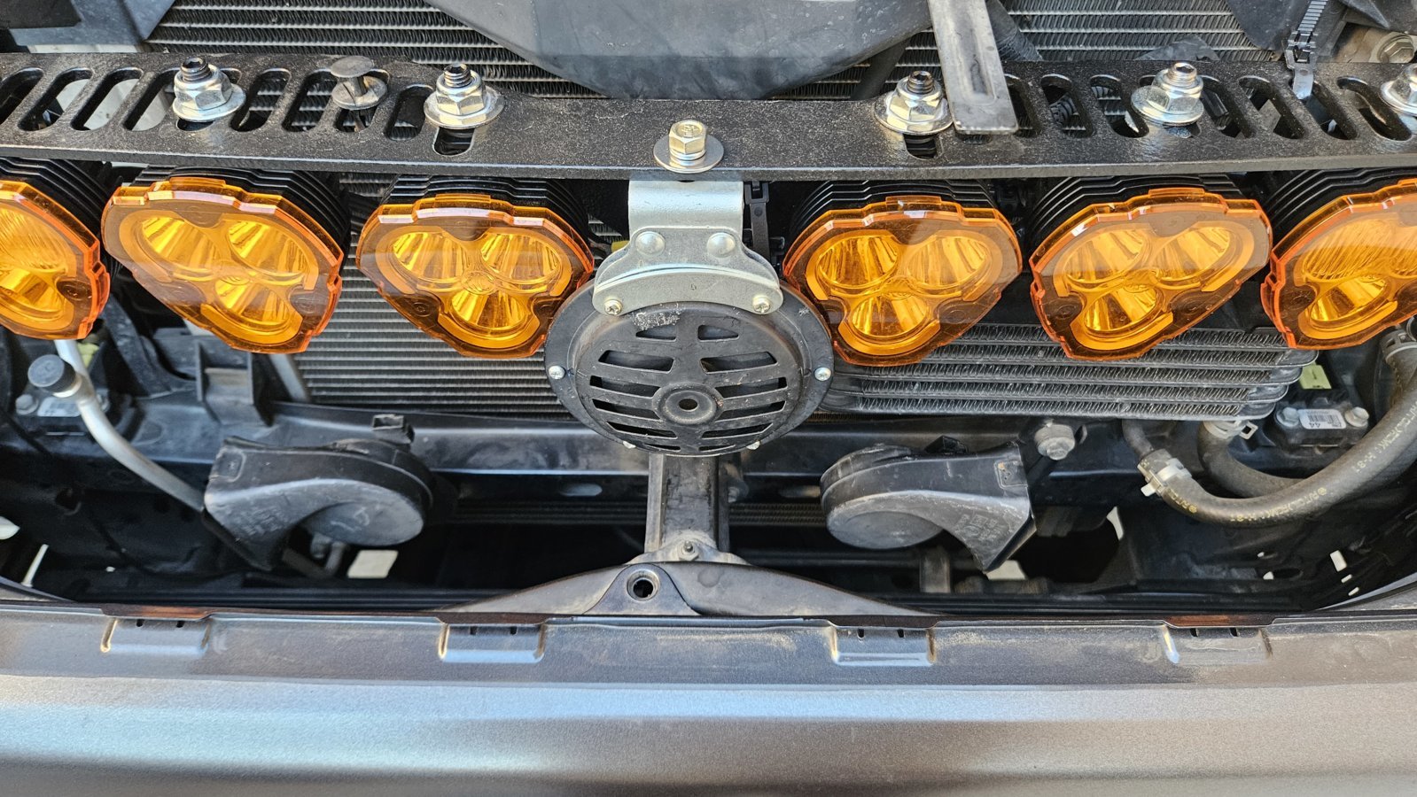

    I had to relocate my factory horns

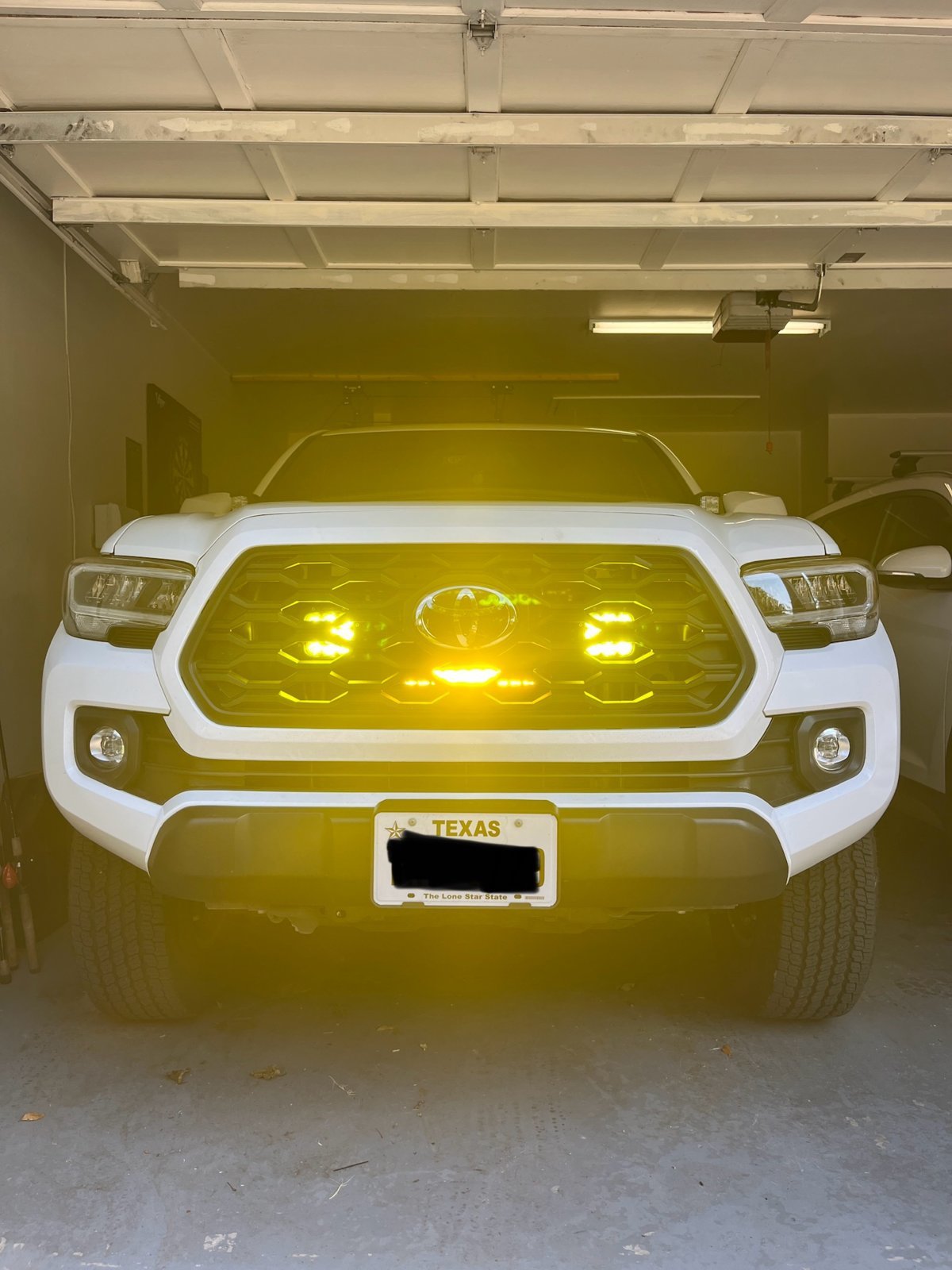

    Anyone running this with a stock gen 3 trd OR grill? And if so, does the grill impede light a substantial amount? Photo of the grill I’m talking about attached.

    Where’d you relocate the horns to?

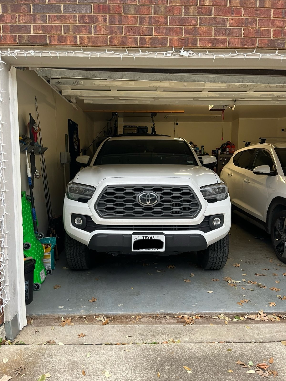

    Look at my first pic. I movedd the OEM horns below the lights and I have an aftermarket horn at the center where the Toyota grill emblem would be

    What grill do you have? Really like it.

    Here is the grill I have, you also need a different grill emblem for it. I got it on ebay for $25, part #53141-71010
    My TSS works about 90% of the time, I don't know if it's the new emblem or because I lifted the truck because I did both at the same time. But other than the TSS not working occasionally I really like it.

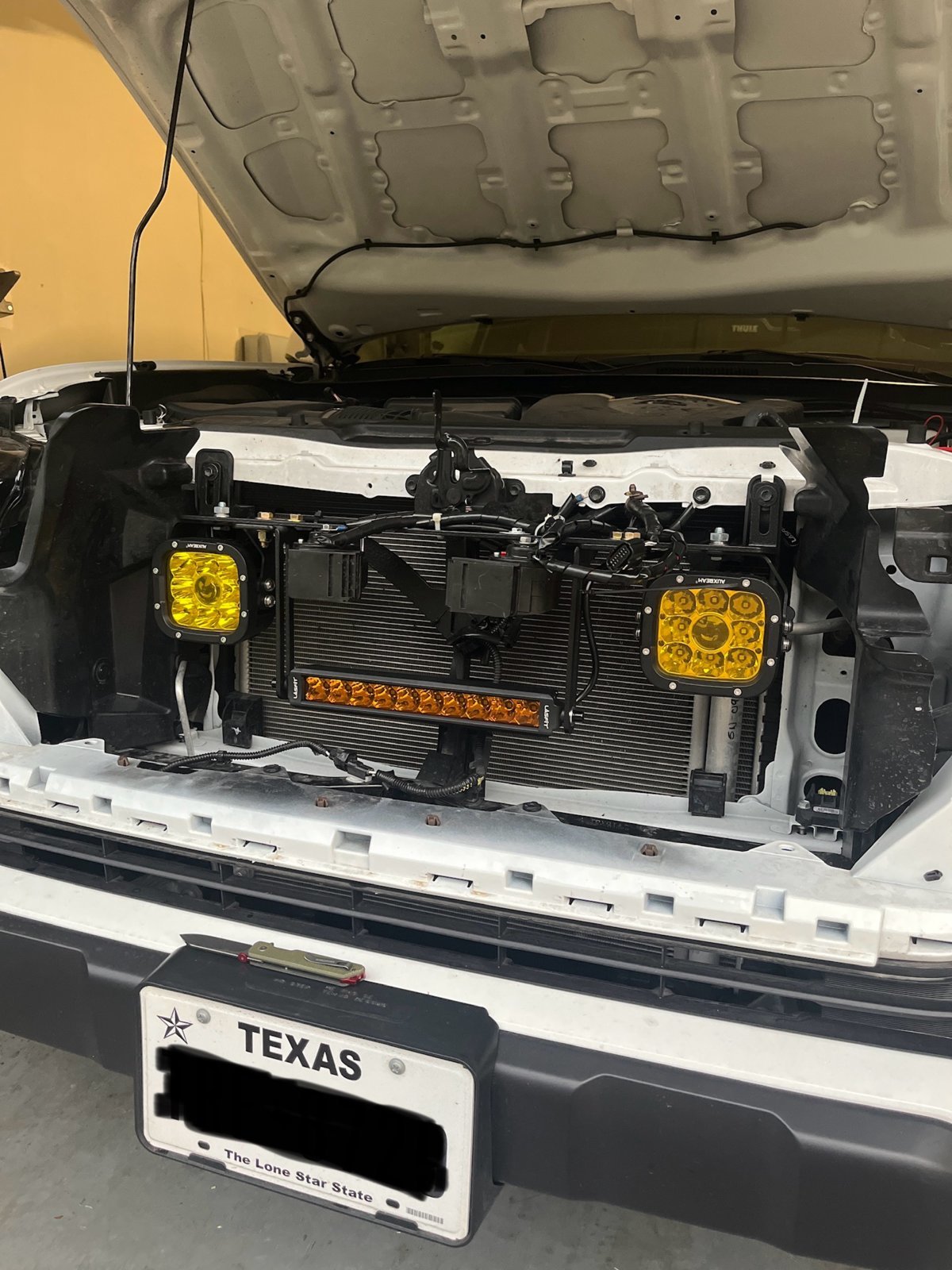

    Installed my BAMF bracket this week. Relocated the horns the bracket. Just spliced in some extra wire for power and ground on the horns. Think it turned out pretty good.
