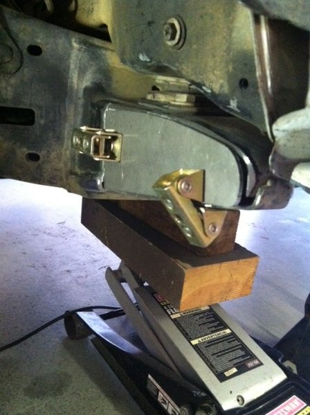

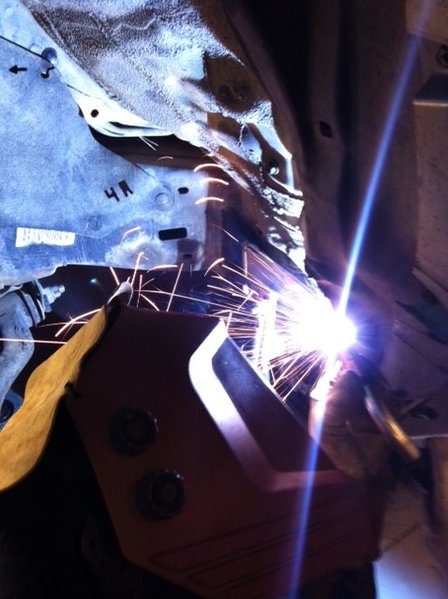

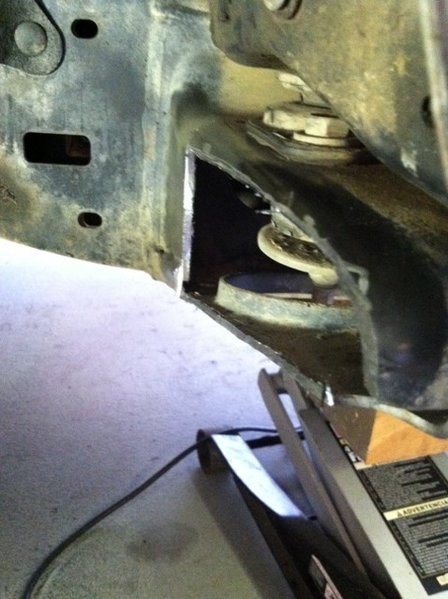

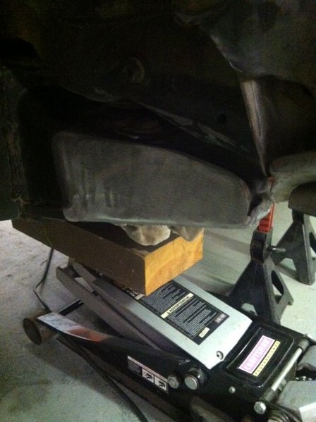

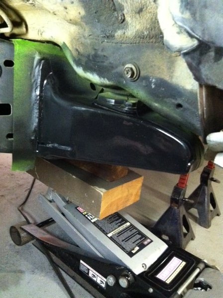

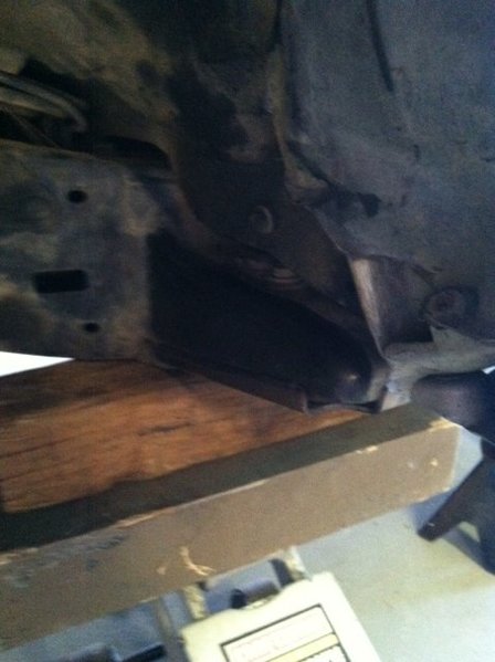

    I finally got around to getting this done.
    1) Clean up the Cab Mount
    2) Outline the area to be cut and start cutting
    3) Carefully cut the mount off
    4) Once the piece is off... Grind it down to even the cut & get desired angle
    5) Mount up BAMF CMC Plate in place
    6) a.Tack Weld the CMC Plate in place. b.We stuffed a Very damp & cold rag in the underside hole where the Cab Mount is located to minimize the risk of the the mount melting or catching fire. c. Start welding the CMC Plate onto the frame in increments.
    7) a.Grind & Smooth out the welds for smooth finish. b.Sand area to further smooth out
    8) Tape off, Prime & Paint
    Thanks for the CMC Plates Jerry!
