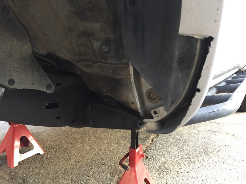

    You cut back as far as you can you can cut off about .250" past the bend. If you look in the OP there is a picture of how far under you can cut.

    Finally got mine done today. Ever since I got the Icon UCAs (Dec 2015) I started to rub when reversing and turning hard. No more rubbing now. :D
