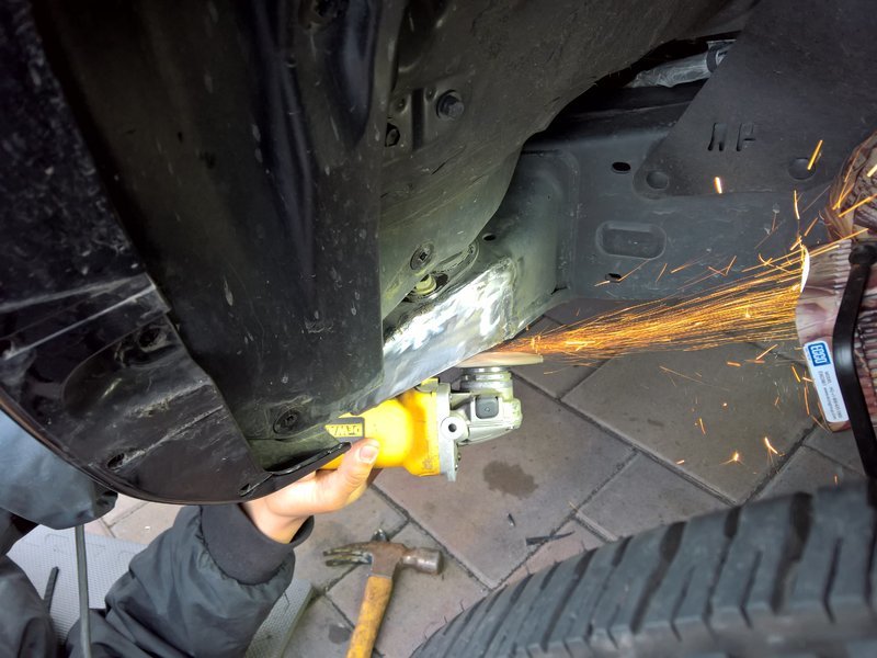

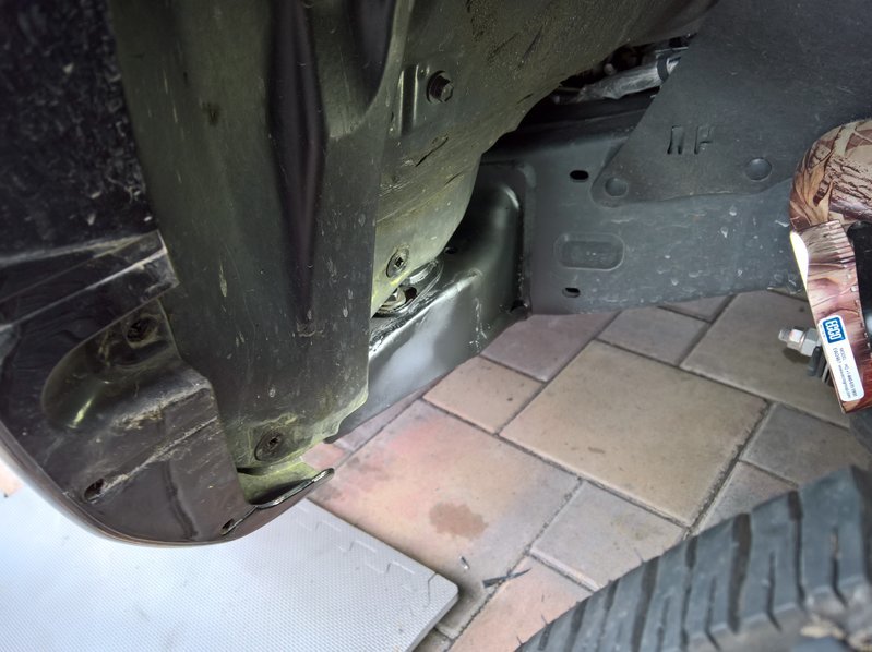

  12. Feb 18, 2017 at 5:05 PM
    #332
    DJFRENZY
    DJFRENZY Well-Known Member
    Oct 5, 2014
    #139727
    120
    Bay Area, CA
    Post Weld Smoothing Out The Rough
    Paint
    Thanks to my homie E for the install.
