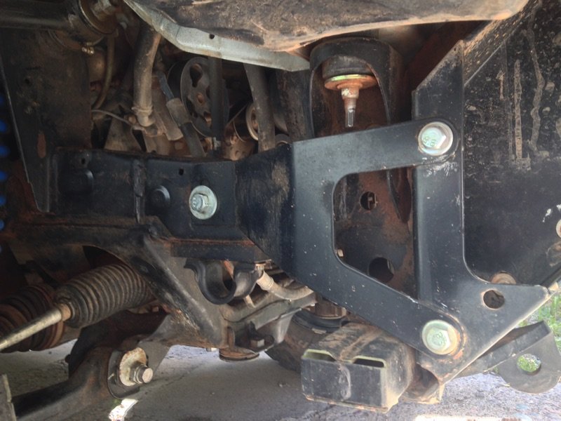

    I have the Relentless Fab Lower Stingray Winch Mount Bumper and this is how a bracket from the bumper to the frame looks. Should I be okay or need to add these as well?

    You should be fine with what you have Rick, thus is just a different type of bracket but does the same thing. When you put on the Kings, upgrading to these would be better due to the aspect of the reservoir mounting but you should still be ok with what you have.

    Relentless appears to have mimicked ARB reinforcement.

    A lot of bumper companies have tie in's back to that point. I can think of a few off the top of my head. Only a couple ways to skin a cat.

    Didn't mean to imply otherwise. If you're going to use anything as inspiration you can do worse than ARB, who has the benefit of full blown FMEA and testing. They call those "tension brackets" and they are pretty obviously to prevent the frame racking or distorting during pulls.
    ETA: Point being the BAMF (and others) reinforcement is IMO money well spent.

    This ^ you should be good for winching but if you add KINGs with resi's you will want to change that mount.

    Yeah people drilled holes in the reservoir mounts to accommodate the bolt for the Stingray Bumper
