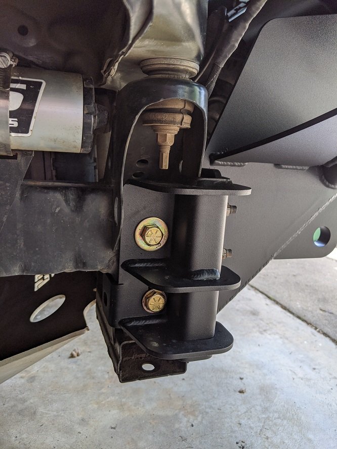

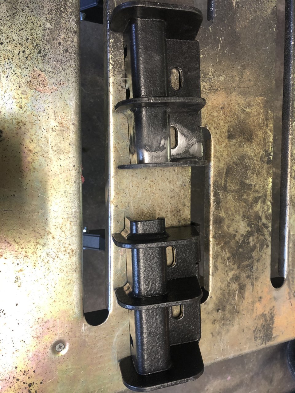

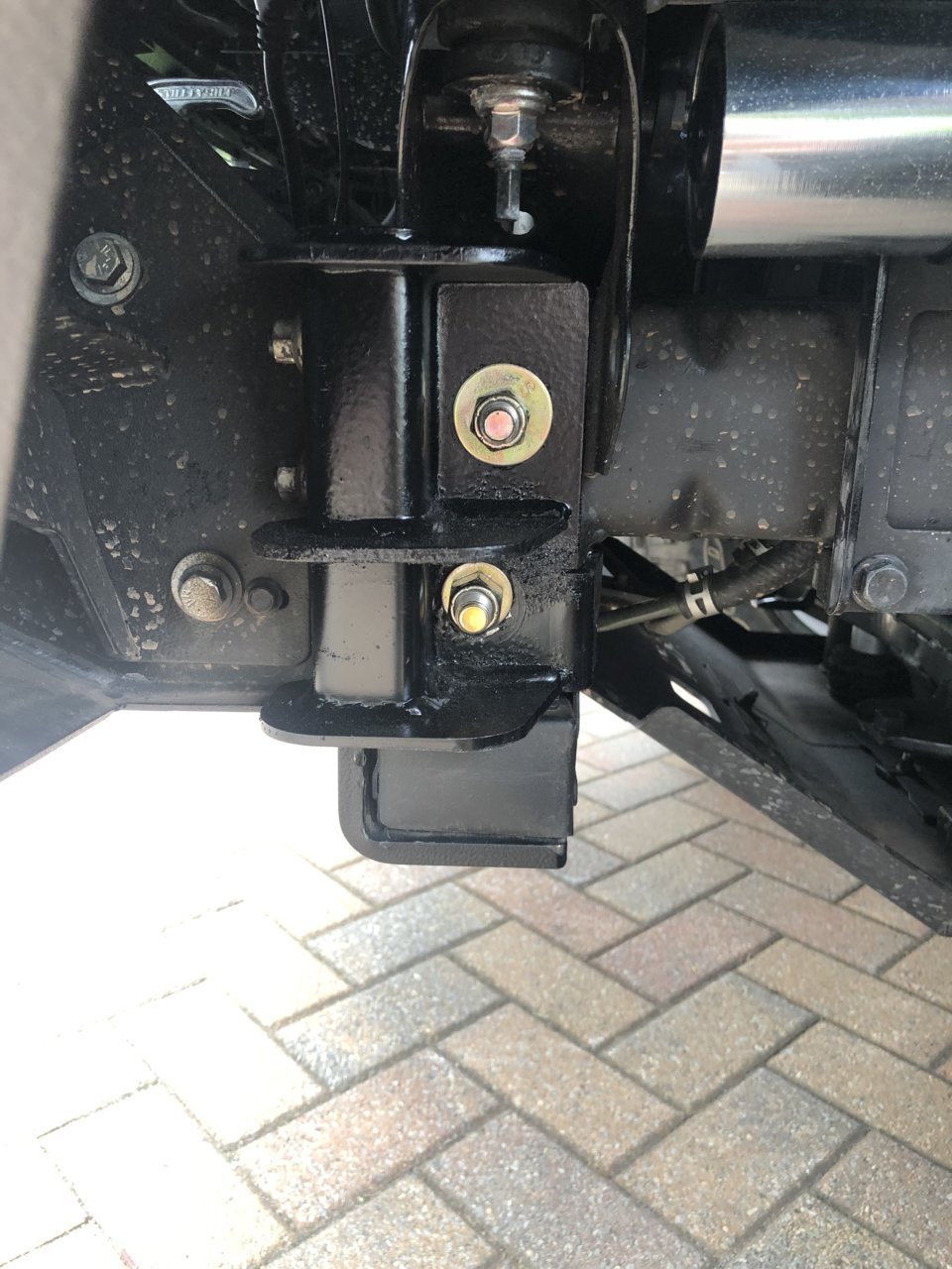

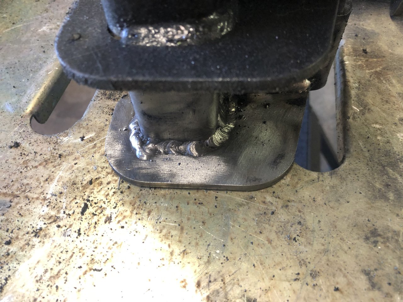

    Shame on me for not researching to see if reinforcements would work with SSO Slimline but I was determined to make them work. I first had to grind of the lower lip of each reinforcement. Then I rewelded the top half of lower fin. I was able to get 2 good revolutions on front OEM nuts by hand so I felt secure to torque them down. No problems
    Pic below of 1 bracket that was grinded down.
    88BE2401-AE3F-42F1-B8BA-6748B49A0219.jpg Pic below is of where I rewelded
    And finally of pic installed
