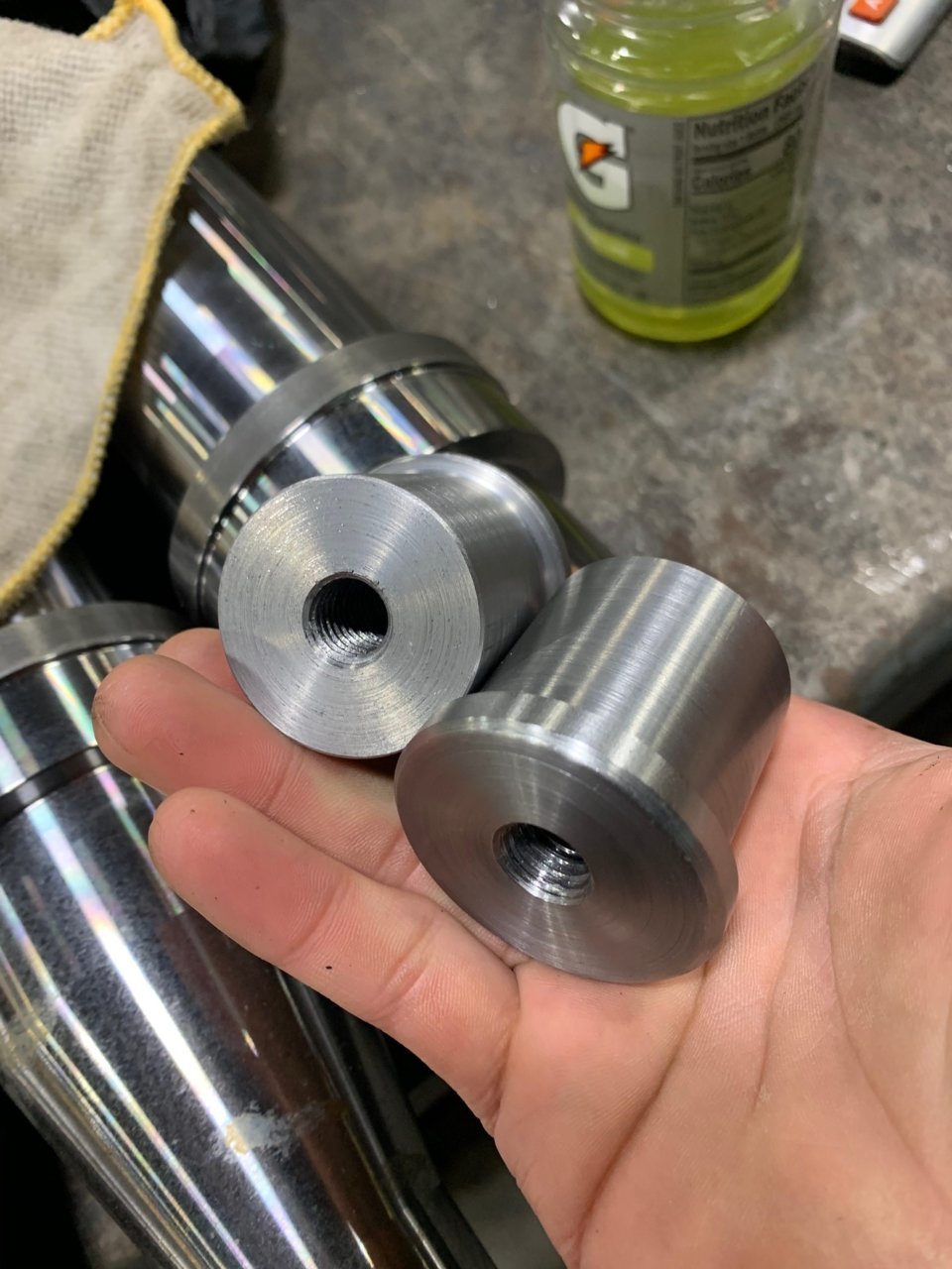

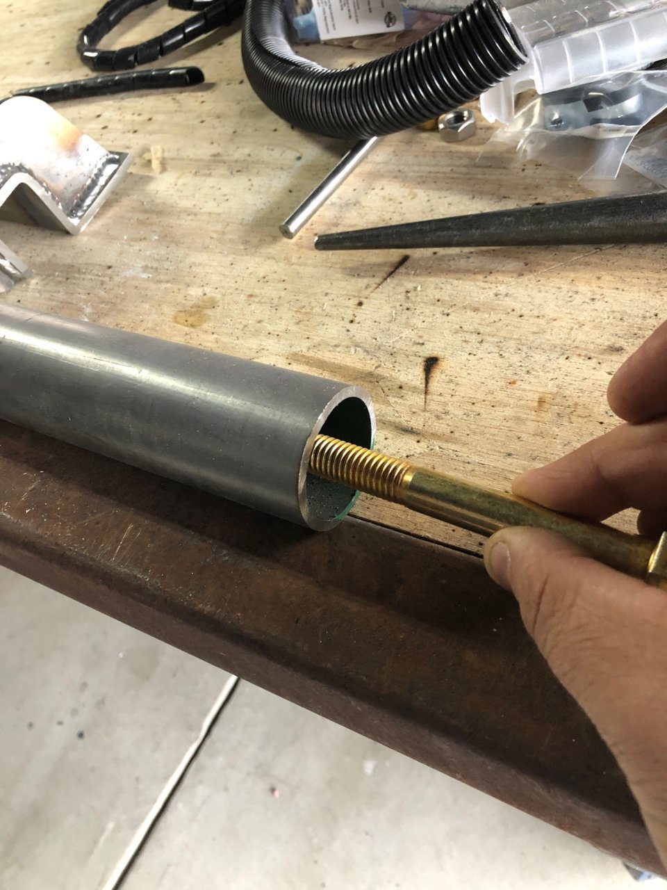

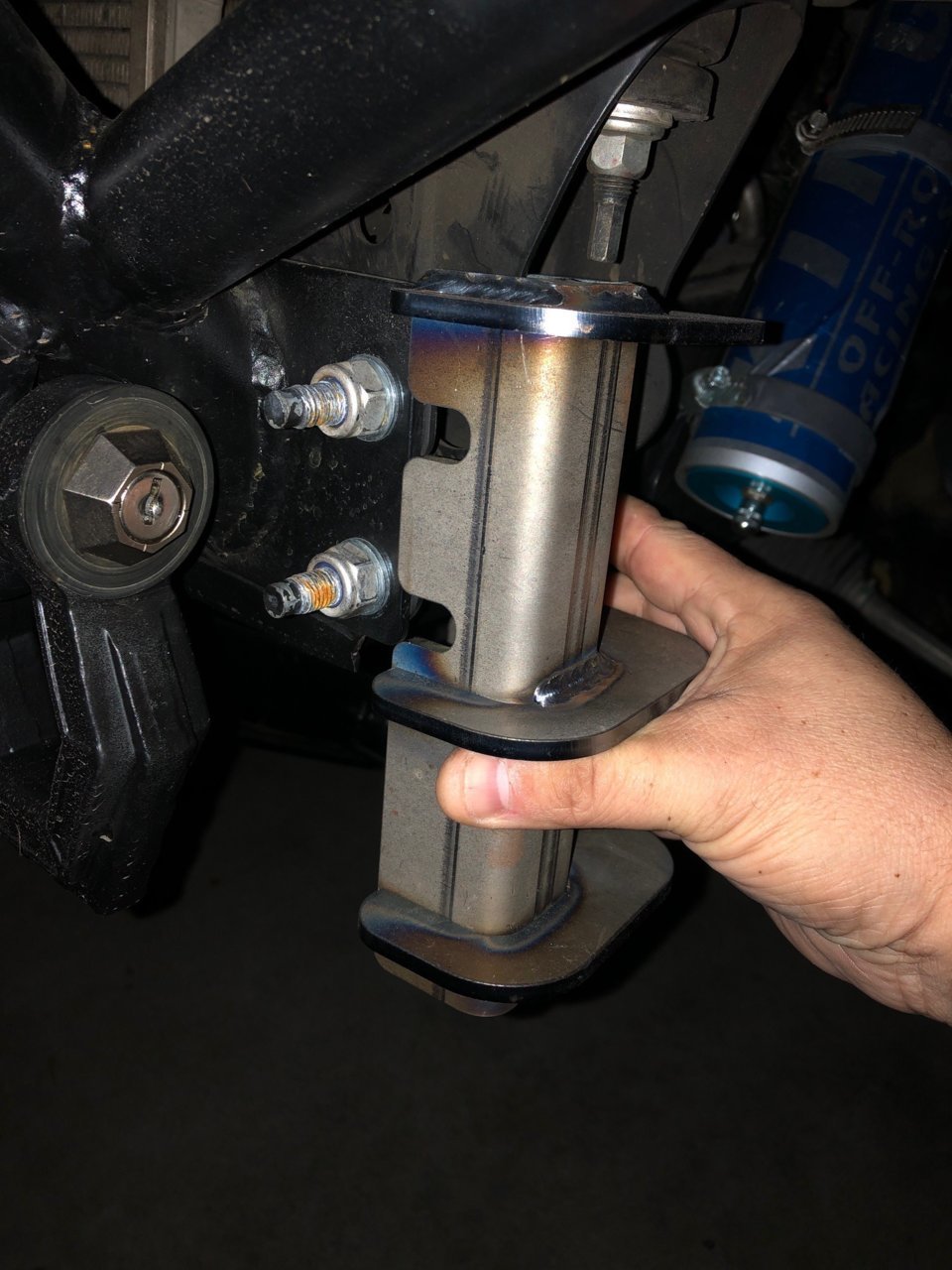

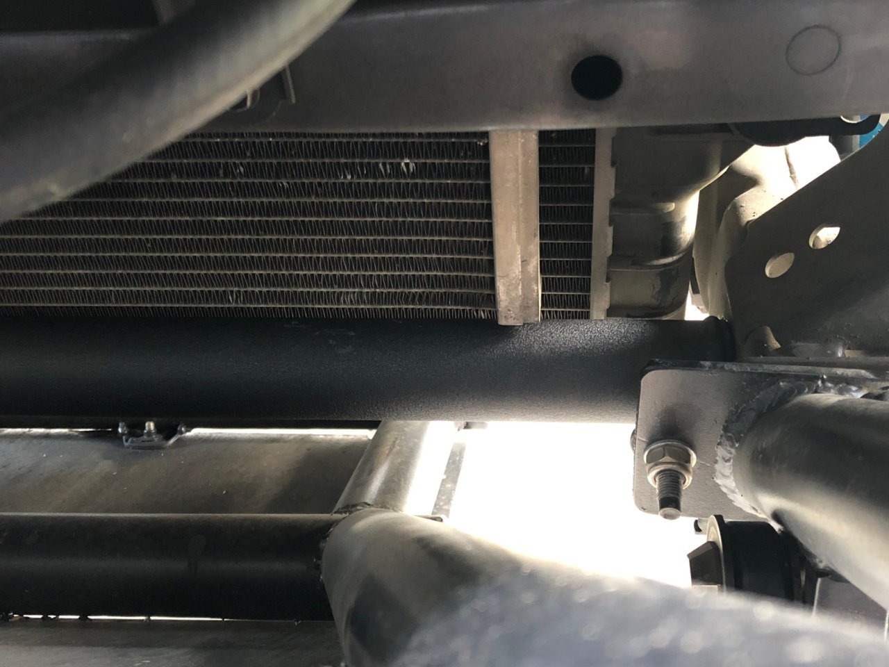

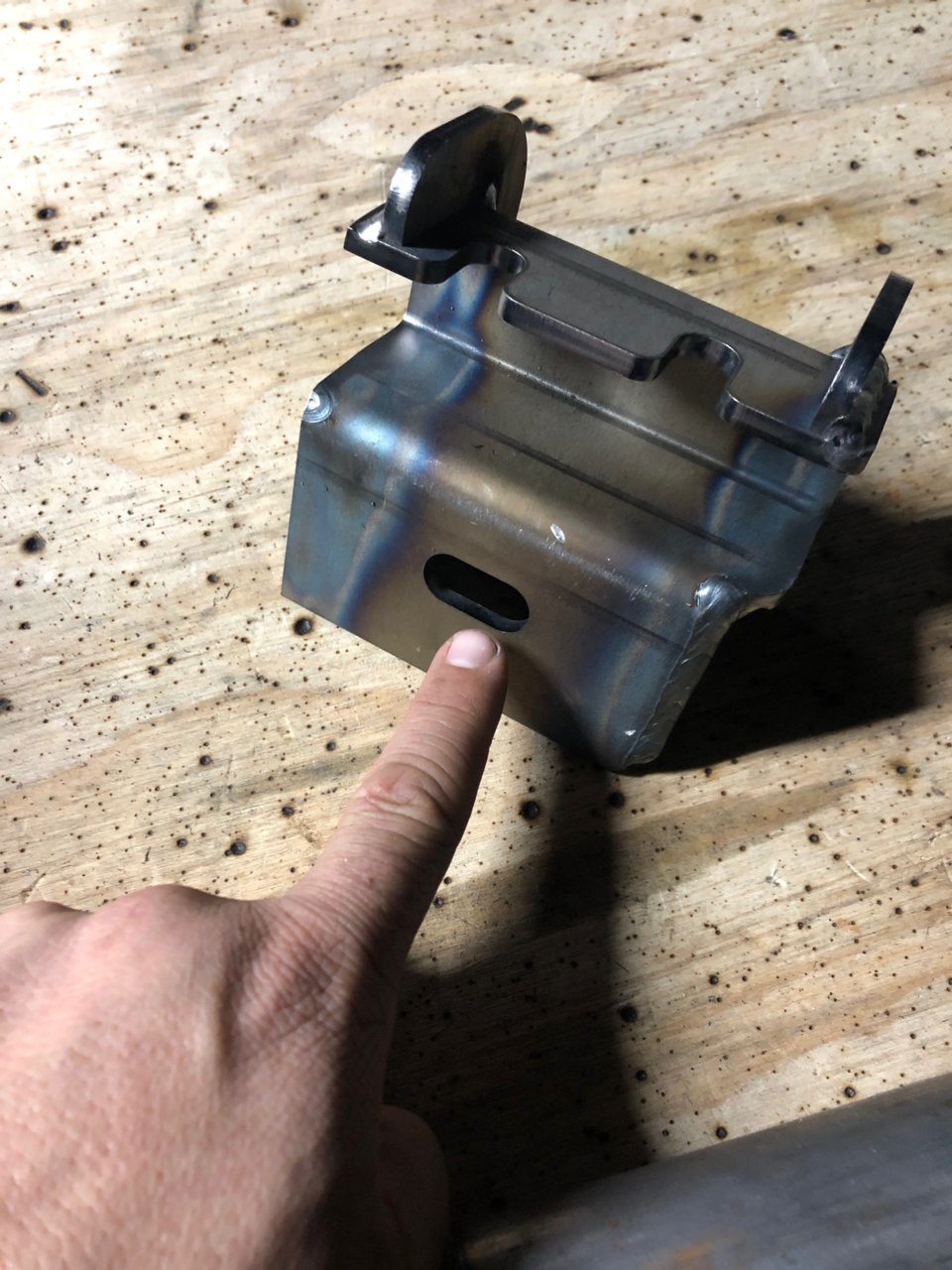

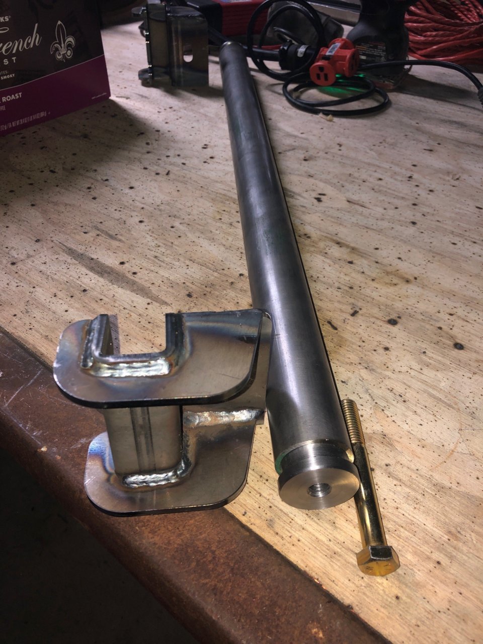

    I finally completed this install of my modified BAMF bumper reinforcements to strengthen up my recovery points on my Prerunner tube bumper.
    Since I cut off my factory crossbar to get my bumper as high clearance as I can, I chopped these in half. Additionally, I was thinking since these bolt to the frame, how cool would it be to have a support bar connecting them acting as a new crossbar? I was thinking of welding a 2" piece of DOM tubing right where the bolts would go.

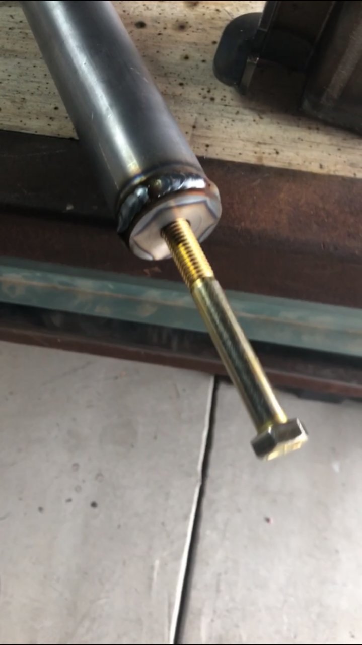

    So I had some threaded bungs made, measured and cut a piece of tube for the new crossbar, then welded everything up
    Here is everything powder coated and installed.
    Overall, I'm extremely satisfied with the end result. Extra support for the frame, and removable if I ever needed to make changes.

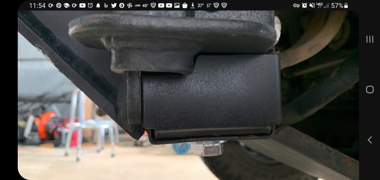

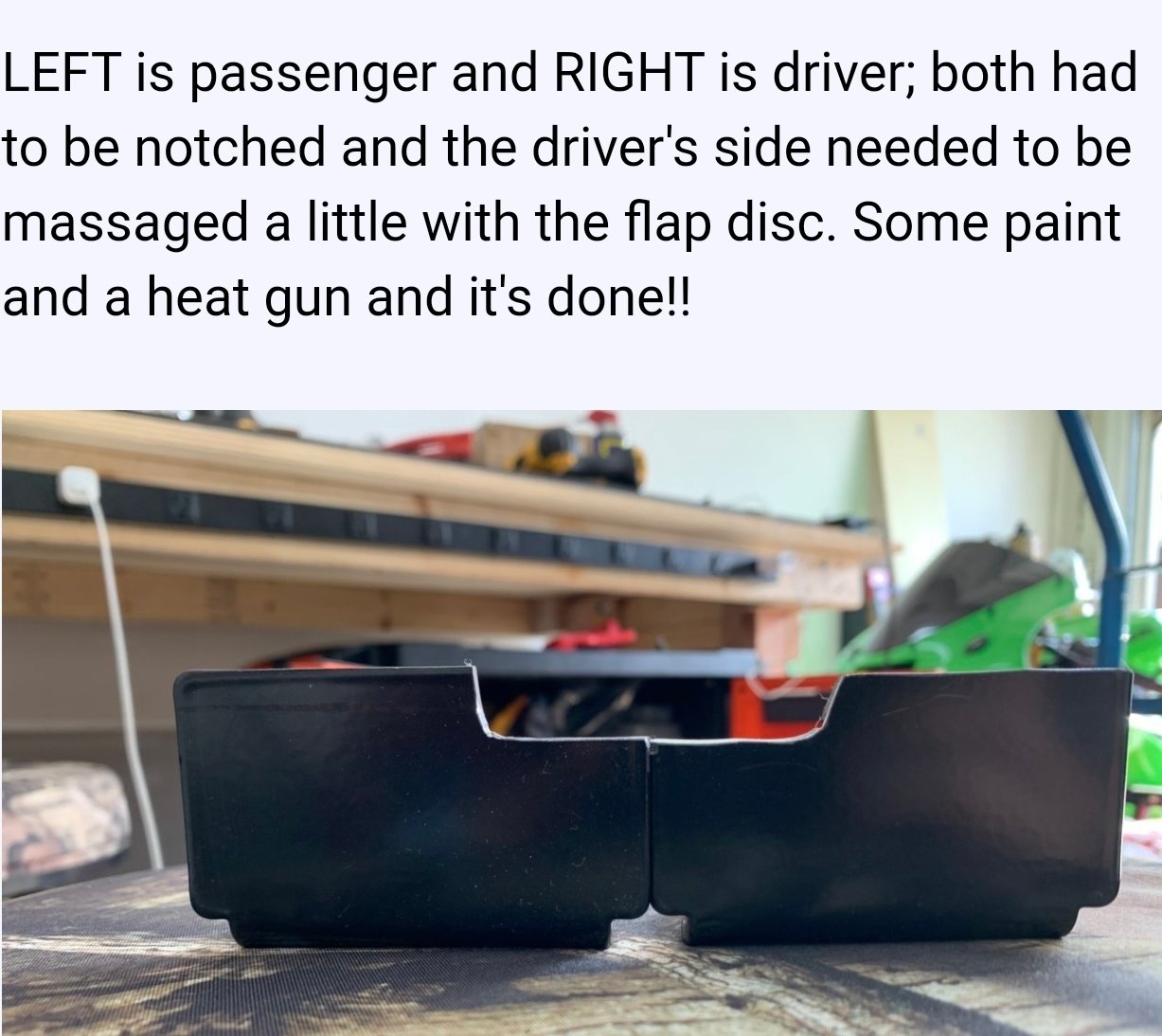

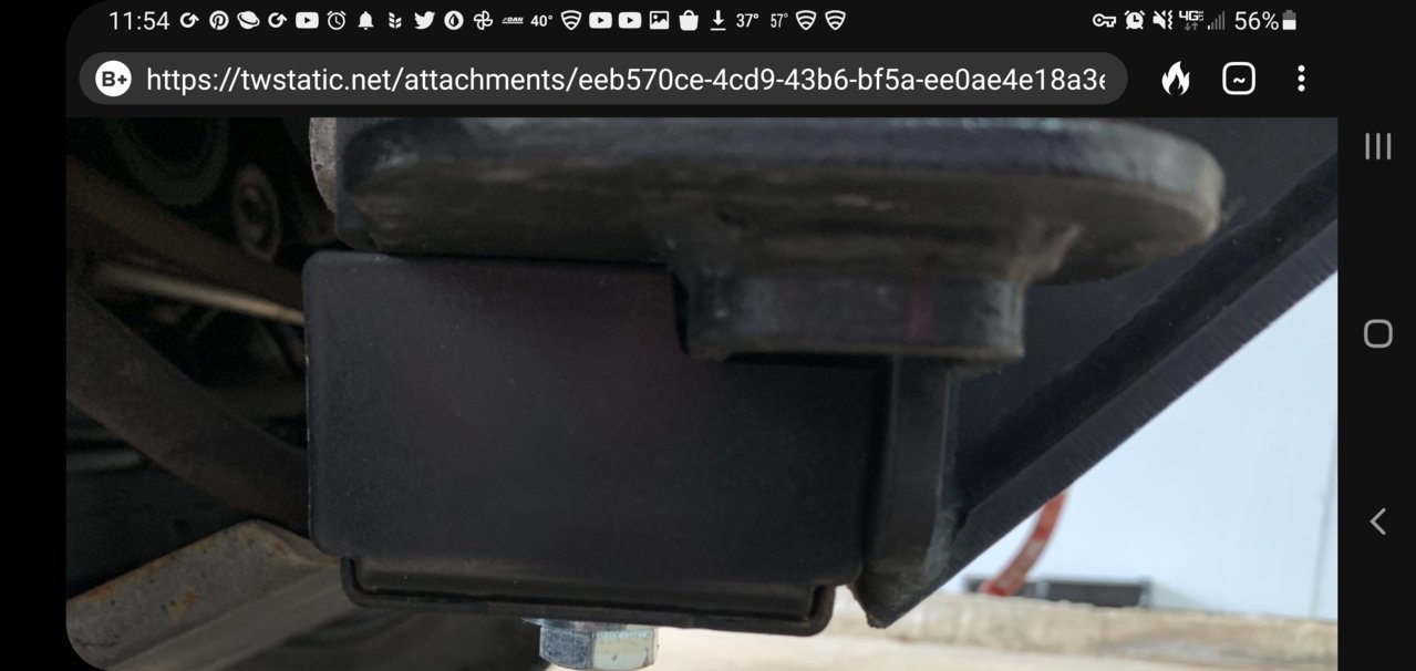

    Did a preemptive #randyfab (@EatSleepTacos) lengthening of the horn bolts, I have to modify the frame end caps to work with the FBRB and then drop them off for powder coating (ordered bare in case I needed to mod the bottom "leg" part since the slimline uses that underside bolt/retained nut.
    Going to try to mod the end caps this week and get these brackets coated and installed thereafter. Thanks @JLee glad I don't have to hack the coilover resi brackets!

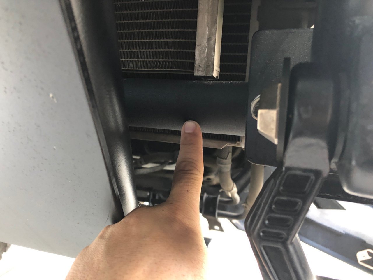

    This is awesome, really wanted to do this, but I have two hard cooler lines in front of the bolt on the passenger side.

    Will do, neighbor tossed the brackets into the powder coat oven late this past weekend, just waiting for him to call me over to put the wheel of death to the square one frame caps.
    I know @geekhouse23 did this and posted them on the square one design frame cap thread...but here's what I "stole" for "learning curve"
    Screenshot_20210316-120029_DuckDuckGo.jpg Screenshot_20210316-115407_DuckDuckGo.jpg Screenshot_20210316-115447_DuckDuckGo.jpg
