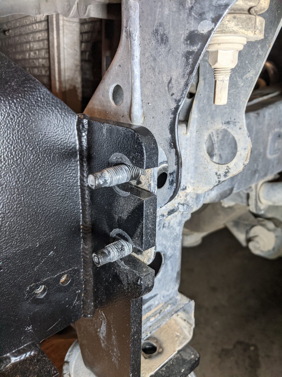

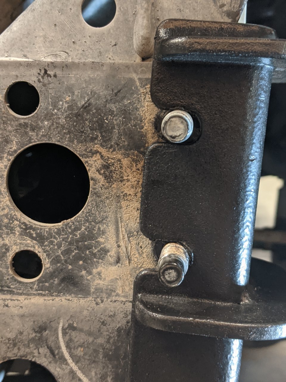

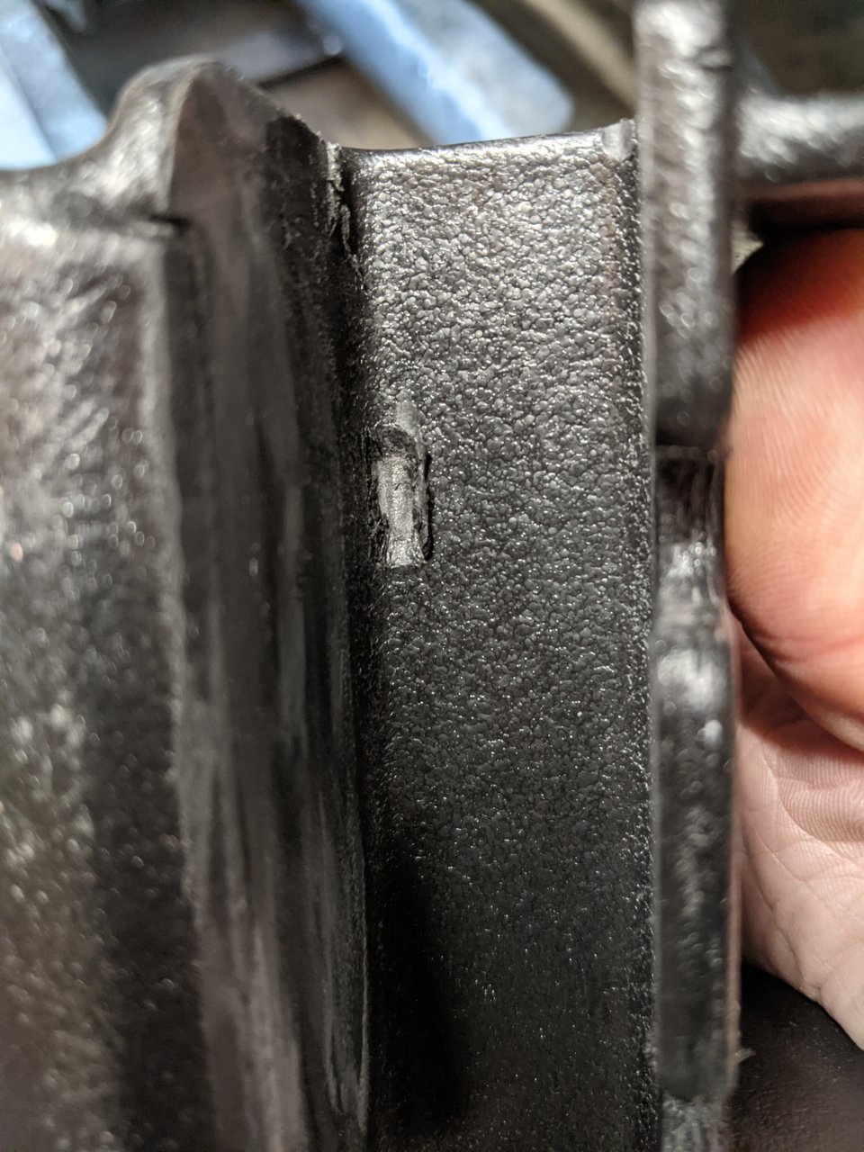

    Trying to install these and hitting an issue. The front side of the body mount horn interferes hard with the inside of the bracket. Are you guys just removing part of the factory cab mount in order to get these to fit? You can see where the cab mount is bent over in one pic, and where it digs into the bracket.
    Edit: for those that like numbers, the clearance for cab mount designed into the reinforcement bracket is 1 and 5/8th inch. The cab mount is just over 1 and 3/4" tall. So there's 1/8 to 3/16" of interference in this area. Is everyone just stacking washers here?

    The winch plate you have is too thick. you will not be able to use the brackets without modification.

    None yet
    While I agree, that doesn't really answer the question. Even if I remove the winch plate entirely, the cab mount horn will interfere with the reinforcement bracket before it sits flush with the side of the frame. Moving the bracket rearward doesn't alleviate the left/right interference caused by the bracket not being tall enough to fit around the cab mount.
    Also, please add the SSO slimline to the list of bumpers that this doesn't fit without major modification.

    Its the thickness of the winch plate causing that if you shave the face of that plate to .250" everything will clear as intended.

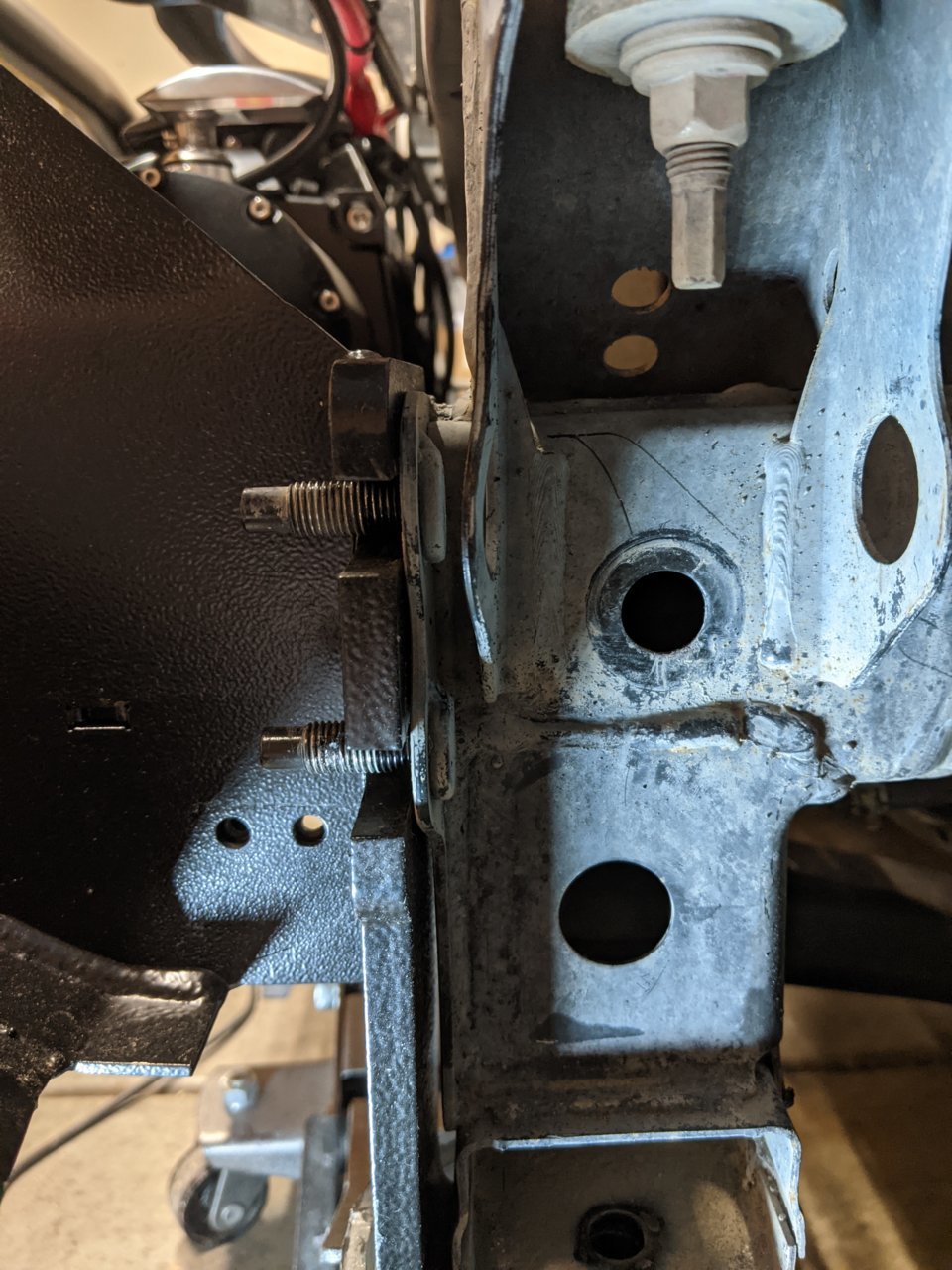

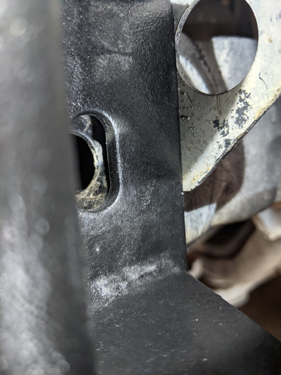

    Took the bumper off, bracket still doesn't fit. You can see from the front picture that the bracket is sitting at a slight angle with the top being held out by the cab mount on the inside of the c channel. The second pic shows the gap between the bracket and frame rail side. When measured from the face of the reinforcement bracket through the slot to the frame, the distance is .48". Your bracket is ~.21" thick with the coating, meaning there's a gap between the bracket and frame of about 0.27". The holes lines up enough now that I could get the bolts through and crank on them to suck up the gap, but it's just going to bend the cab mount in order to close that gap. There isn't enough height in the C channel to clear the cab mount and allow the bracket to sit flush with the frame.

    Then you have an anomaly in your frame You can email more pictures if you like. But the brackets do clear that mount on all other trucks they have been installed on they are all made the same these brackets can't be made out of spec they won't fit in the jig we use and the gussets would be way of our place so something is going on out of the norm.

    Not sure what you did here but I ran into the same thing this weekend when I went to install a BAMF bumper and these bracket. I ended up just grinding down the part of the frame that was interfering which wasn't much and the mount now lines up... I know this is a 5 month later response but figured I'd let you know you aren't the only one to run into this.
