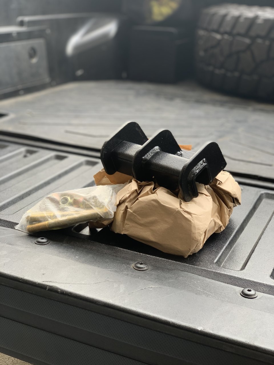

    cool stickers and a baseball card With clothes pin, sounds awesome ! wicked

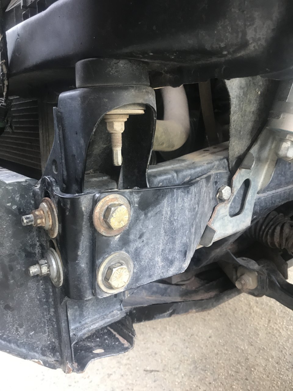

    @JLee
    I got an early start to the weekend, found a few minor fitment issues specific to the US Offroad winch mount (05-11 variant):
    First - the [winch mount] mounting flanges are about ~1/8" wider than the BAMF reinforcement brackets would like:
    Second - with the way the US Offroad winch mount is designed/built, there's zero chance of being able to use the 3rd/lowest BAMF bracket bolt. Not without hole-sawing or cutting into the US Offroad mount, even then not 100% sure it wouldn't be right where they have a gusset (not without removing it to look more thoroughly). No pic for this, no good way to get one! Couldn't even get my borescope in there...
    Third - again this is a US Offroad design issue, not a BAMF bracket issue; but the BAMF brackets require removal or modification to the frame horn extension for mounting. The US Offroad winch mount utilizes them for mounting/reinforcing the mount (so modification would be required to some degree, even if just a bolt 'n nut):
    Still, damn impressed with the build quality of these reinforcement brackets. Thanks again!

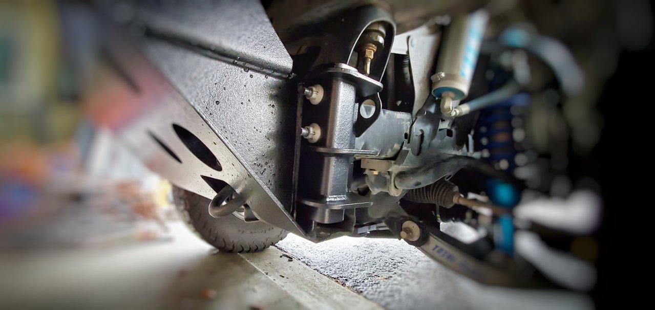

    Bad ass design Jerry. And we completely agree, don’t pull from a bumper that is only secured to the stock frame plates. Here is how ours attaches. The side straps are included with the bumpers. Straps are made from 1/4” HRPO and supplied with grade 8, 1/2” hardware. Just wanted to make sure you saw our current design when you test fitted yours. Only a few of our very early bumpers went out where it was only secured with just the stock studs and nuts.

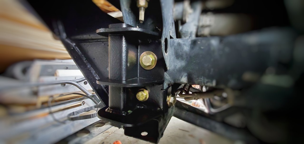

    I installed mine yesterday. Painting them took longer than installing, but the lower front-to-back bolt is currently not installed. The SOS front bumper's vertical support is welded directly in the spot where this bolt needs to punch through. I will be thinking of ways to resolve this, but i feel 90% more confident in a winching situation with the 4 extra HD bolts and the BEEF brackets holding the bumper on now. Thanks again @JLee
