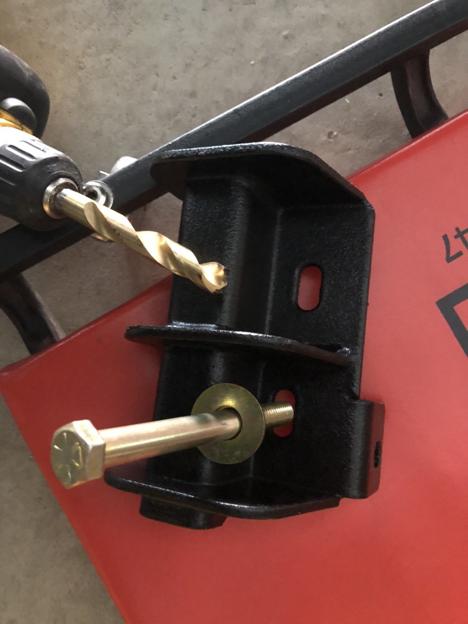

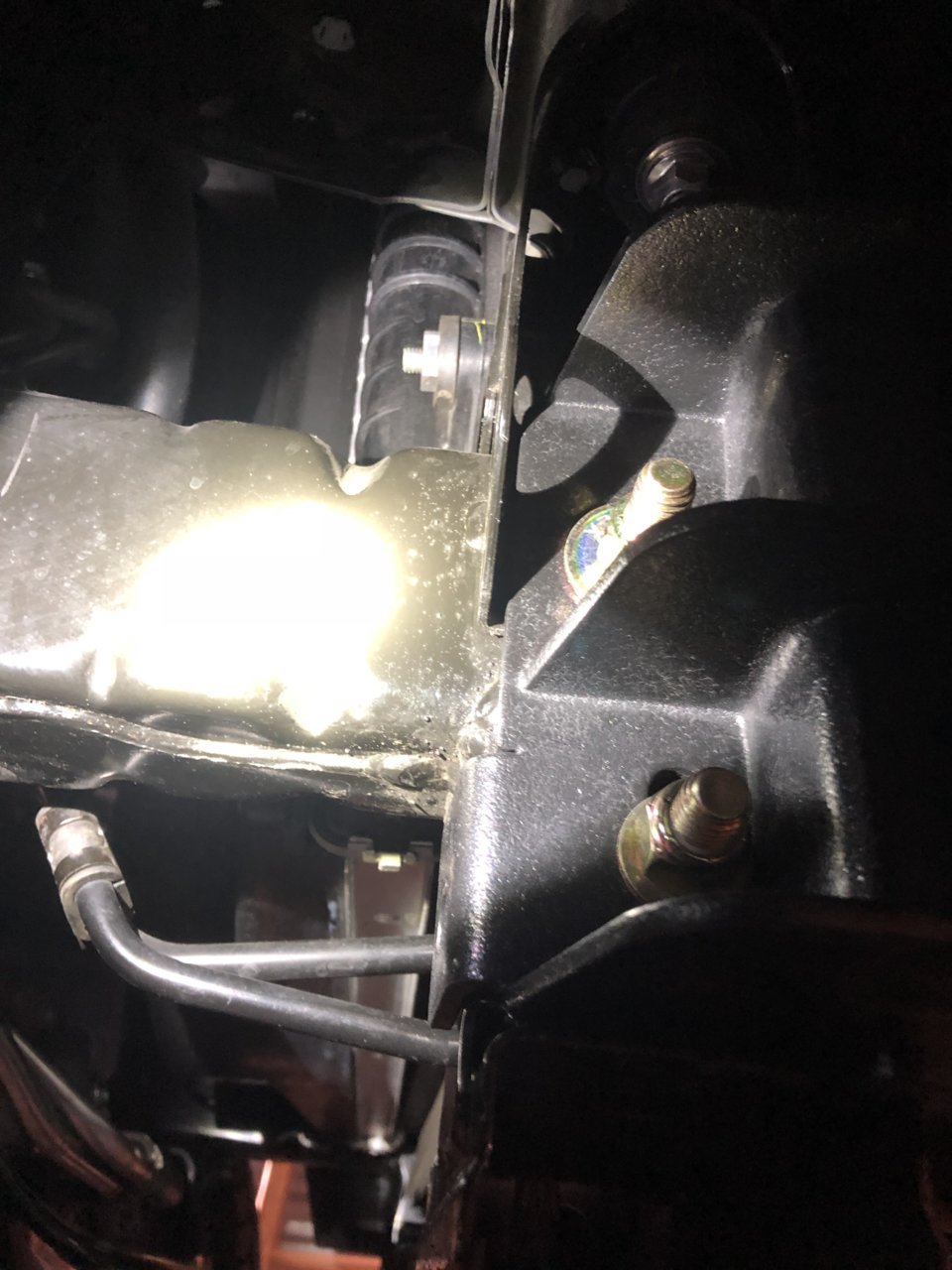

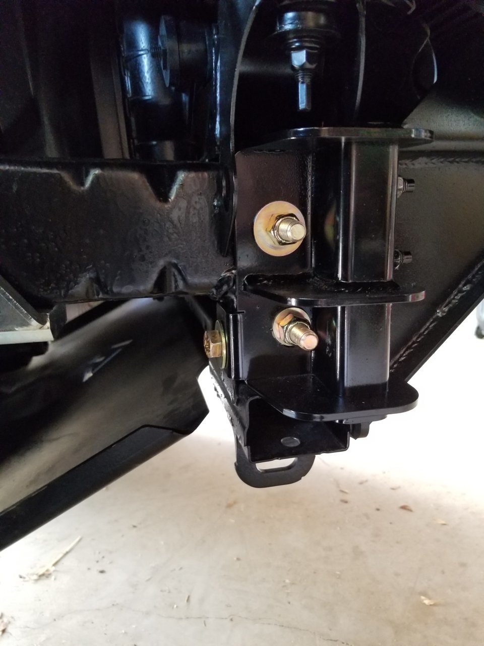

    Installed these today on a Warn hidden winch mount, all went well.
    Here’s a few things.
    Couldn’t use the lock washers on the OEM front bolts, not enough threads.
    Couldn’t use the most rear bolt since I didn’t want to drill through the front of my plate bumper mount (too hot and not enough drill bits, at least not today).
    Lastly, had to drill out a bit of the powder coat in the two holes of one of the brackets.
    These are definitely thicker steel than most anything on the truck!

    They fit, minus the rear bolt unless you want to drill through the Warn mount plate, see my post above.
