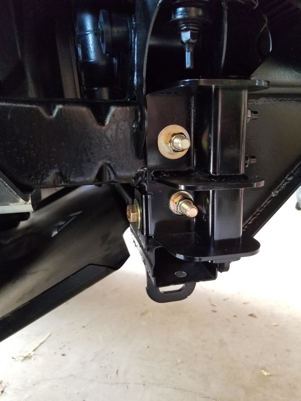

    Any photos of the bracket with the bumper?
  9. Aug 24, 2019 at 8:23 AM
    #149
    anthony250f
    anthony250f Well-Known Member
    Feb 18, 2012
    #73066
    16,783
    Anthony
    San Diego, CA
    2008 dcsb trd offroad 4wd
    Love these brackets! Thanks again50ADDB99-823E-4ED3-ACD5-4579BC8251A1.jpg B067A771-8F66-49A2-AA84-819D7D6EBD55.jpg
    JLee[OP] and Mully like this.

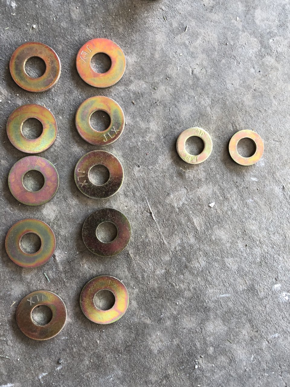

    I’m an idiot. Where do the 2 smaller washers go?
  11. Aug 26, 2019 at 5:02 PM
    #151
    anthony250f
    Feb 18, 2012
    #73066
    16,783
    Anthony
    San Diego, CA
    Lower side bolt

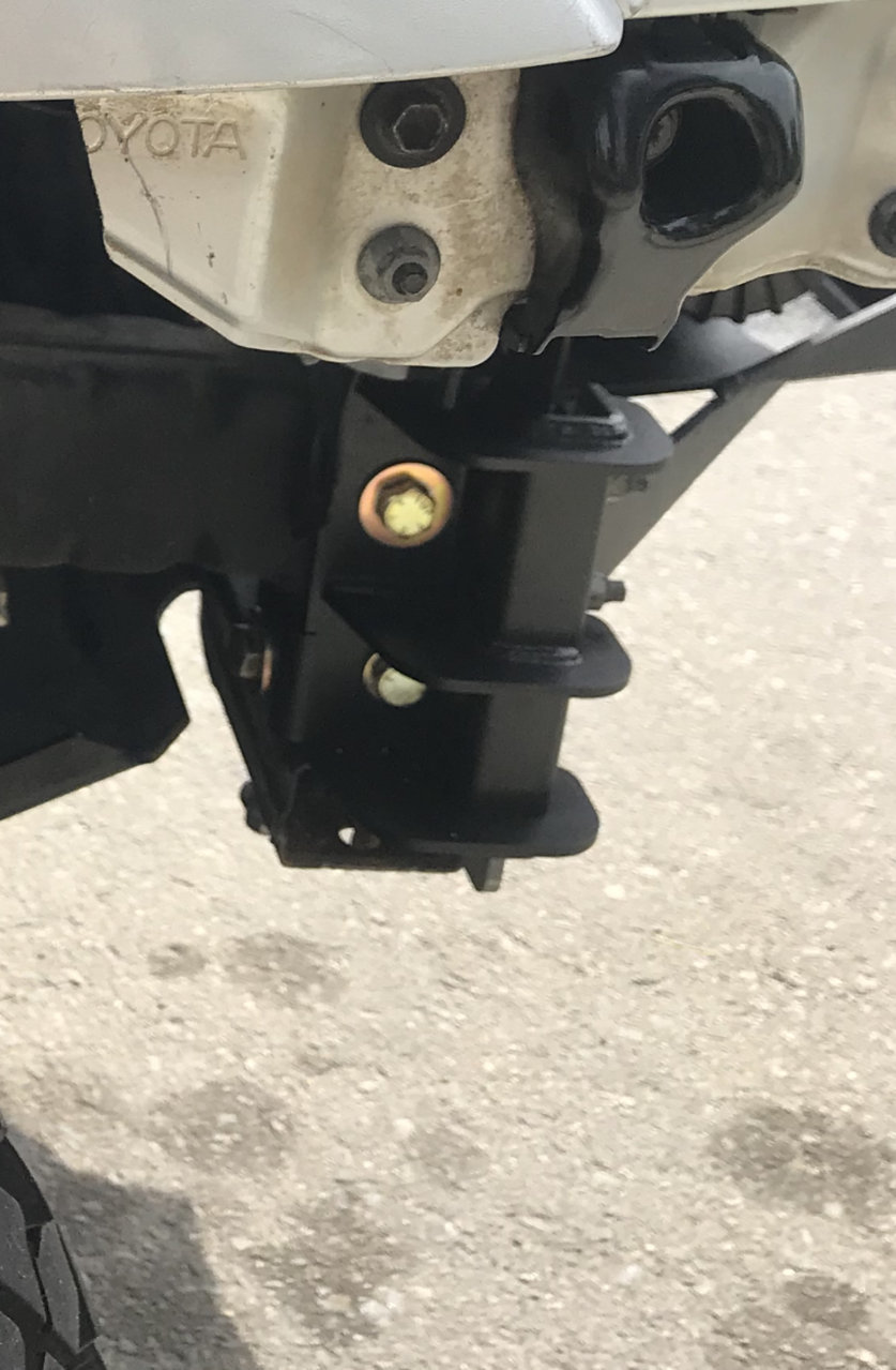

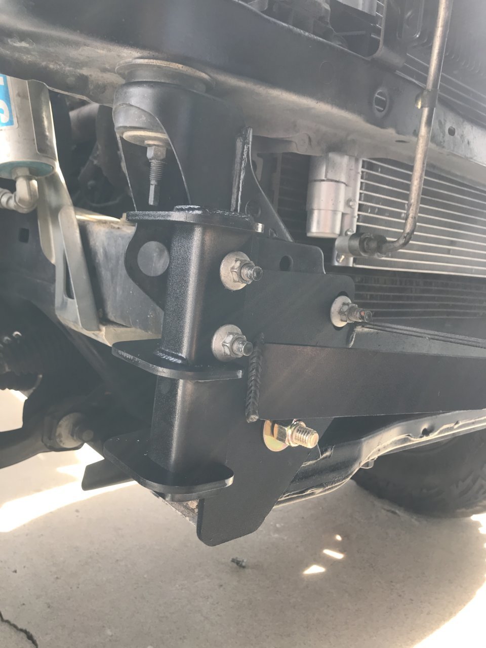

    I'm having a hell of a time getting the back bottom bolt in. Anyone have a good tip? I cant get hole to line up with the frame
  14. Sep 15, 2019 at 2:50 PM
    #154
    Mully
    Mully Well-Known Member
    Feb 12, 2014
    #122907
    5,273
    CA
    12 DC 4x4 Lifted Sport
    Lifted, Kings, Locked, 295s and more.
    Drill it slightly larger, or a BFH. I had to reverse the bolts. Good luck
