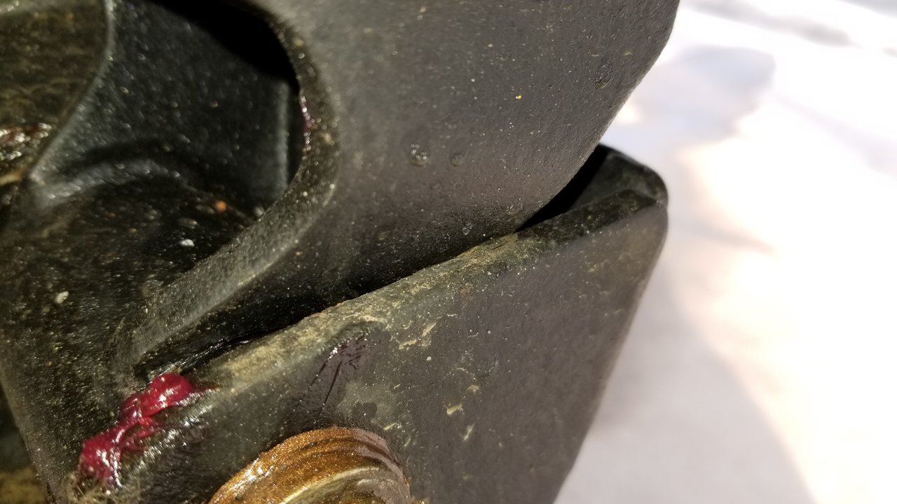

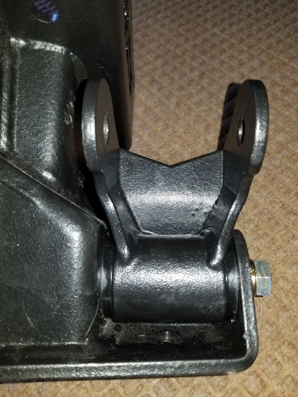

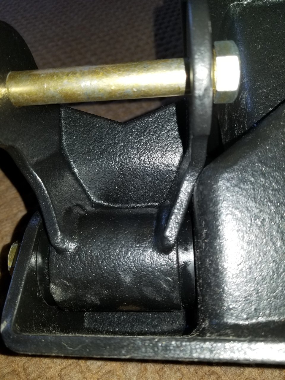

    @JLee 2 questions for you, all my hardware appears to be correct, no issue there. However, I loosely assembled them and.... One side is so tight that I could barely get the shackle down in the hanger, it took a good bit of force. Once in there and the bolt loosely threaded on, the shackle barely wants to rotate back and forth. Doesn't this kinda negate the fact that these should rotate back and forth freely and eliminate the torsion bushing?
    2nd question. The other side rotates freely as I imagine it should, however, the shackle is hitting the hanger and binding before I think I would hit full droop. The shackle should be clear of the hanger from its upright position all the way to full droop, correct?20180319_152835.jpg above picture is where it is contacting.
    Next pic is of the other side that will rotate all the way down but it takes a good bit of force to cycle it.

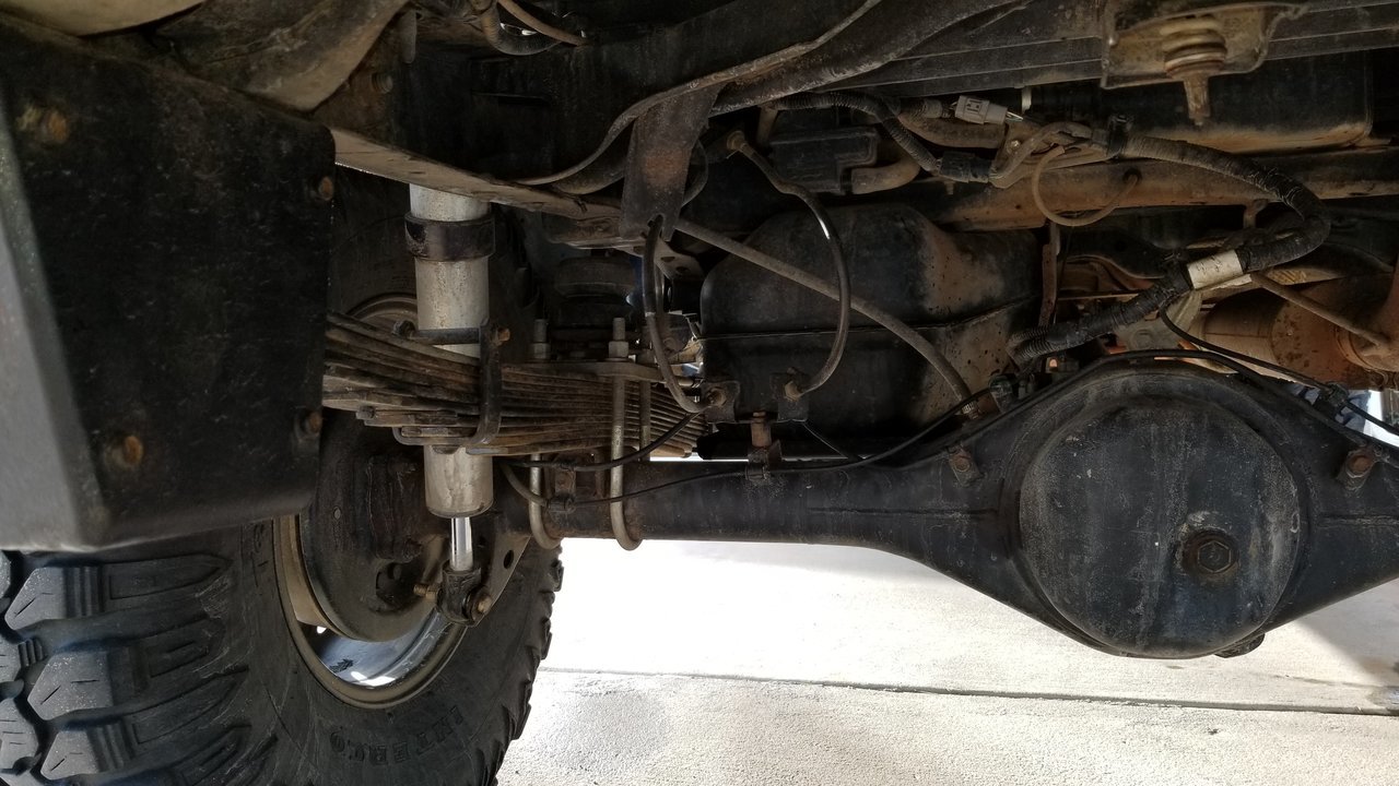

    for reference... at ride height. and it does appear to be contacting.. i might go in there and grind down the inside edge a bit at some point...

    Your leaf pack appears to be making a "w".... what pack is that? How much weight you running in the bed?

    deaver expo stage ii. should have gone stage 3. ran a leaf pack that was worse than that for 2 years, so i'll run this for a while then jump up later if needed.

    That's some crazy shit! I've actually been impressed with my ap expo springs despite the hate. Always planned on a deaver pack once these wore out but that's got some funk to it

    They are not going to rotate freely by hand when torqued down so don't worry about that part. The contact on the hanger shouldn't be happening also you would have to have way more down travel then the spring over can achieve to get the shackles to swing that forward.

    Man you set your bump way up there! Those leaves don't look too happy.

    So if the contact is only happening on one hanger, is there something going on that I'm missing? Why are they not the same on each? Do I need to install these bad boys and just check everything after and get back to you? Its hard to believe that the contact won't limit my droop but there's no way to really tell until they are installed and flexed out. Just want to make sure that if there's an issue after install that ill be able to still get it corrected.

    The corner gets sanded after welding the weld might not of gotten knocked down as much. If you have enough droop to contact that corner and I highly doubt you do I'll swap it out for you as it should just clear that corner.
