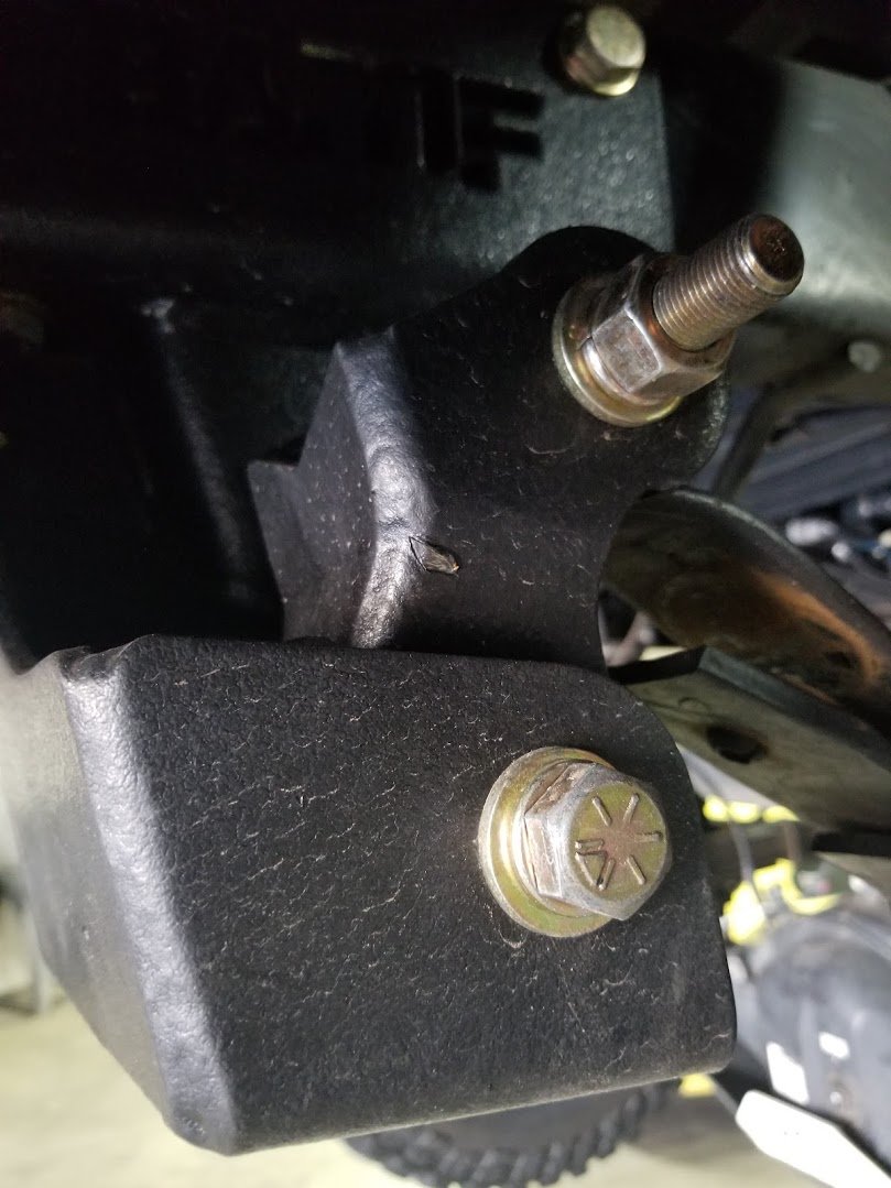

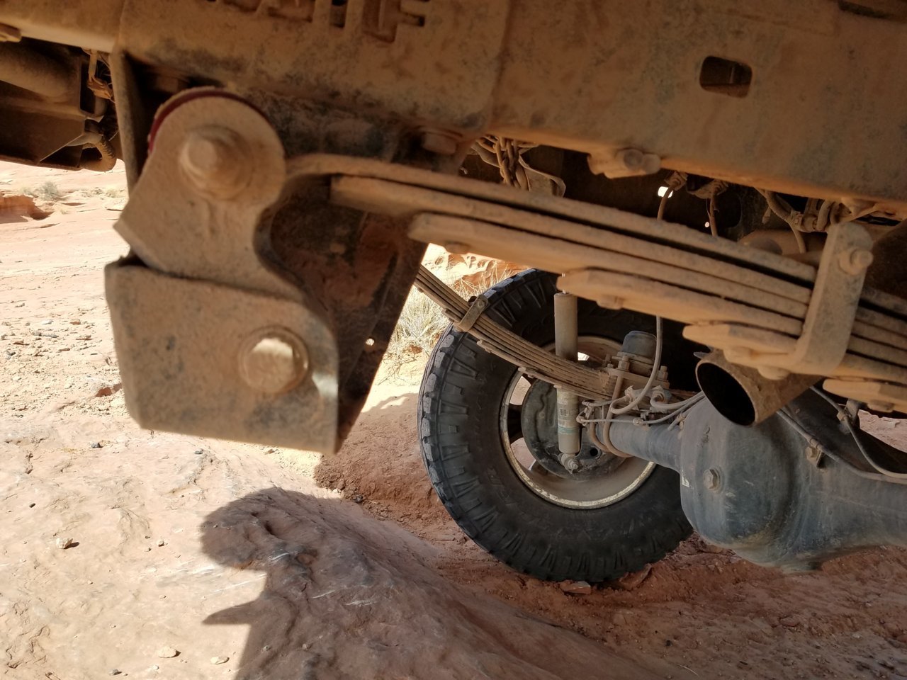

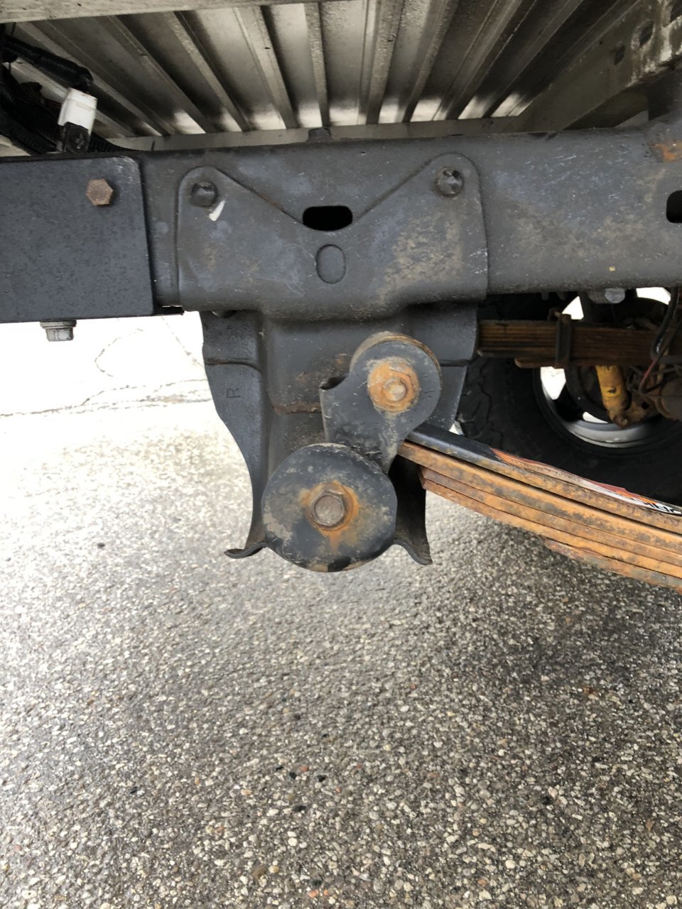

    All stock Superwhite 10' AC
    resting position of shackles with stock and with hd shackles
    Pyw4daX9v10f2hcW3z4jZz_K9X9sdYtBG25xuBy__69c7d9c787115ac5ed59ee36c7ffbe7f926d169b.jpgc9tiNF2P9WzcwJ-oy__b1IoVhJ8S8krAFmH8wwnf_6fc8895a5a8c5554c15ccca2ebd3555cc4a61363.jpg
    no rub on stock

    If it contacts at ride height...have you tried flexing the rear? Pics? Curious if the contact is enough to prevent shackle movement on uptravel
  5. Apr 11, 2018 at 7:52 PM
    #305
    Night Eagle
    Night Eagle Aka Mountain Goat or mr. Clean
    Mar 22, 2014
    #125893
    2,714
    Leo
    Steamboat Springs, Co
    2014 TDR Off Road
    Enough to make it a lot of fun!
    Yes it prevent the shackle from moving on up travel but not the axle. But doing so will cause the springs to do bad things.

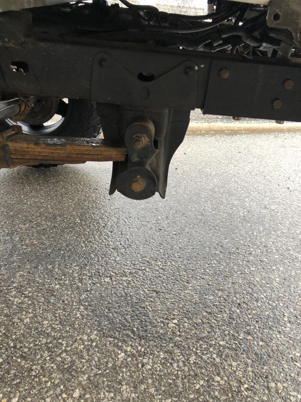

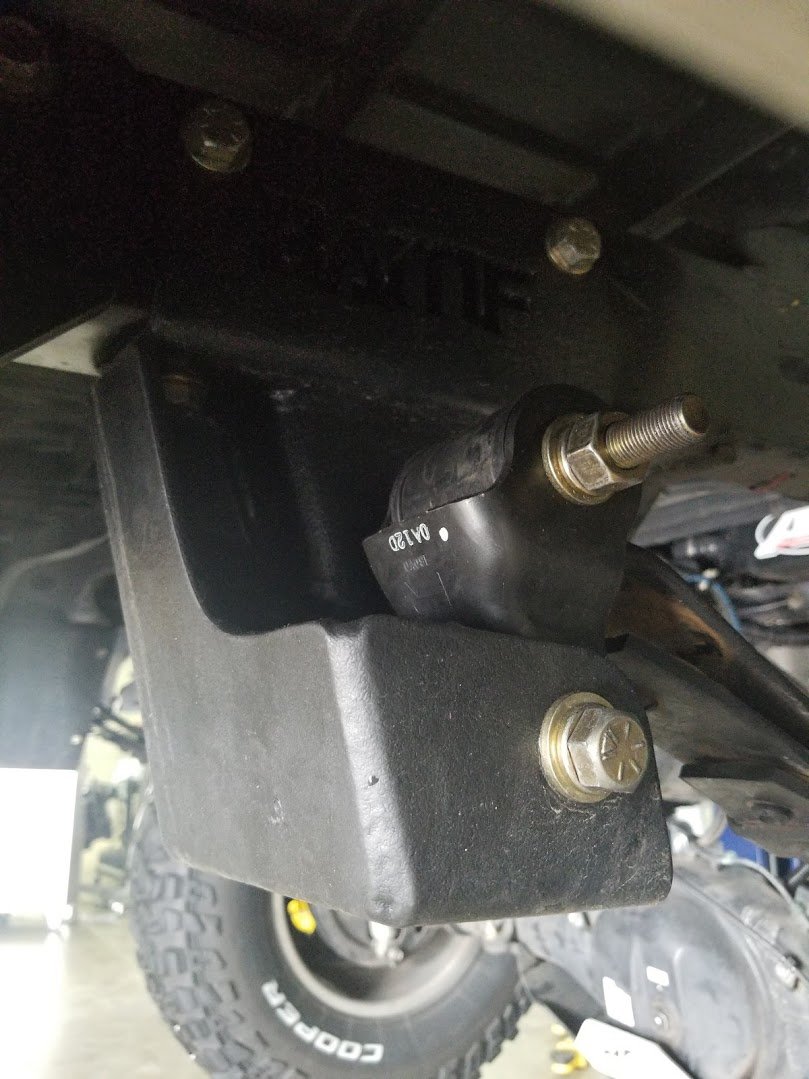

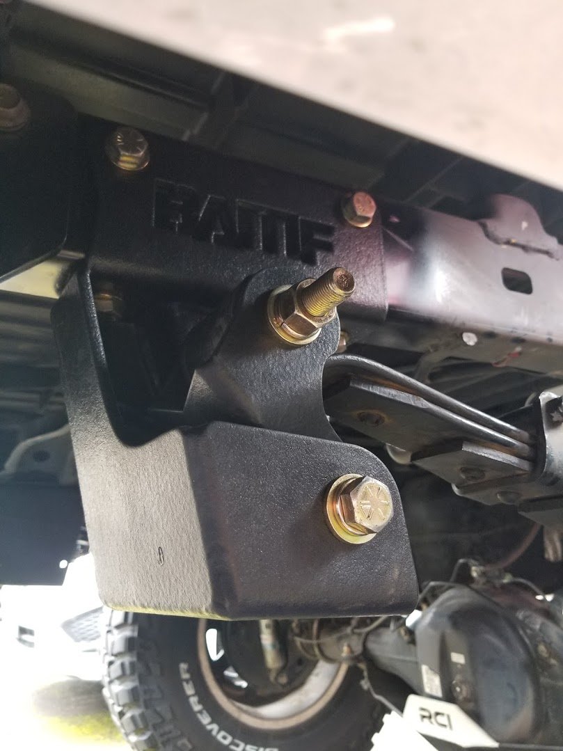

    Well, we will see if this enough. Physically the shackle cannot move back anymore without contacting the hanger itself. Can only cut so much.....
    8A965C11-F42E-4F3B-85E4-397CE44D7CF6.jpg C9EE9E95-E081-43A0-8057-17A6A705790E.jpg BB0AD135-F59C-4935-BEB7-080800825974.jpg
    The amount I grinded on the hanger itself, I had to go back and reweld.
    both shackles go back to the lip of the hanger which should be enough hopefully.

    was it contacting the inside as well? or was that just precaution?
  8. Apr 12, 2018 at 5:26 PM
    #308
    tacoma16
    tacoma16 Well-Known Member
    Mar 15, 2011
    #53109
    11,160
    Peter
    Ontario
    Double cab SR5 4x4
    No precaution. Just trying to keep them from rubbing. Was rubbing on both the inside and outside.

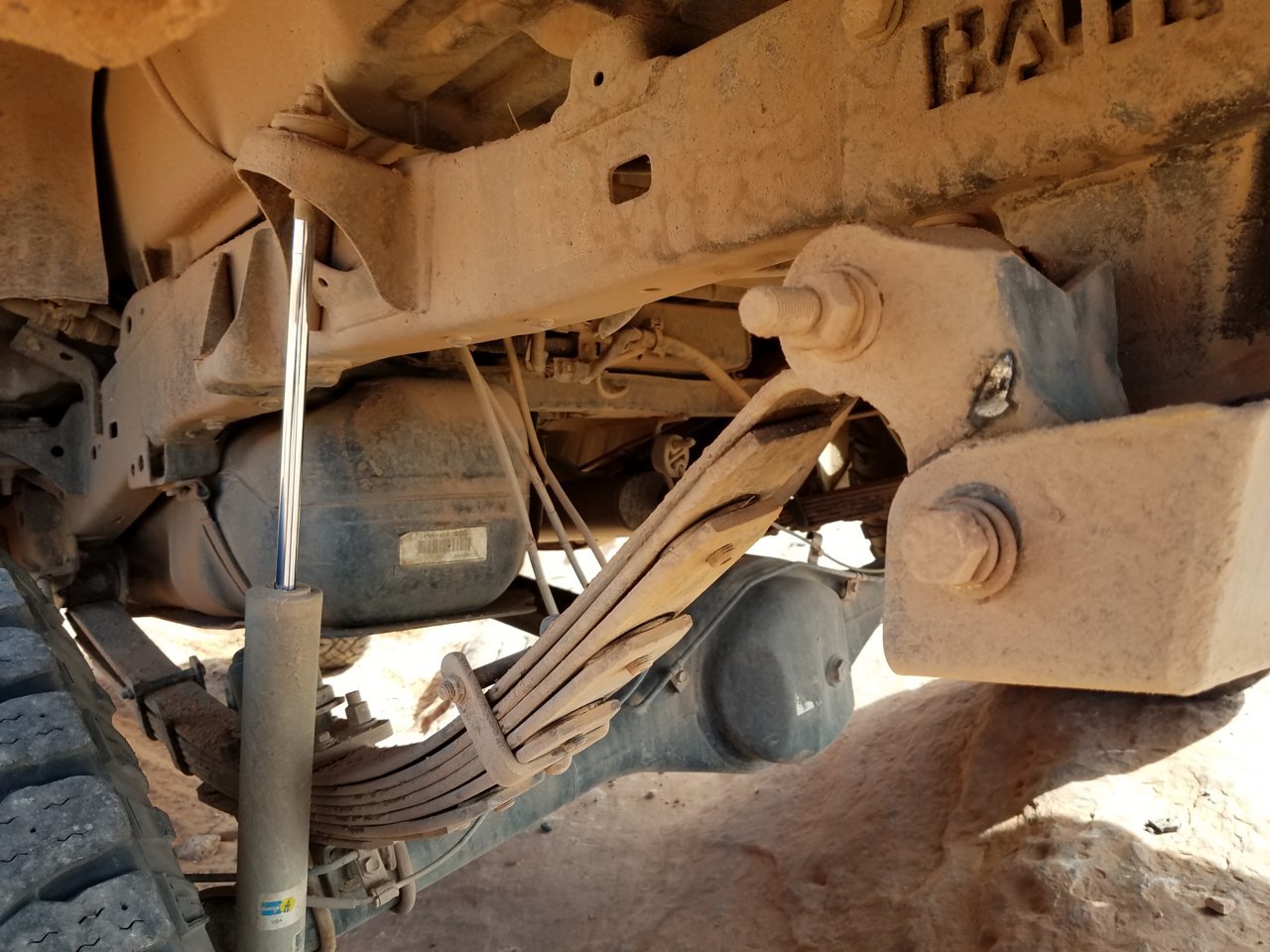

    I am also using the stock movement to guesstimate how much I should clearance. Although the new mounts will be slightly dofferent there isn’t much movement going on in general.
    This is flexed with the drooped wheel off the ground (had to mall crawl this one)

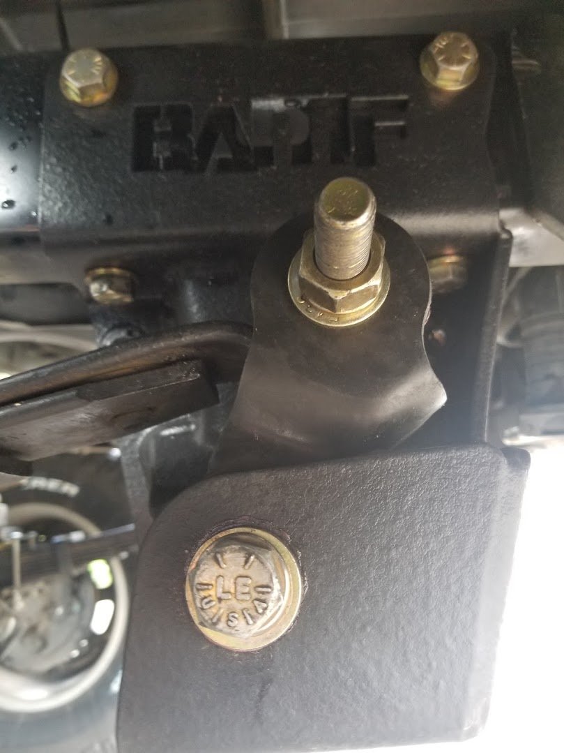

    here is what both the stock and hd at droop when the truck is in the air
    6ogY9wy7dMUlM_Ca1ymONFAqdtVb1tGwpEe7LtN-_1127dfb6a8ea5d2a13cbcfafb02ece79c8459a21.jpgjpO8jk0TMF39tWaRM2agOyz1K1-wO2zmRHLfCcxb_0c580d6496c7f6246cc59c88dfa13a67defcdd74.jpg
    at rest
    qvE8rwXX0kStLSJhliKVQMuDv1ShuLLSdy82UvYC_7251c50f3e5d391bfa6ec026545fc6f54f14a3c5.jpgeQLRNJIGMbpFVb5kNju-_3kcZw9QGWO-iAE6Fci__3cf77c23fca13c7014ba61c477c45cc0bb83fcb6.jpg

    all bolts are removable if put in right.
    the shackle to leaf bolt can be put in with the nut on the inside so it can be removed. mine is backwards as well as inesshell & night eagle (they both have long bolts). the bolt provided with my shackle was the perfect length where i could have ran it in with nut inside. that way, the shackle could be removed without removing the hanger. when i swap to the new shackle, i will be doing it this way.
    my setup, you can see the bolt is perfect length
