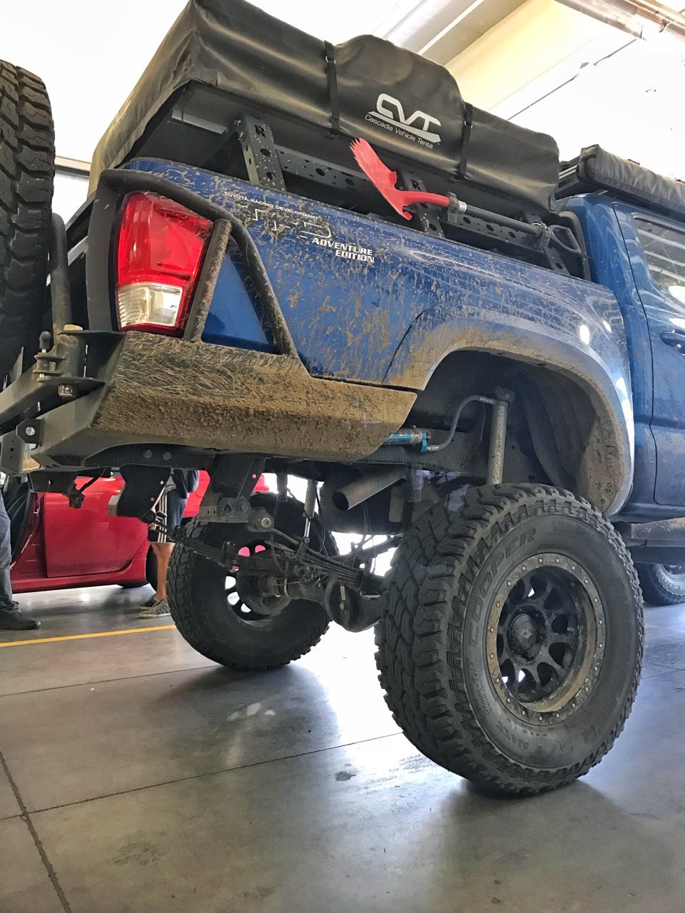

    I switched from Hammer Hangers to BAMF hangers because of issues with my HH allowing my leaf pack to lock out at full droop and less than desirable customer service once the issue occurred.
    To be 100% honest, it doesn’t feel like there’s any ride quality difference between the two. There may be a slight ride height advantage to HH but that’s solely because of the different pivot point which led to my issues.
    Jerry is on it with his CS and his hangers have worked awesome for me so far. I am very happy with my decision to switch.
    The first picture is after my truck was put on a lift and lowered down with Deaver Springs and HH causing the shackles to lock in the lowered position. That picture is with the truck on the ground. Second is the two side by side.
    BDA28D13-E1B7-4884-B36A-650154F7B28F.jpg CD4E532C-37B3-47FF-927C-81DE54AD65C7.jpg

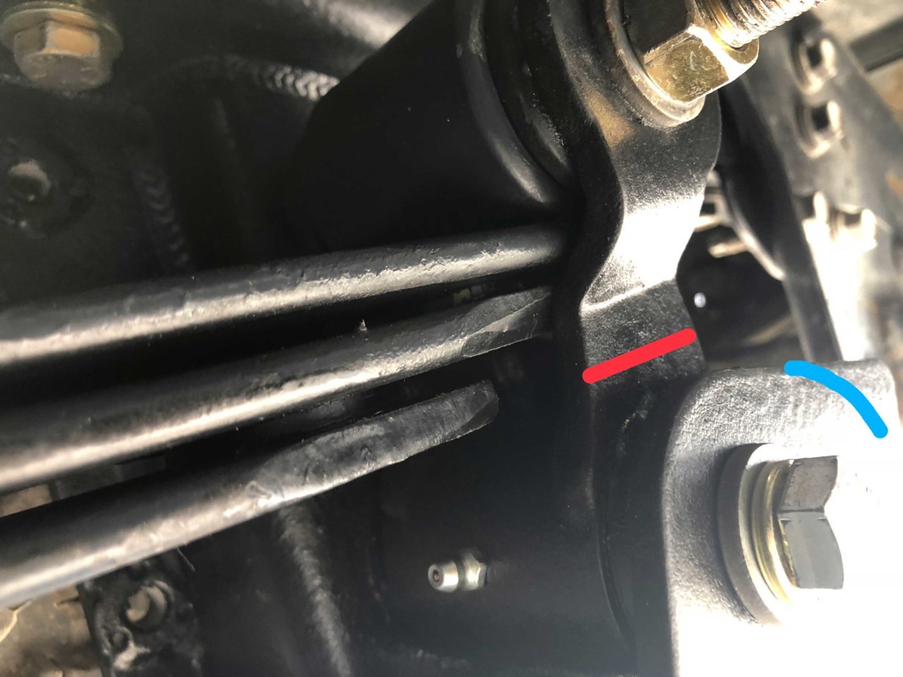

    Got the hangers on yesterday but couldn’t quite drop the truck off the stands because I couldn’t get the last hanger bolt to align... sigh. Going back to it tonight with better light. Those rivets were a son of a b*#% and it got late.
    Also, I have OME HD springs and it seems the second leaf comes in contact with the new shackle when flipped around. I did some minimal trimming (leaf) but won’t know for sure if that works until it sits. If it does touch, I may have to re think things like my old pac (all pro standard) or seeing if the factory shackles would clear to drive it around.

    Phone a friend, took a full day. Tested my luck on a $12 Harbor Freight air hammer/chisel (and very glad I did) and needed a couple discs for the grinder. Glad I never have to do that again!
    Spoke to BAMF on the OME compatibility with the new shackles and verdict is still out. Need to get the truck on the ground to really tell if my pedicure on the leaf pack worked. Might pick up a 9/16th bit for the stock shackle as a plan B, need to drive away tonight so we'll see what works and report back. Trimming seems mandatory for this leaf pack and may inspire some updates for customers trying to run those in the future (per BAMF :thumbsup:). I do not see why trimming the leaf pack (just rounding the corners) would effect the leaf as is, but we'll have to wait and see.

    I'd plan for two sessions, my arms got tired its a bit of an endurance fest...
    I think with the right amount of trimming the leaf, you'd be good. I thought I had trimmed enough so I went for it, and as you can see below it helped but still touches. I'll probably get the truck back on stands to see by how much. You could take note of how much articulation the existing shackle needs (sitting/stuffed) before removing your current set up, and just make sure you grind down that much with the new shackle mounted to the leaf off of the truck.
    If the bend in the shackle was a little lower (red), and didn't interfere with the hanger (blue), it might be non issue. You can see the grinder attention was in the right spot just not enough.
    You can see by the second photo, the leaf isn't really taking much of a hit in terms of integrity. Take note of where it's coming in contact with the shackle, right on the bend.
    I have plans to head to the sierras this weekend, so I might take it "easy" and get back to it next week. Im no expert, but it seems like this wouldn't be a huge issue to wait until i can lift my arms over my head again :muscleflexing:

    Thanks for the pics this is exactly what I would recommend doing.
    We cant move the bends down as the shackle would contact the hanger at full bump.

    you might be fine, put the shackle on and see if it touches. i bet not by much if at all

    Not at all there is no reason to hammer down on it and over heat the material.
