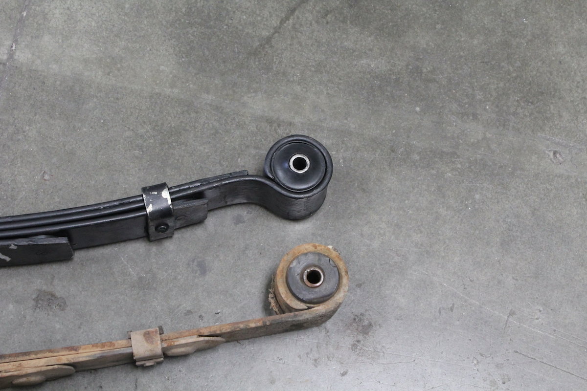

    We don't have a list of compatible springs. We know standard style eye springs do not work with the shackle without modification.
    The spring on top is the type you want to insure clearance.

    The Standard eye leaf springs dont fit well into the shackle.

    I have only had two people contact me that have issues with the spring contacting the shackles both have custom leaf packs. Some will be just the second leaf and some might not work at all with the standard eye on the custom heavy load packs.
