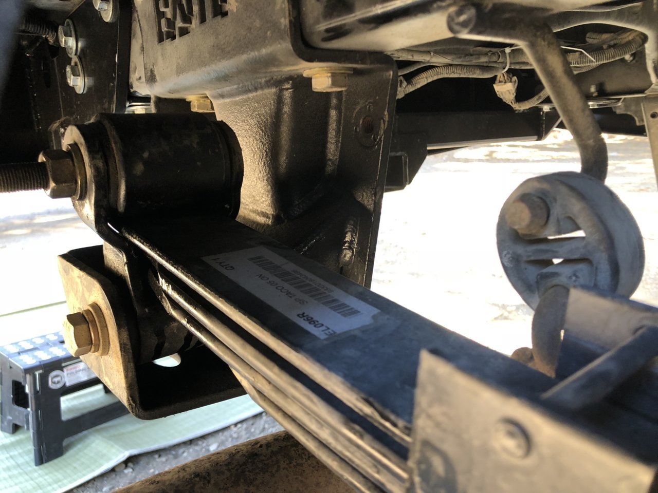

    re: Dakar compatibility, I finally tapered the second leaf to a thinner profile to clear the inside of the shackle... it appears that the top leaf (standard eye _O style) is still going to contact at full stuff. you can see from the pic it just clears with the truck parked (not stuffed, see bump stop)
    not terrible, but not ideal. haven’t flexed it yet to get a real read on articulation. hope that helps!

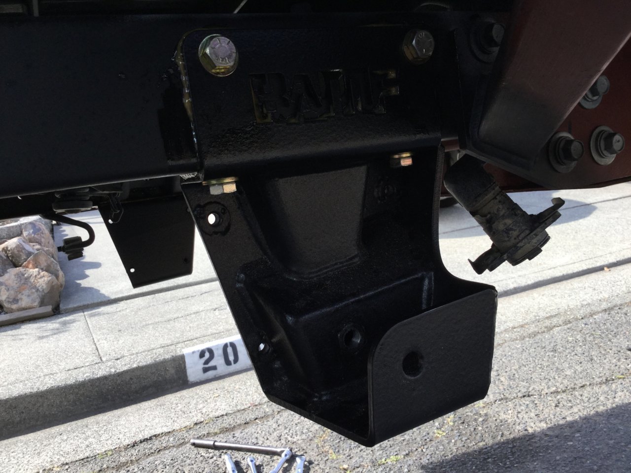

    being barbaric with a drill and a grinder i did get those rivets cut thru and hammered those OEM shackle hangers off the frame. it was hard took a lot more hours than i’ll admit. placed new hangers today and torqued on those nut/bolts. able to get one leaf pack onto the axle, but not eyelets aligned. took off the Dakars replaced with Allpro EX packs, much harder to lift working solo.ACB4E4BD-D1A1-4641-AC5B-D51270D45BEF.jpg
    ..and did remove the hangers in order to bolt up the spring/shackle and shackle/hanger...easier just like jerry said
