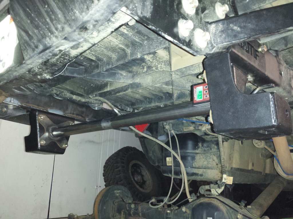

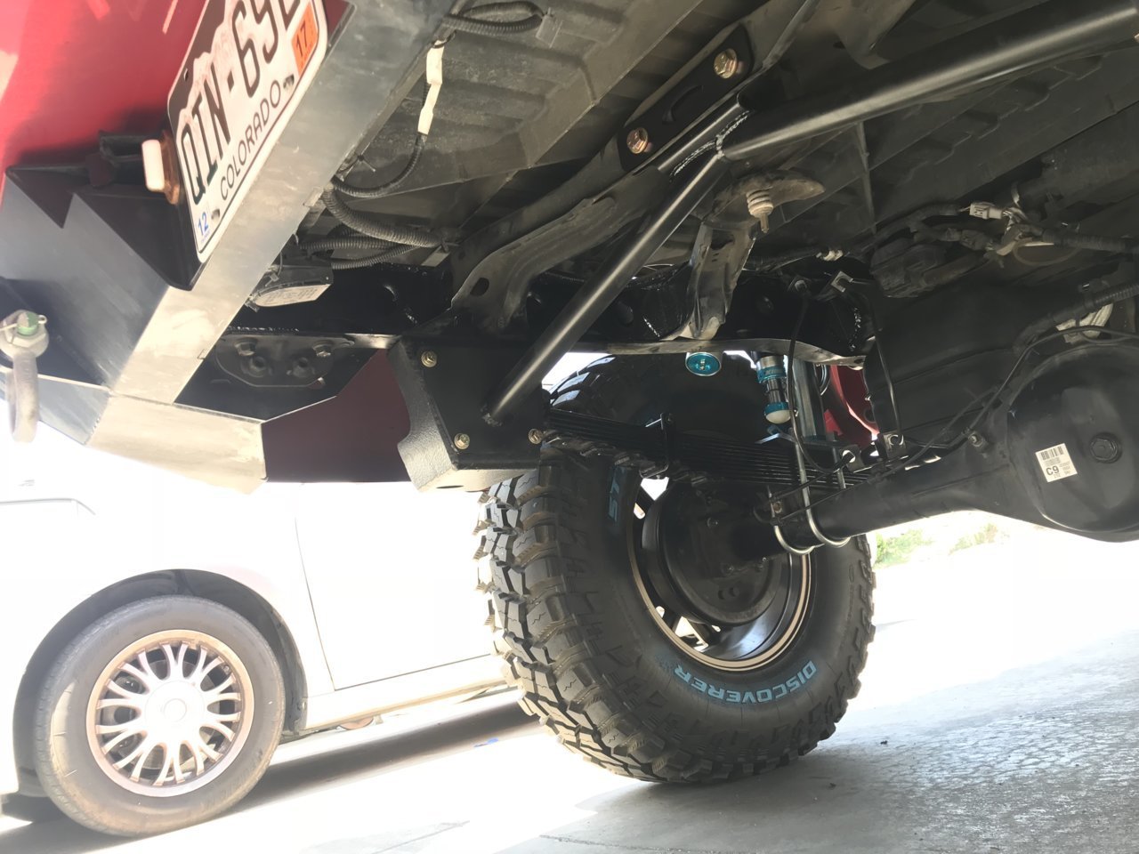

    I haven't seen anyone install these with a boxed frame and a hanger cross member :cookiemonster:
    (frame X-member is getting burned in tonight :) )

    How did you do the hydro bump plate?

    I welded in backing plates inside the frame that have weldnuts on them so the hangers can be taken off at any time :thumbsup:

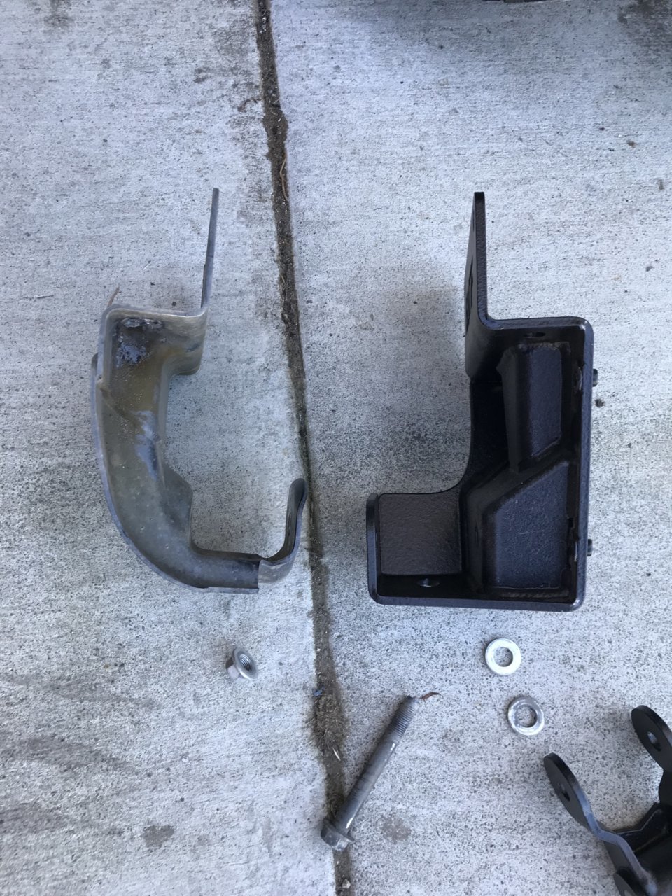

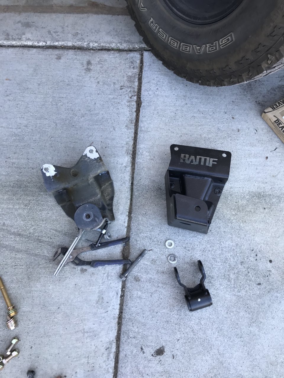

    Got one side on over the weekend. Going to tackle the driver side tonight. BD89A632-9176-468E-AF9A-2EE3FEAAAA25.jpg26957F6C-2B6E-4346-B75B-C781E7682D0C.jpg AC98ED23-F8D7-4658-89D8-20F2F8FAE32C.jpgAA53DFEB-2737-4C3F-B3D3-12CFAECF3BC2.jpg

    PM me your number so I can send you pictures of the other side. Condition is the same. I didnt use and angle grinder on any of them, just drilled through the rivets.
