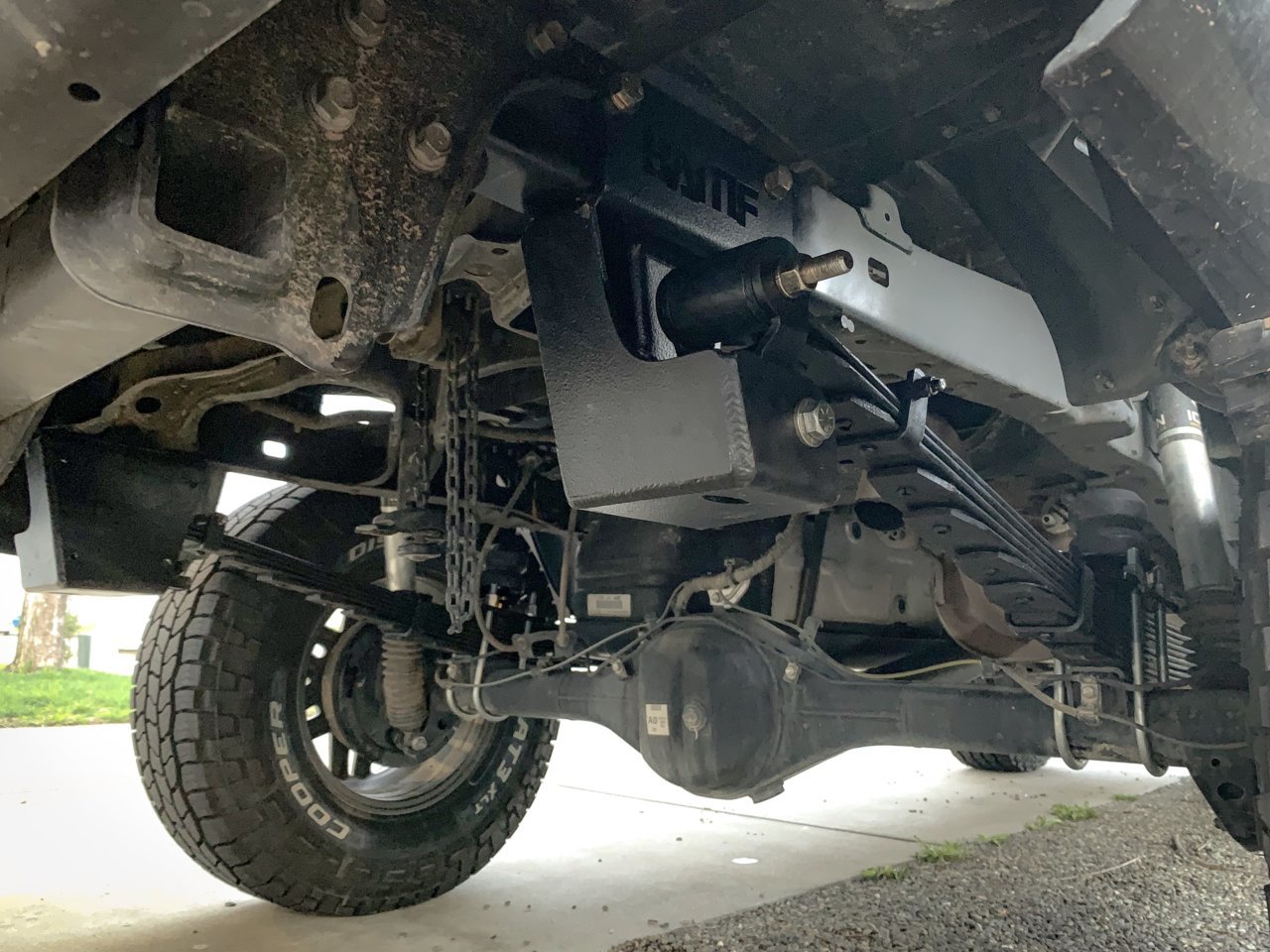

    965B14F6-9736-452A-8632-601B76CC8F09.jpg I have Dakar’s and cut the leafs to fit the hangers.... it works eventually I’ll upgrade to deavers. For reference only

    I feel you man

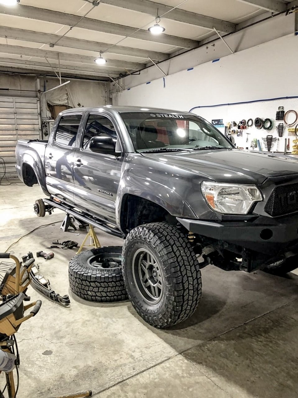

    Did mine on the weekend. I tried the grinding way and drill method on one rivet just to see how it went. It wasn’t cuttin it for me. So we used a plasma cutter, like butta. No rub on new shackle design. 10/10 quality. . 2DED5A34-E7B5-42E8-9ACA-9F54B06480A5.jpg 5C969732-666F-4E05-9D2E-5BB737E67460.jpg
