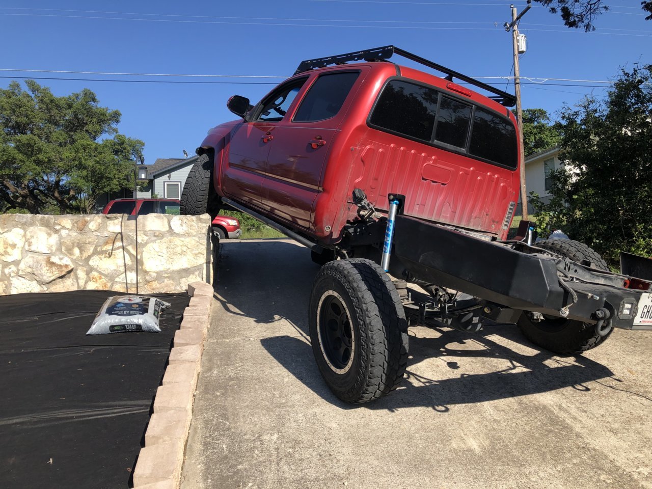

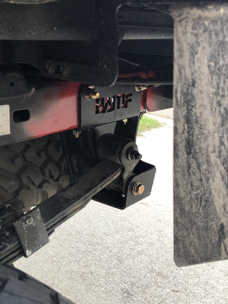

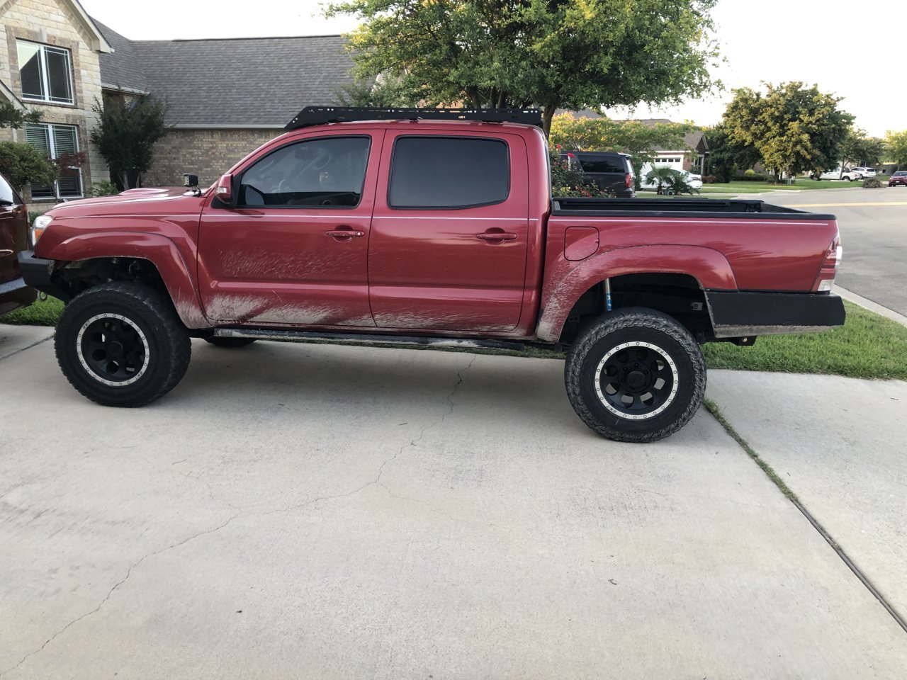

    Finally got the hangers and shock relocate installed today. Holy cow is the ride so much better and the flex is top notch compared to before. I know dakars not the best for flex but I’m hella happy with this.
    Thanks for such a incredible product.

    Thanks !! I don’t know, only mod that had to be done was drill out the stock shackle to 9/16 was all, the dakars fit and just fine no binding whatsoever.

    I didnt even have to do that with my stock shackle. everything fit perfect for me with the stock shackles and dakars w/ AAL

    There is a split sleeve in the stock shackle if they are not aligned is when you need to run a drill bit through them.
