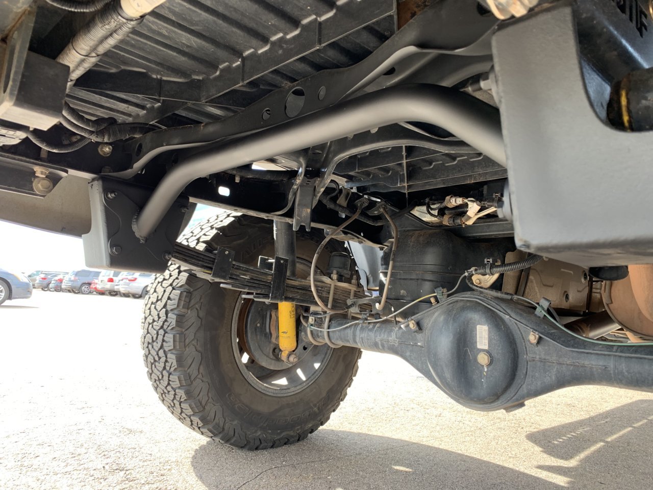

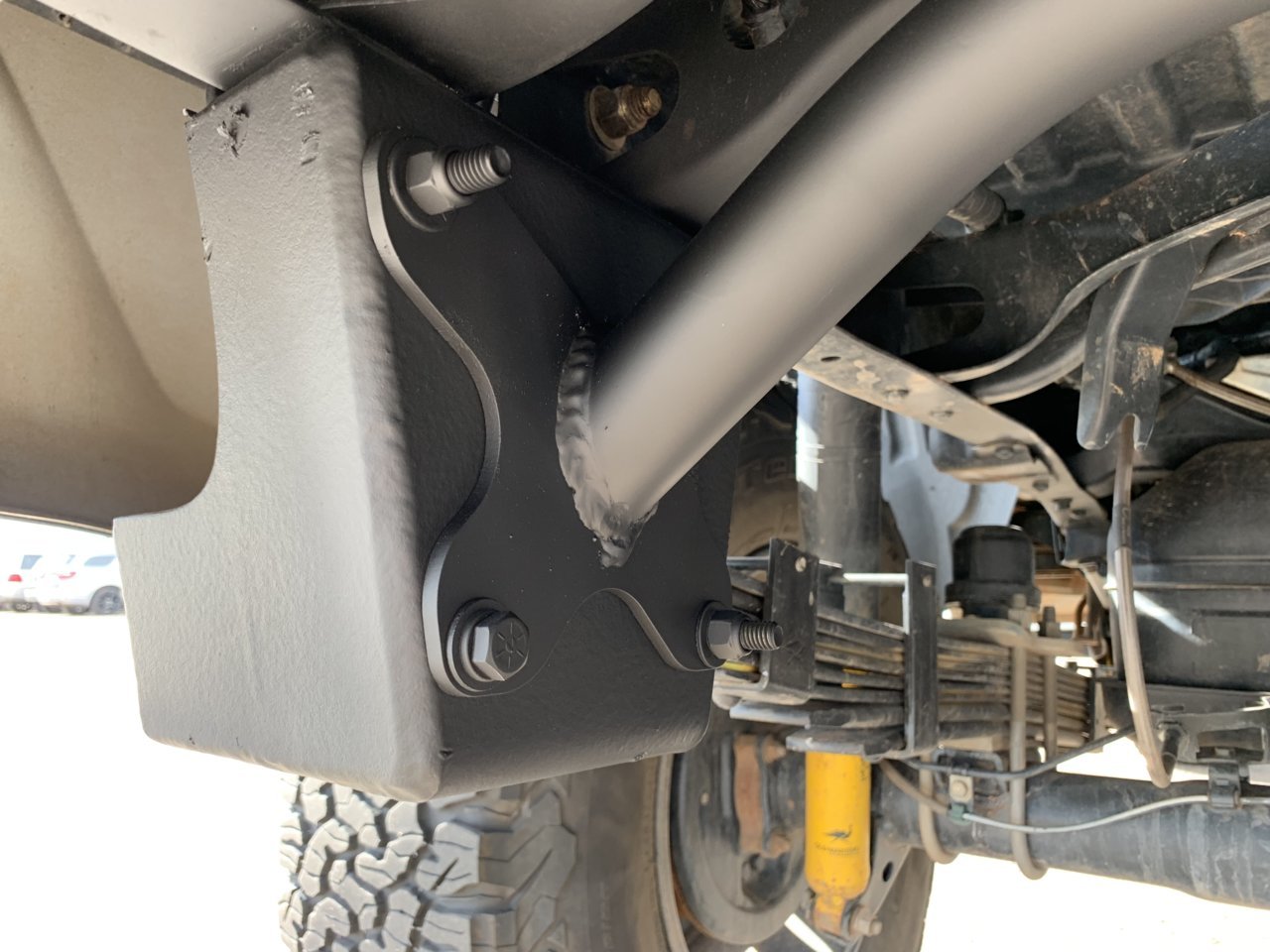

    1.75” DOM TUBE. bent to 39 degrees on both bends. 1/4” gap between cross tube and ‘X’ in the frame. HIGH CLEARANCE :thumbsup:

    Did you notice any negative effects with the cross bar? Like less travel up or down because the frame is more rigid now ?

    Just did this last night and have only been on pavement but I have no way of believing this would limit the travel in any way. Plus I have basic OME nitrochargers...what is travel lol

    That’s the size of the tube. Think he’s asking with thick is the tube. Aka .120wall?

    Here is what I ordered:
    https://www.metalsdepot.com/search?q=T2W134120

    i have comprehension problems....it's .120 wall
