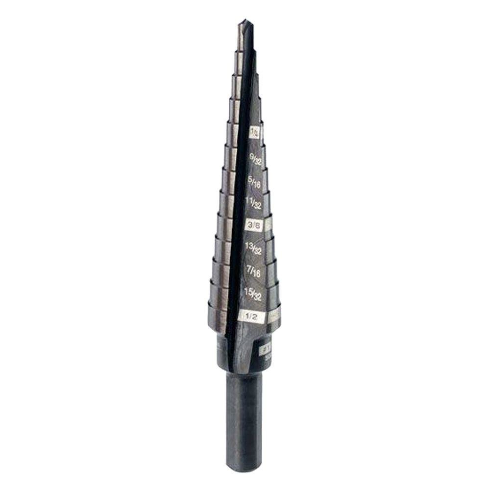

    A small pilot hole (3/16”) followed by this step bit does really well if you’re gonna drill. Just remember to keep speed low and plenty of lube. Patience is key.
    Though I recommend a different approach. Grind heads off rivets, and use a ball joint press and small grade 8 bolt to press them out. Works wonders. Second set of hands helps to line everything up.
