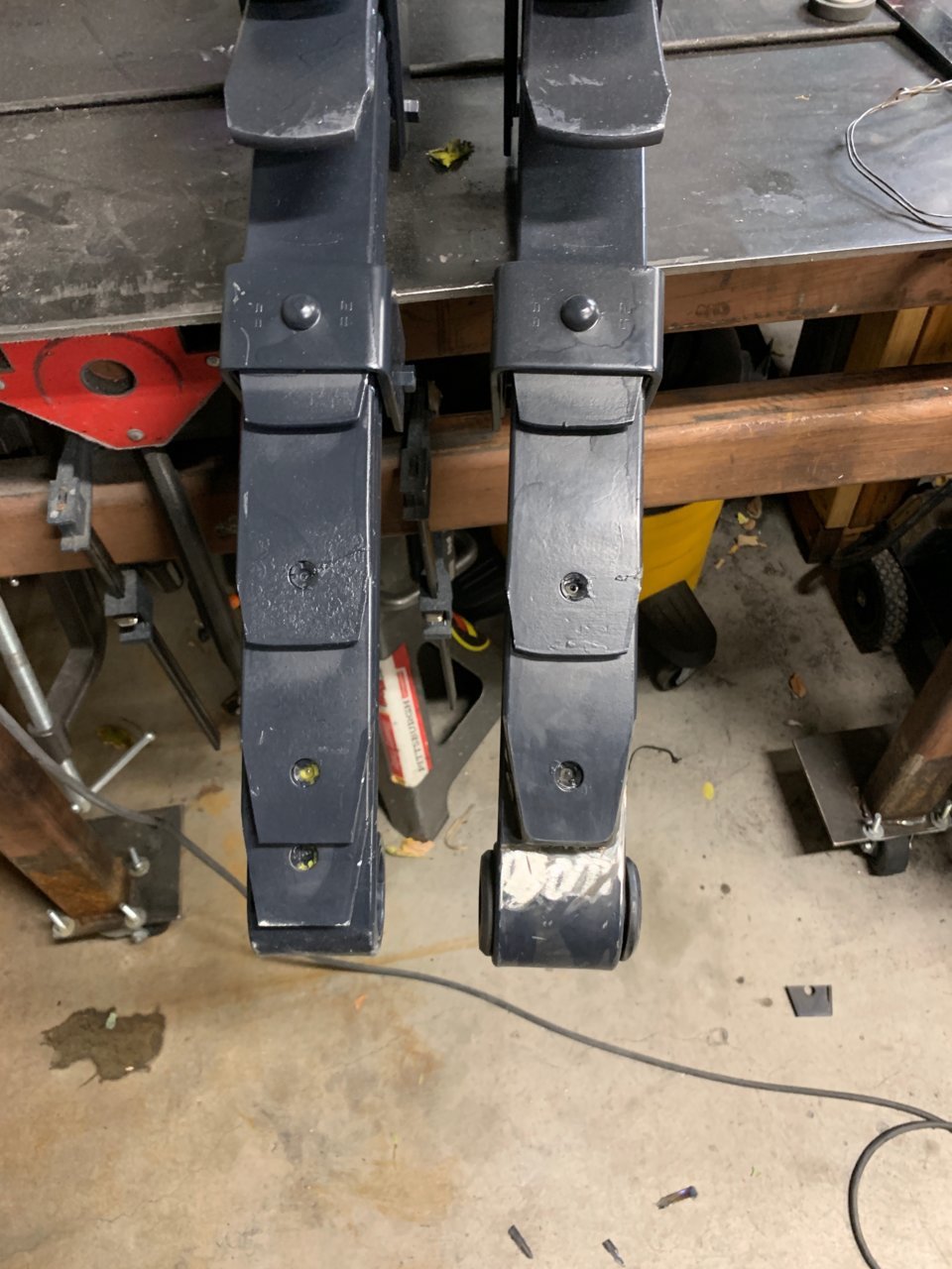

    From the moment I first saw a set of these being installed I wanted them and ordered right away. Then they sat in my garage waiting for an opportunity to have the rivets blasted out with plasma cuz the other methods looked like a major pain in the ass. Today that day came!
    I had to use an angle grinder to trim the edges of my Deaver leafs. Most Deavers use a Berlin eye at the end of their leafs but because my truck is so heavy they custom did this pack with a regular eye which means the second and third leaf might contact the shackle if not trimmed. 702991D6-118C-458B-ABEC-6535E5F702D6.jpg

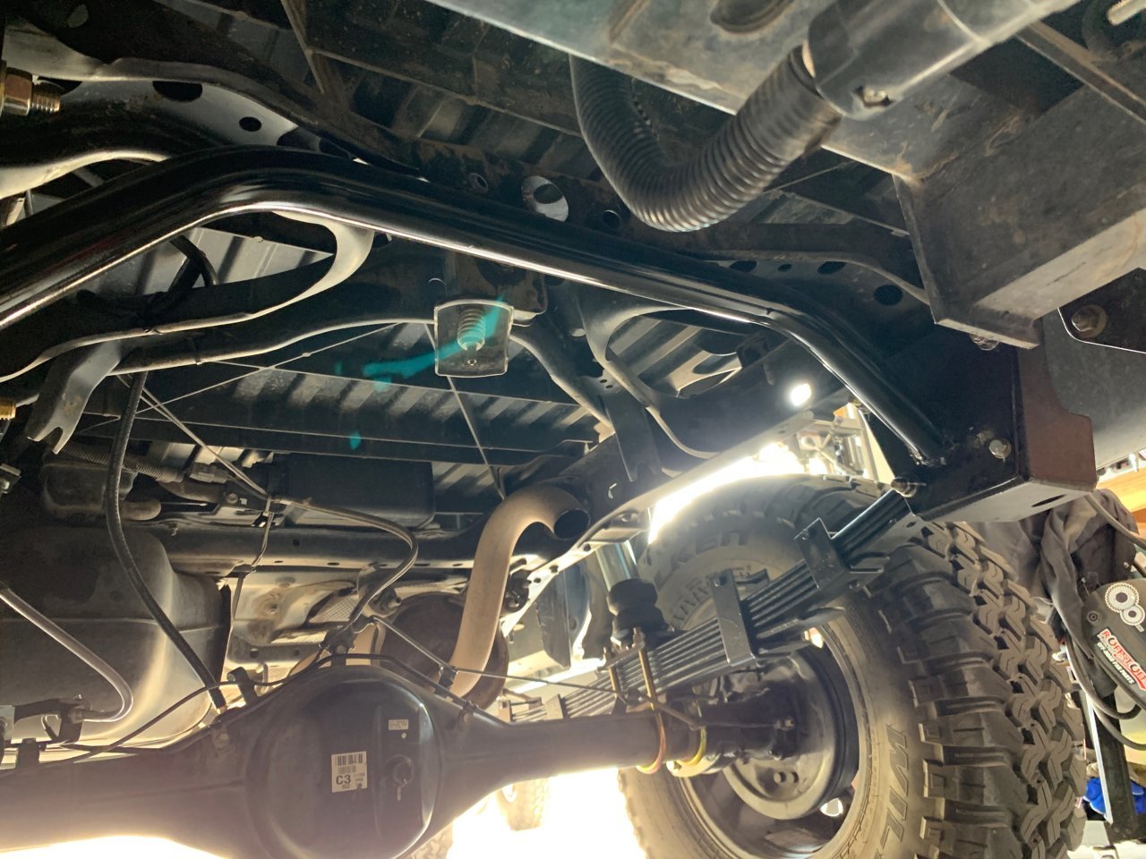

    Here is my setup. Trimmed Ome HD dakars and crosstube.

    Nice, love that cross brace.

    do all dakars need trimmed or just if your using factory shackle ?

    As far as I know they don’t need to be trimmed for factory shackle. I used the bamf hd shackles and you can see where they were cut in the pics.

    It's the other way around. They need to be trimmed if using our shackle.

    cross tube looks familiar! I like it :thumbsup:
