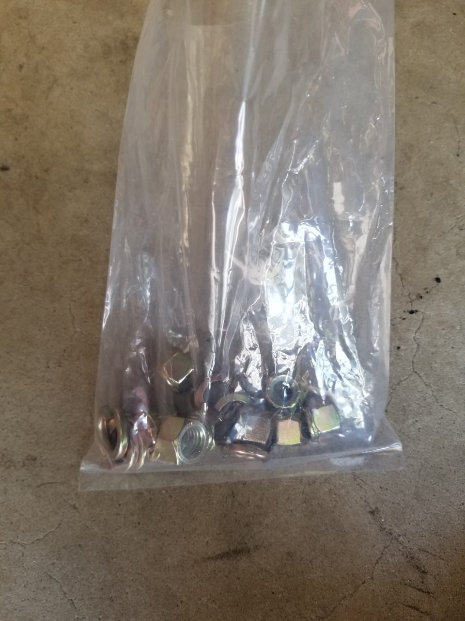

    @JLee trying to knock this out, something is missing??? No lock washers or nuts for the frame bolts. My fault for not checking the hardware before starting this project.

    Definitely missing some hardware

    should have 8 1/2" nylocs as well

    Idr if I had nylocs or not. I know I had lock washers for the frame bolts though.

    Missing hardware for sure you should have 8 Nylocks as well. If we left those out go pick up some at the hardware store and email me the receipt I'll send over the funds.

    Nylocs we only have lock washers on the fine thread 9/16th bolts because nylocs were way too are to get in fine thread 9/16th.

    No worries, just got back from budget bolt. Bought everything I needed, I also get a discount from them. I am moving forward with this project again, don't sweat the missing hardware, just wanted to let you know. Besides, your going to build me a bed rack one day. Thanks for all that you do, will post pics soon. Take care Brother.

    If your keeping track of qc with the nut/bolts one of the 2 kits I got was missing the fine thread nuts. But already got some from the store.

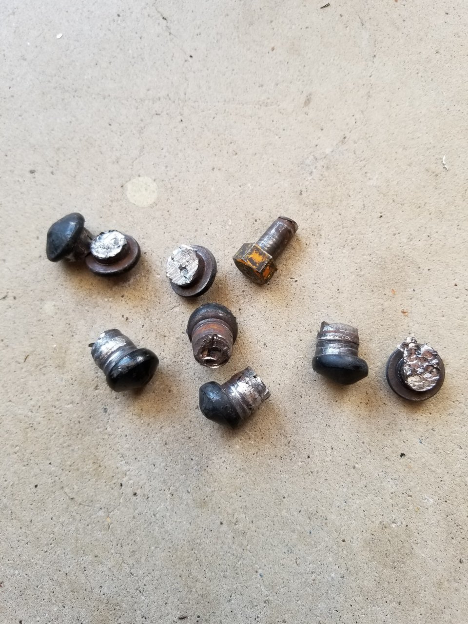

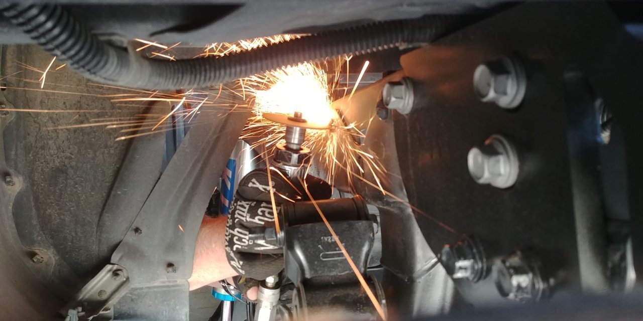

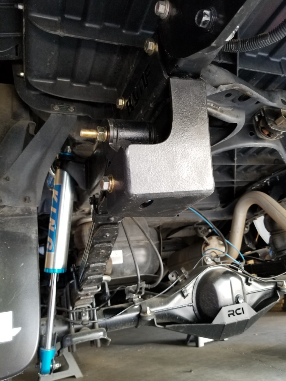

    1 side done, the other side is ready to be installed. Rivets are no joke, started with a small disk cutter, X-ed the head, air chiseled heads off, BFH to remove stock hangers, X-ed what was left of the rivets sticking through the frame, hit them again with the air chisel, used a ball joint press to remove the top ones, and the air punch bit for the sides. Will finish this up tomorrow.

    Hangers are done and these little basturds caused me to spew a few curse words.Bolt was used to press them out with the ball joint press. Working on my cross brace now, just need to fab it all up.
