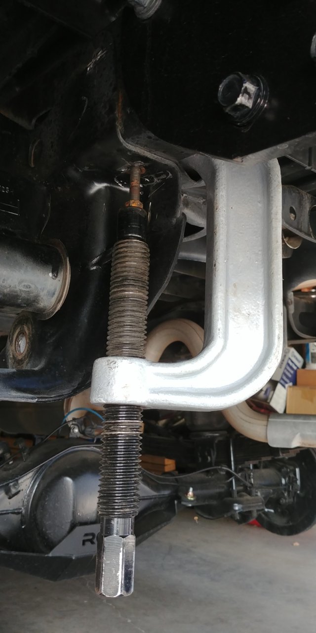

    My helper sent me some detailed pics on how we used the ball joint press. Hope this helps someone out.

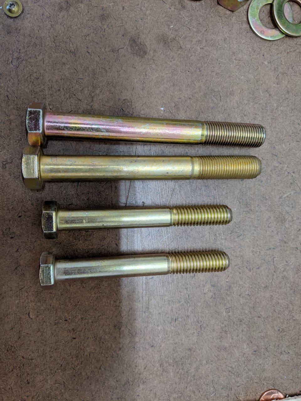

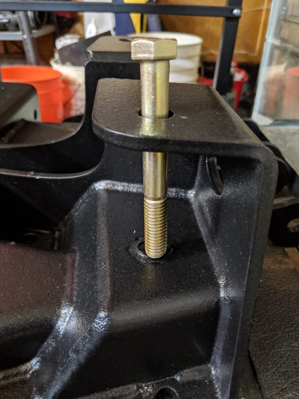

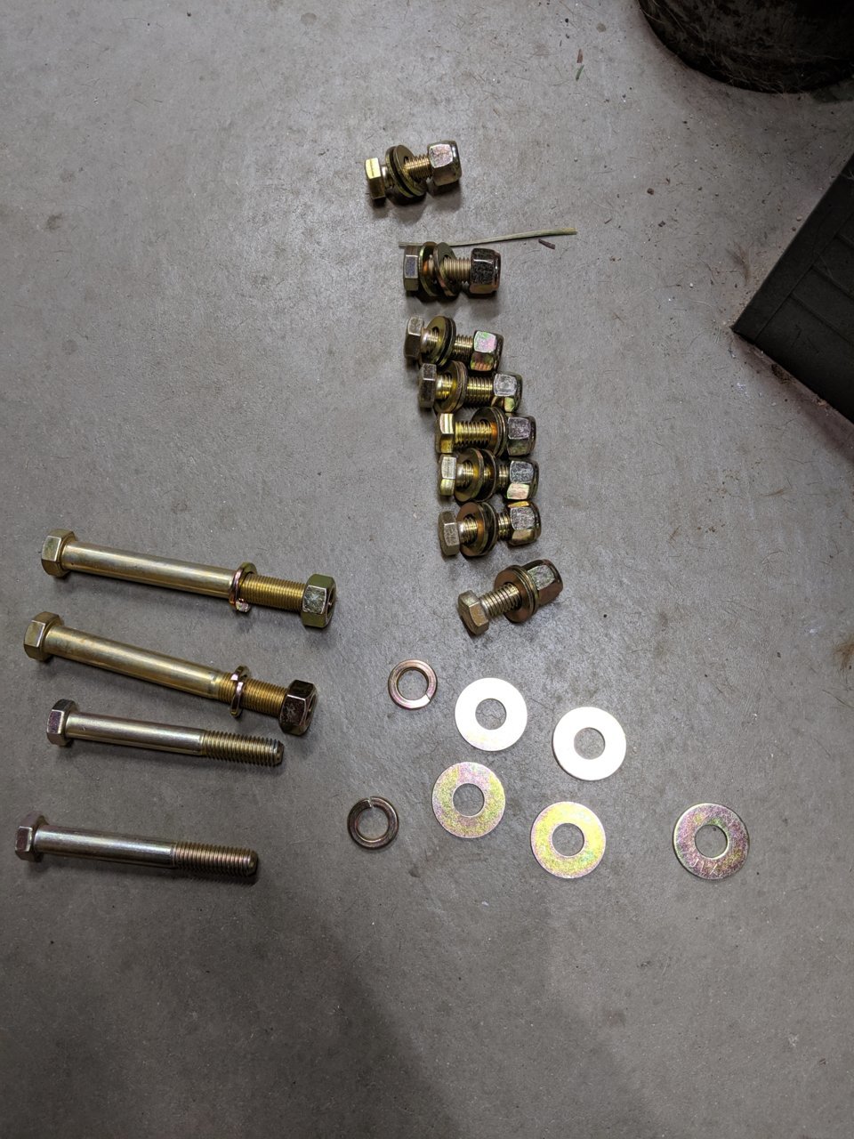

    Just a reminder for others to always check your hardware before you start tearing things apart.
    I'm still a ways out before I get time to install my hangers, but I checked the hardware today we'll ahead of time.
    Quantities all look correct but two of the shackle bolts appear too skinny and have coarse thread instead of fine.
    I believe the short ones are supposed to go through the bottom shackle mount. If so they are too small.
    @JLee am I correct that the short ones should be the same thickness and thread as the longer ones? I can just pick them up at the hardware store, but want to make sure I'm not overlooking something.

    Those are too small.

    Those are the wrong bolts they should be 9/16th fine thread bolts. I just checked out stock and sure enough they did that with all the bolt packs we have made up.
    You would most likely need to order it from the hardware store. I'll get some sent out asap just shoot me an email with your order number.

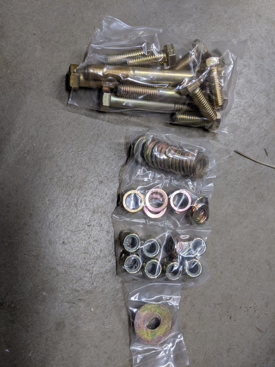

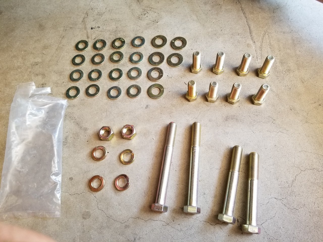

    I think we all got the same stuff
    @CharlieCafe @Coop68
    Sealed bags
    Laid out
    IMG_20190828_202639.jpg I have no idea if I put the right nuts with the bolts or not, but the 2 nuts on the long bolts thread but tightly. Not like the nylock nuts that easily thread on to the little bolts.
    The 2 shorter long bolts slide in and out of the threaded holes in the hangers (too small)
    Edit: looks like Charlie has 6 of the larger washers where I only have 5.
