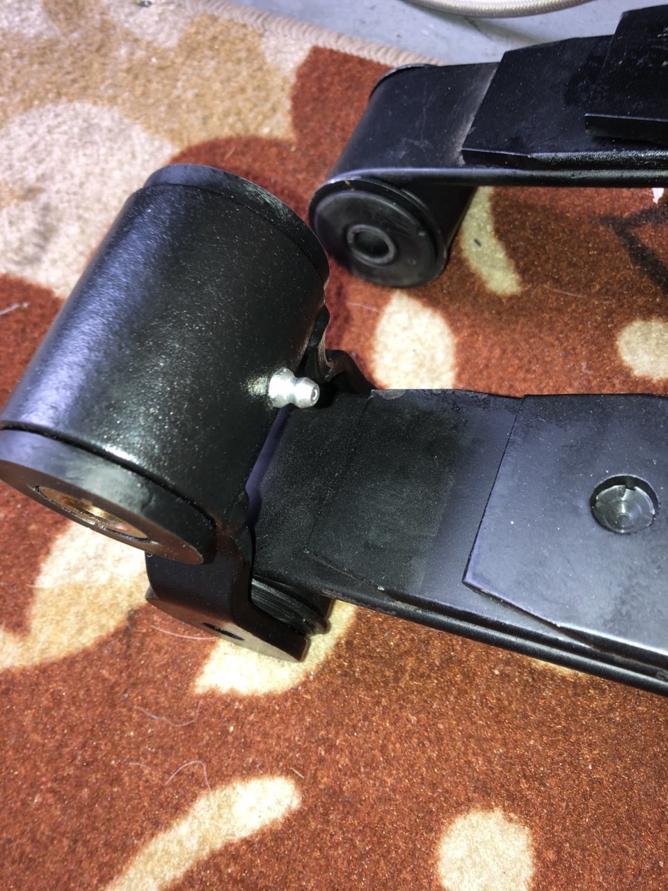

    My set arrived today. First impressions, the box with hangers/shackles was WAY heavier than I expected it to be!
    These things are pure, unadulterated beef.

    @cdex8357 Looks like a bit of shaving needs to be done on the second leaf. What do you think
    @JLee

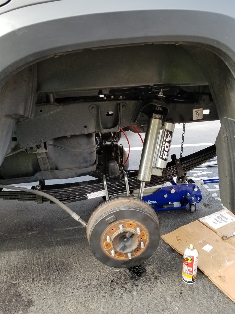

    I'm so fed up with this hanger... I've spent at least an hour trying to get the lower shackle bolt to engage. Why did @JLee make the nut fixed and hidden? This would be so much easier if it was open on the back side and the nut was visible. Now, being even a mm off means the bolt won't engage.
    About to get back to it, but I'm about to throw a wrench.

    I was able to get it using a jack under the axle.
    Bertw192[QUOTED] likes this.

    Finally got it shortly after this post. Had to jam a bolt in my deep 13/16 socket, so I could put pressure on the bolt while turning it with a screw gun... finally got it to catch. I'd still prefer a non-captive nut.

    Not yet. Shitty weather. I’m gonna shave the 2nd leaf. It’s just a few mm on each side so no big deal.
