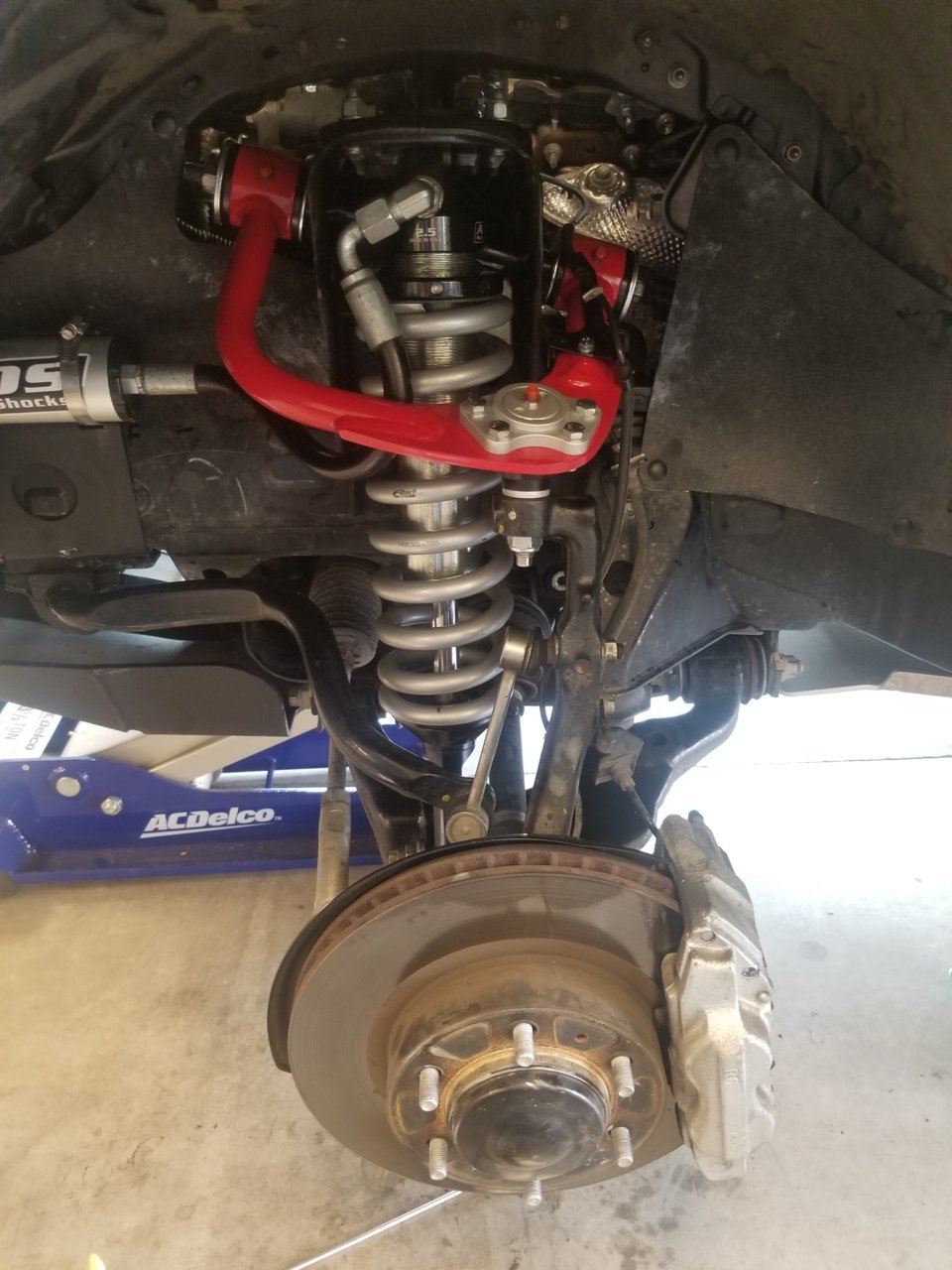

    @outxider how did the install go. You got pics?

    After the full suspension install(coilover/uca/leaf pack)...i threw in the flag. Just didn't have it in me to do the hangers right after. I may attempt it this weekend providing weather is good or on Tuesday(Holiday and off work).

    Yeah i would of done the same that's a lot of work for one day.
