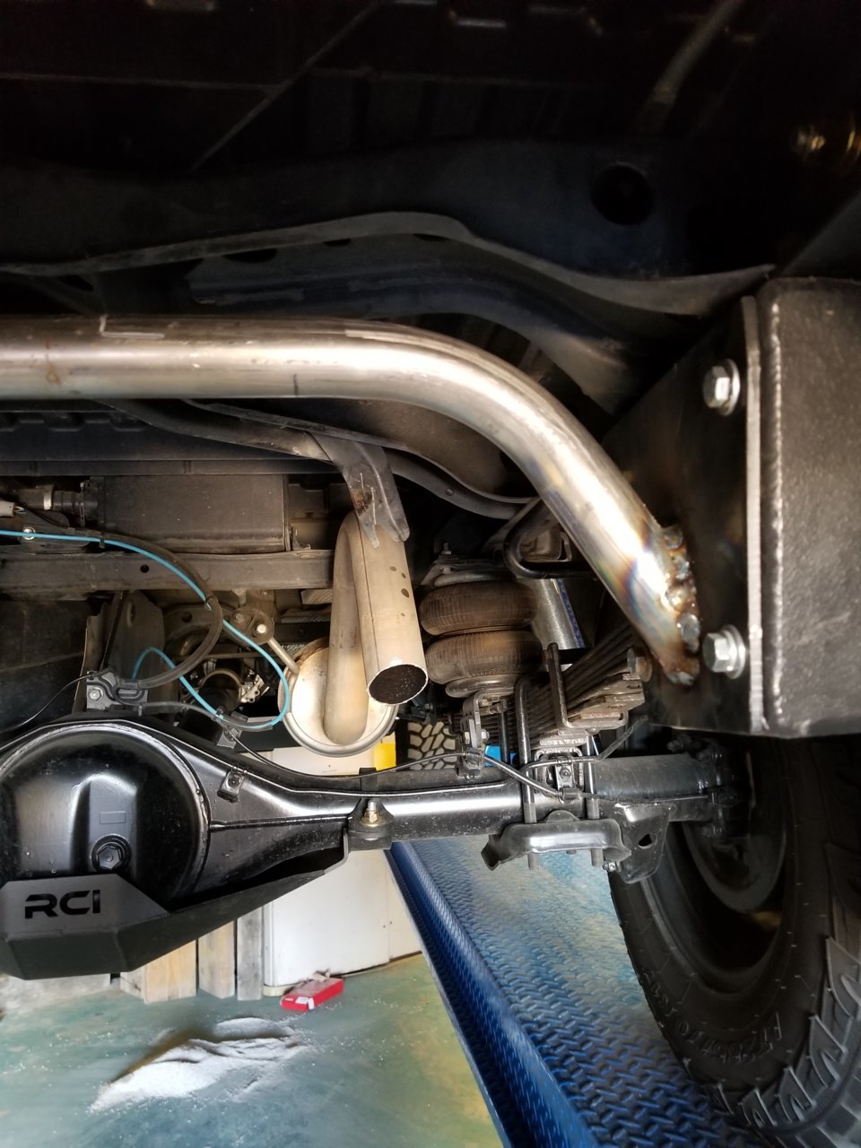

    Thank you! Had a quick question regarding your HD shackles for the Tacoma. Currently, I am running stock shackles with the Dakar medium packs. Recently, I've noticed the second leaf on these packs is binding with the stock shackle and making a really annoying metal on metal nose. The second leaf extends into the shackle's cavity (see pics attached). Have you guys had this problem before with the combination of your shackle hangers and HD shackles combined with the Dakar leaf packs?

    Yep. I just trimmed the second leaf about an inch or inch and a quarter. Common issue. My Deavers don't do that, however, just the Dakars.

    I already replied to the email you sent shave it for sure.

    this is my post from a few pages back. Shows where the cut was made with my HD Dakar’s.

    Perfect! Thank you for the pic.
