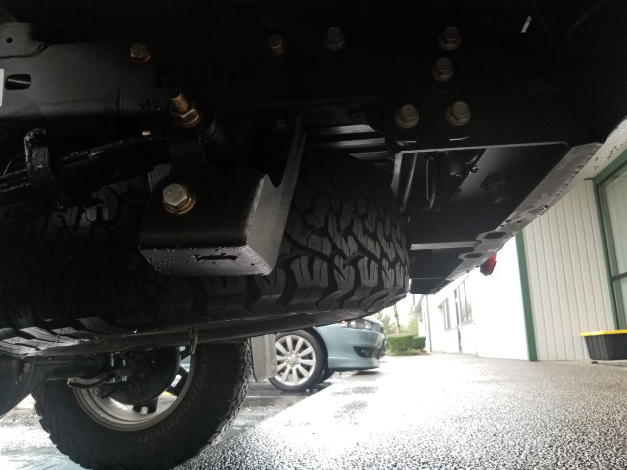

    GD sticklers... here's my "wet" truck

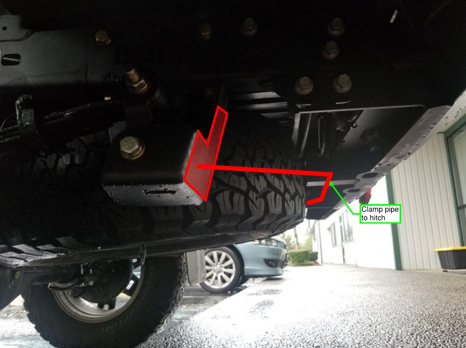

    Here you go... updated scribble with MY truck.

    still won't fit when you upgrade to 33+ tars. Might as well take the pesky rubber out of the way now. :cheers:

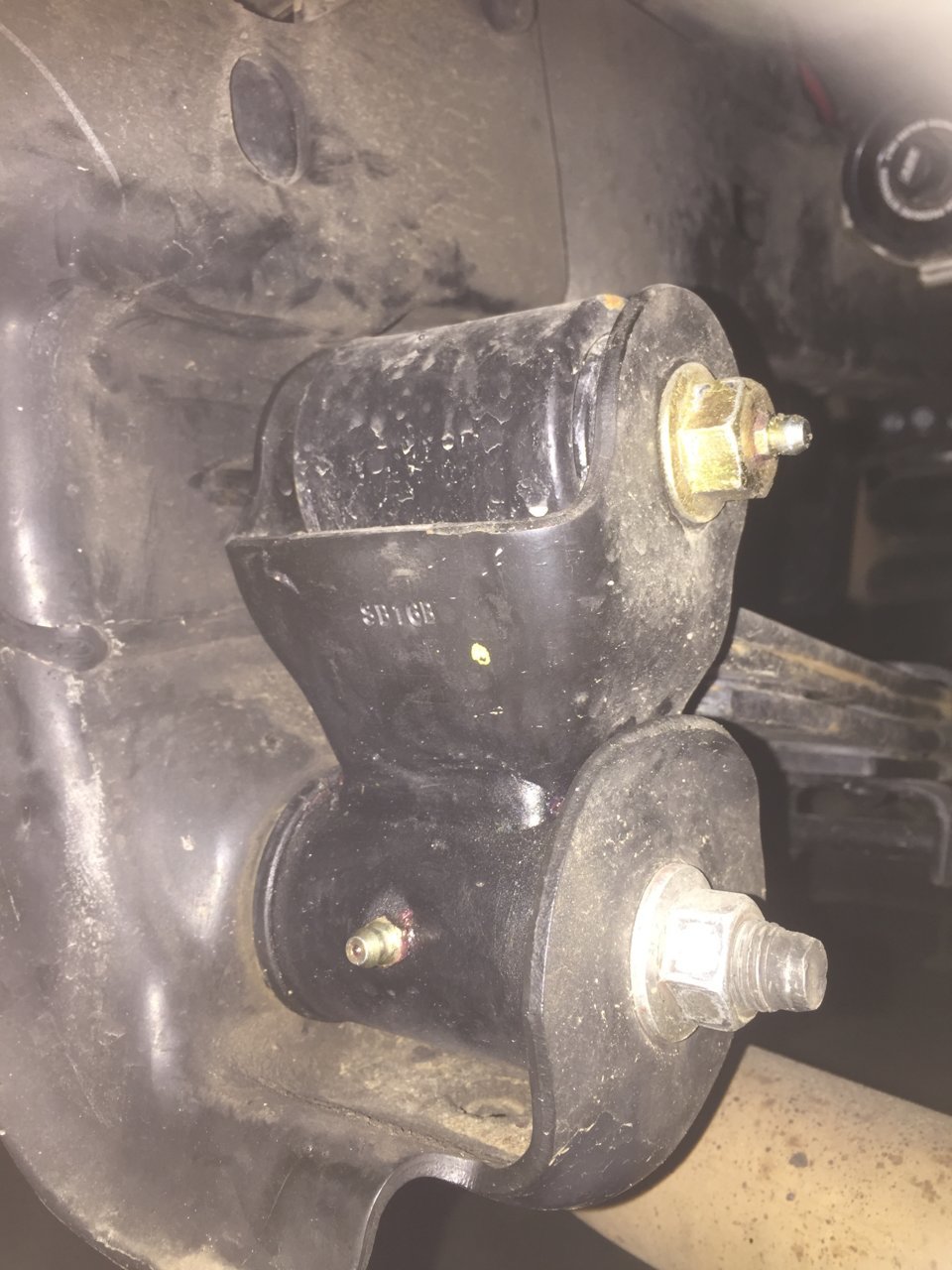

    Do I have to drill out the shackle hole to 9/16, or can I use the Dobinsons greasable bolt I already have since I just bought new OEM shackles and made them greasable. See attached

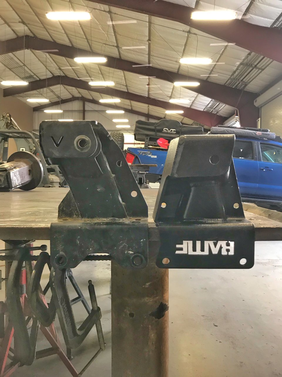

    Here's a visual comparison that shows where the lift with AG comes from.

    You need to run the bolt the other direction with our hanger so no that zerk fitting will get knocked off most likely.
