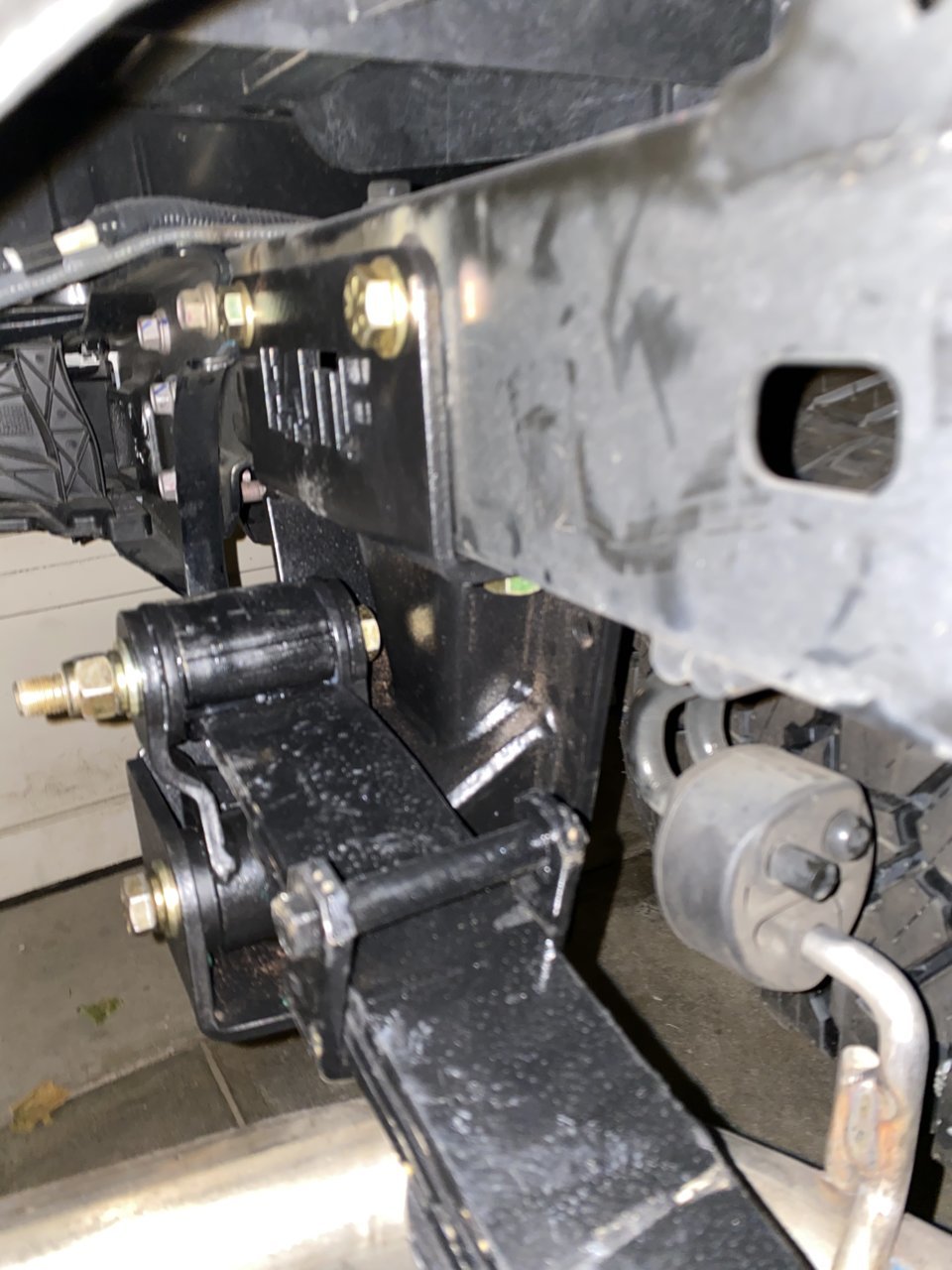

    Just picked the truck up from the shop after getting the hangers and shackles installed as well as the Deaver expedition stage 1 leafs. Rides a lot better!A422586A-745B-452C-B128-E7528BD1112D.jpg
  15. Apr 30, 2020 at 7:35 PM
    #1155
    ZekeR7
    ZekeR7 Well-Known Member
    Jan 19, 2018
    #241779
    1,280
    2018 TRD Off-Road 4x4 Quicksand
    How much did the shop charge you for all that?

    $350 for the hanger install and swapping the leaf springs.
