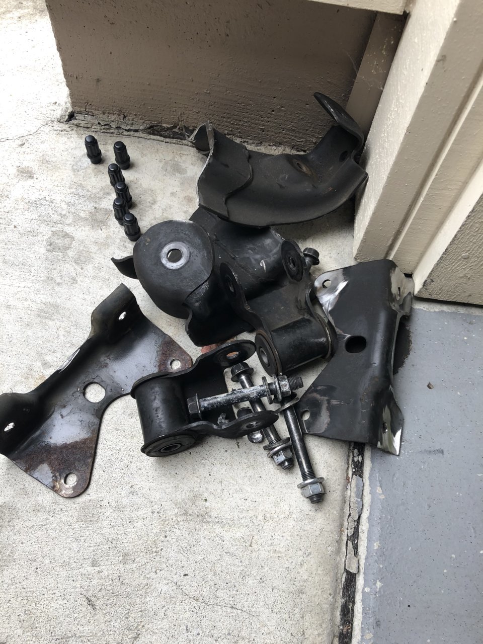

    What a pain in the ass! Almost done. Fastening it all up now. Taking a beer break.

    CA hacksaw massacre

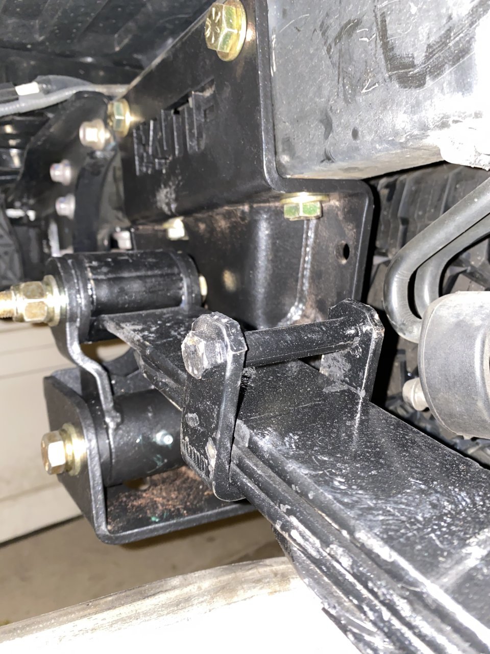

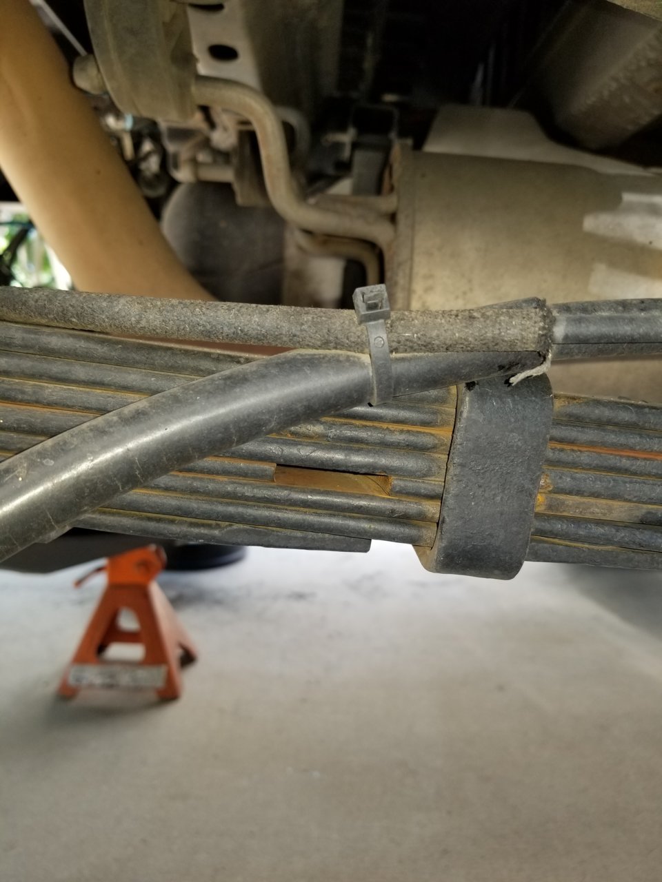

    I do not want to ever do this again. All done and im ready for a nap. For those with Icon RXT leaf pack, i trimmed just a few mm off each 2nd leaf. No biggie and it took all of 5 min.

    Roughly how many mm did you had to trim?

    Maybe this can help.

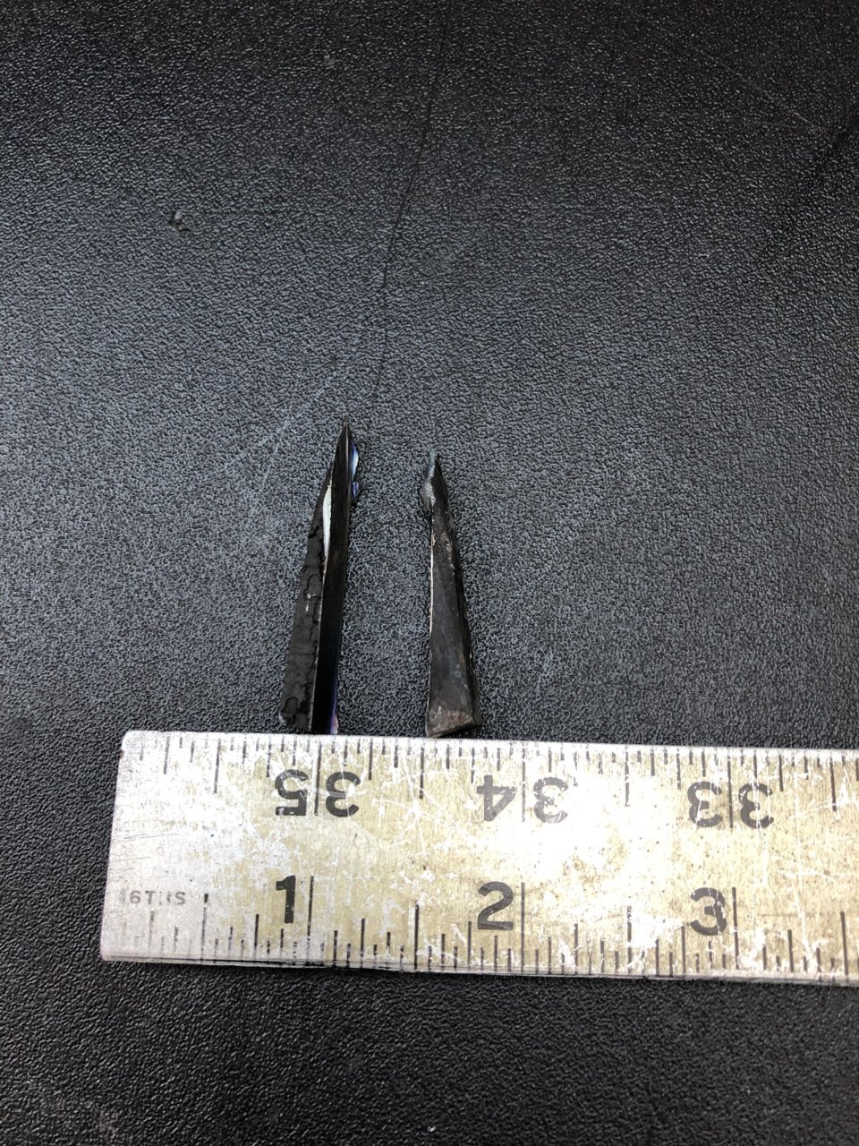

    I have tried to keep up on all of the post, but I now have a busted spring. Do the Devers expiditon springs need to be trimmed? See pic of what I found yesterday.

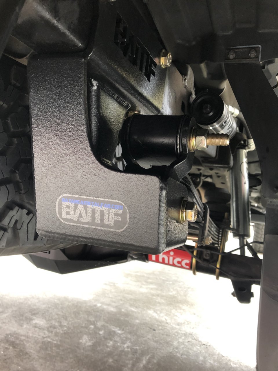

    Deavers fit with no need of trimming. Not a great pic but can see the clearance.
