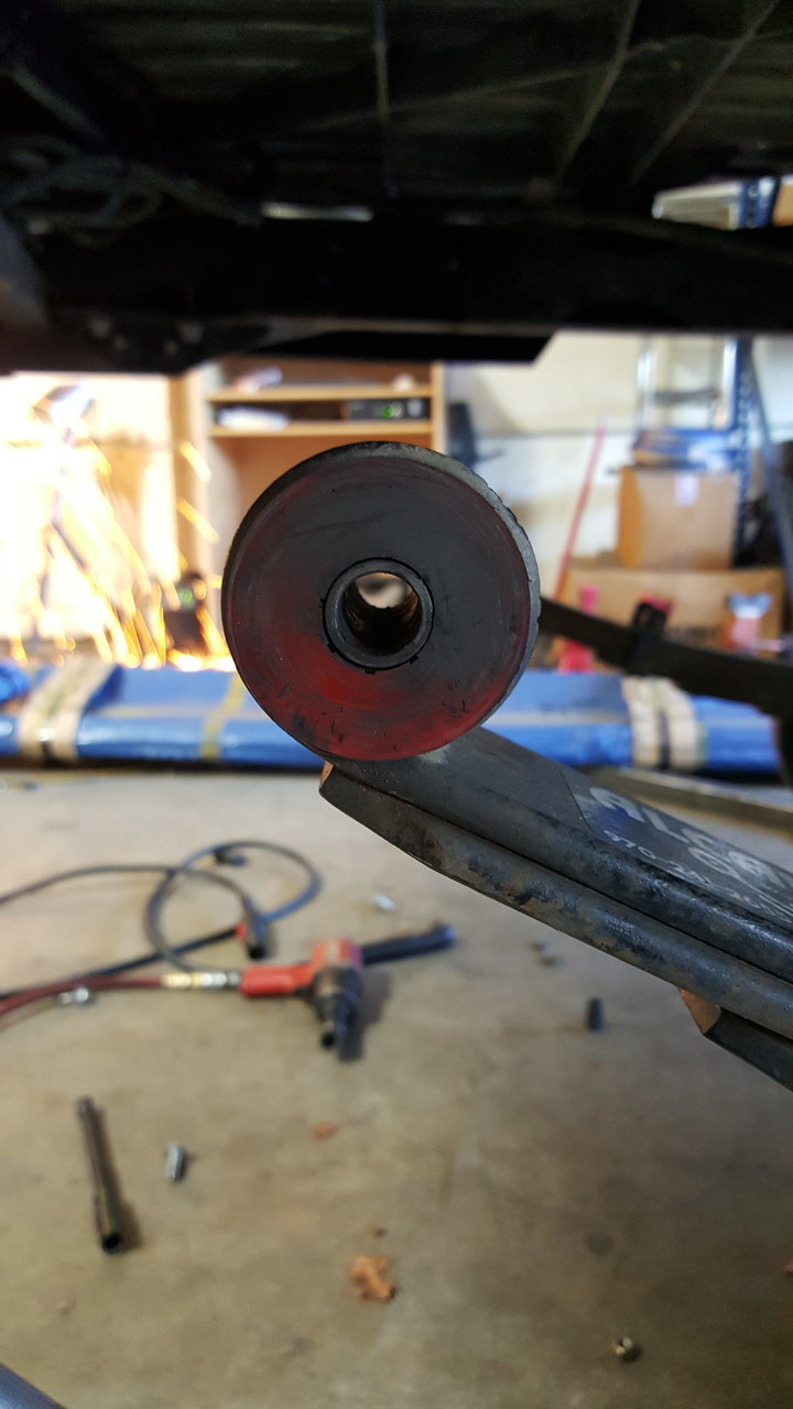

    I can confirm ATO shackles will not work with Alcan springs as well.
    If your leaf springs look like this ATO shackles will not work because of the center gusset.

    Dakars look exactly the same. I'lll just stand by for your HD shackles to come out. Thanks Jerry!

    Dammit. Guess I Need to buy your shackles.
    Edit: Those are my Alcans btw, in case anyone else has them.

    Looks like the main issue is the centered shackle gusset. The stock ones should work if you get the hangers before the shackles.

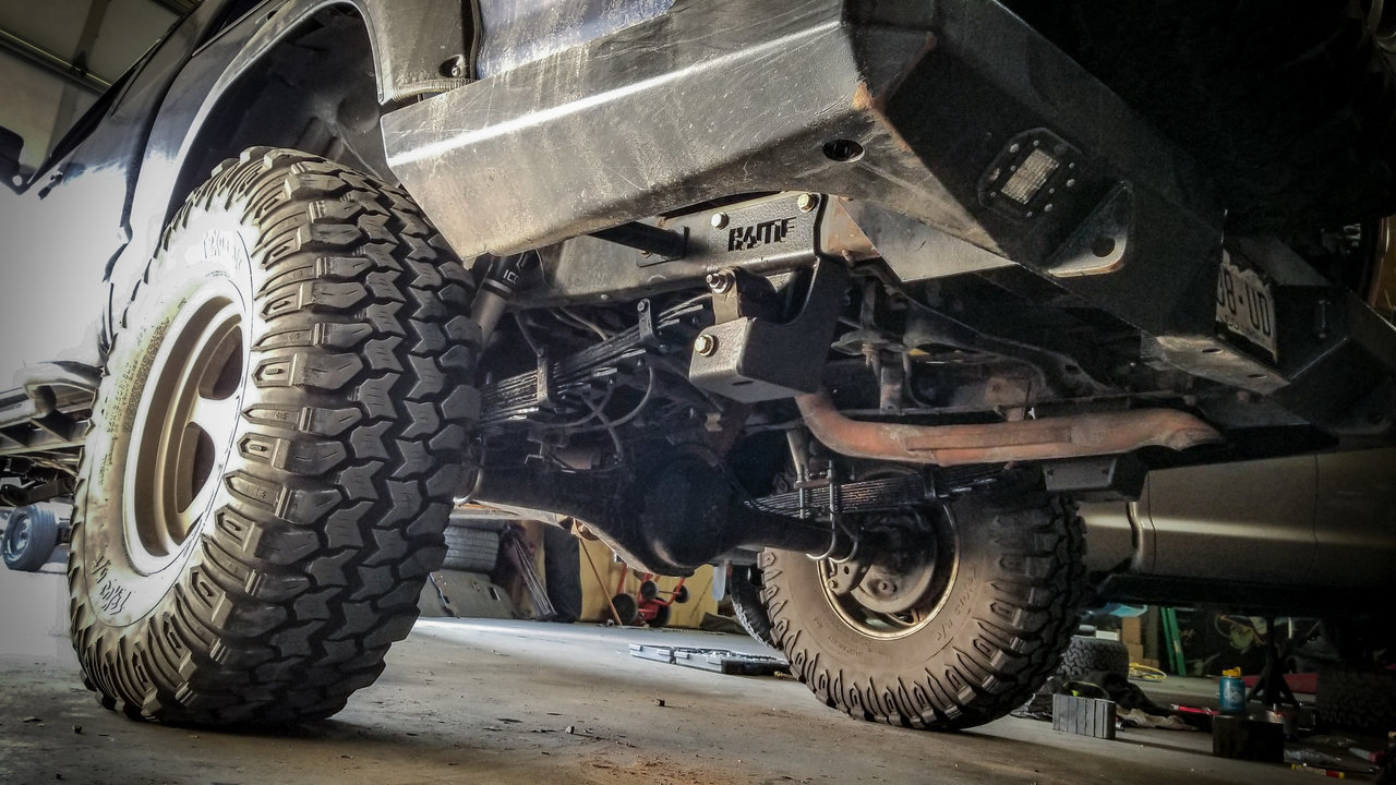

    Removed ATO shackle flip and installed BAMF HD shackle hangar today. Had ATO HD shackles and Dakar leaf pack. Drilled out the shackle sleeve to 9/16, don't like it. Shaved down the gusset in the ATO HD shackle, don't like it, but it doesn't contact the leafs. Lost an inch of lift, don't mind that because now truck is almost level, has very very slight cunt hair of rake. Soon as BAMF HD shackles become available, I'll want to swap those out for the ATO's. Now that I've done this, time to re tune the drive shaft to kill the vibes again. All in, I like the BAMF shackle hangars better than the ATO flip.

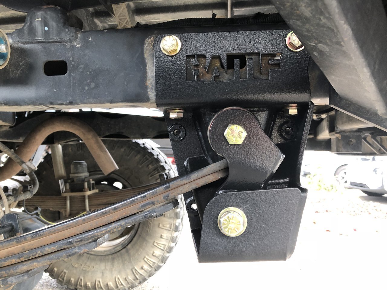

    Installed. Easy enough

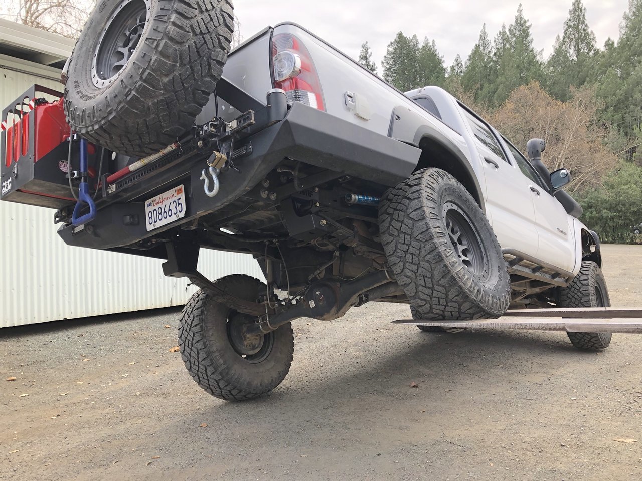

    Thanks @JLee for the hangers and prototype shackles. The ATO’s won’t clear some Alcans since the eye is standard and the 2nd leaf extends under it. These things are beef, just like everything else Jerry makes.
    Please keep in mind that these springs were meant to carry 1,200 over stock, so it was hard to get them to travel without that weight. I still had about 1/2” of daylight, between the extended Superbumps and the frame, when the front lifted.

    Flex test without the mobile tree fort? I'm disappointed. :p
