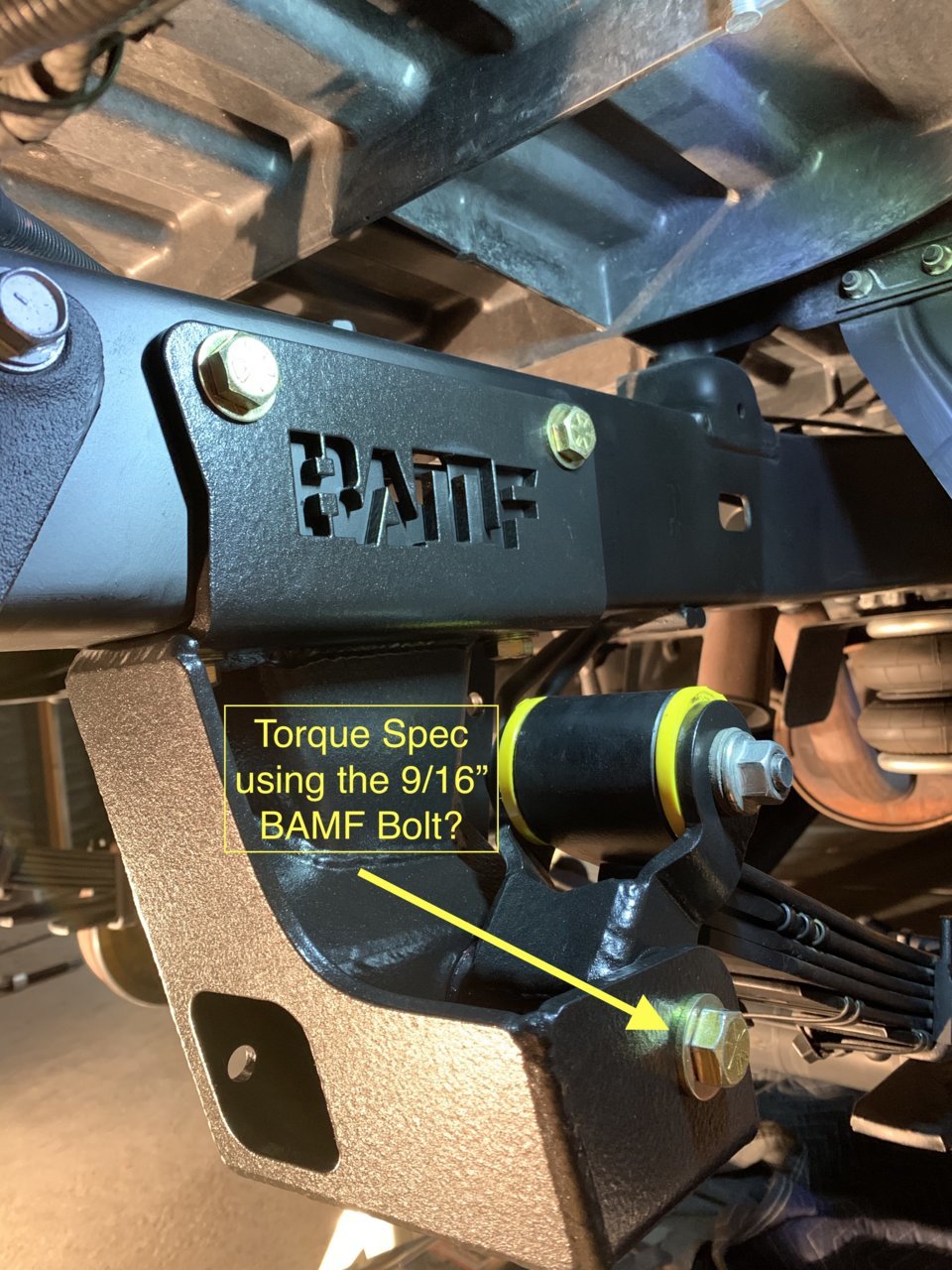

    Good morning fellas, got one side in last night. Finishing up the other today. Wondering if anyone can tell me what torque spec they put on the lower Shackle bolt if using the BAMF Hardware? Is it same as Factory @89ftlbs? Also, it's the updated hanger, which means the nut being used on that bolt is a Nyloc, there is no captive nut, I don't know if that makes a difference. Thanks.

    I've just been using OEM specs, which I believe is ~89 ft/lbs. Jerry mentioned it an least once in this thread somewhere as well.
    Edit:
    found it:

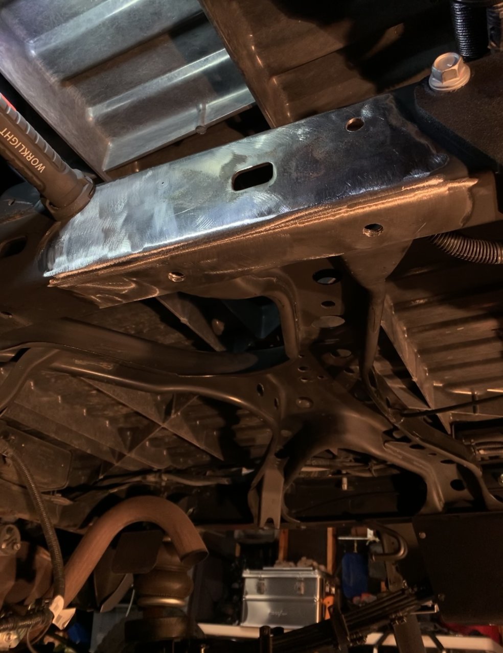

    Punching holes and test fit on Driver side.
    Carnage

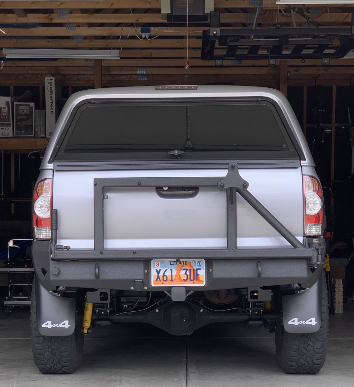

    Well they're in. One hell of a project, & one hell of a product! Threw the spare back on the tire carrier after this pic, and took her for a test drive to settle the suspension. 'Planted' is definitely the best word to describe driving now, IMO. It just completely eliminated that rebound feeling coming off the back end. Stoked! Next step is a crossmember. But overall very happy with the end result!
    Also don't dog me too hard on the OEM mud guards, LOL I've been getting too many fix it tickets & decided to throw them back on. UHP has been on my ass!
