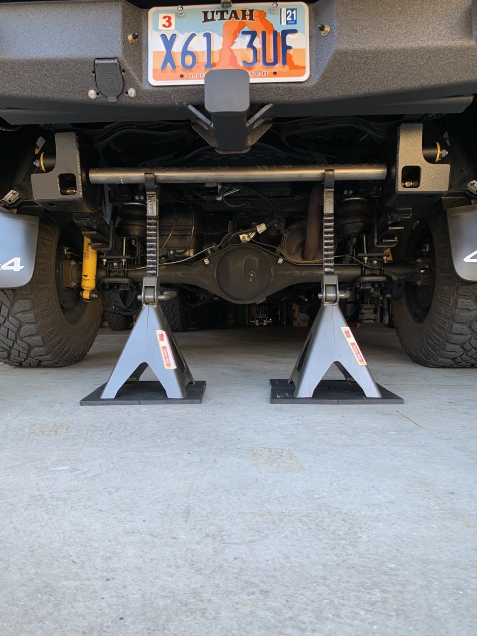

    SLCGUY
    SLCGUY Well-Known Member
    Apr 28, 2015
    #154145
    122
    Kyle
    Salt Lake City
    2015 Silver Sky Tacoma TRD Off-Road
    Little mock-up, getting a visual on how she’s gonna look and fit

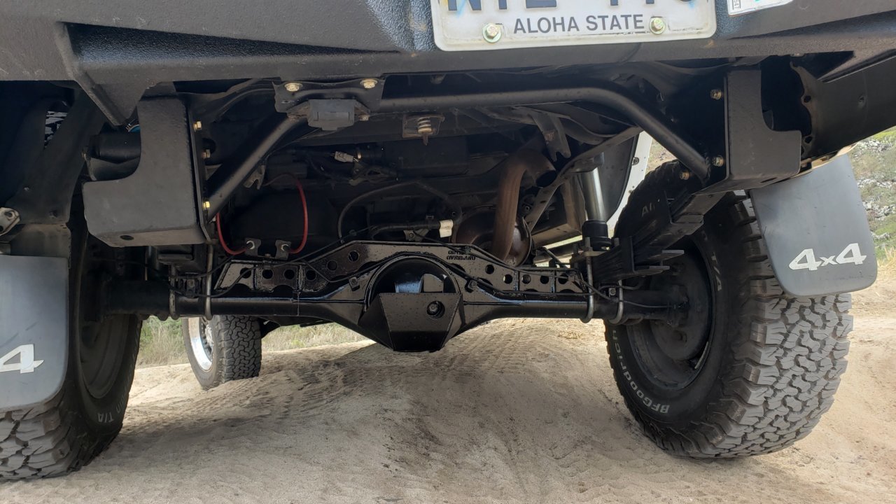

    ACE808
    ACE808 Well-Known Member
    Mar 15, 2010
    #33299
    141
    DDS
    808 State
    TRD Off Road 4x4
    Toytec 3" lift light racing uca moto metals 17" (958) k&n intake Helix throttle body Borla exhaust Nfab step bar All-pro transfer case shield All-pro spindle gussets All-pro sway bar links All-pro E-locker guard All-pro rear differential armor All-pro U-bolt flip kit L.E.D. White/Blue Dash Gauge lighting Full alpine stereo with TV screens Clifford alarm optima red top battery Full wet okole seats auto meter gauges (oil pressure & volt meter) Ebc slotted & dimpled rotor Goodrich braided brake lines Hawks Lts brake pads Rear diff breather relocation
    BAMF Shock relocation kit, Hangers, Shackles, Custom Crossbar, Diff Armor, Axle Truss, OME Leafs. Stoked with this setup. 20200802_132848.jpg

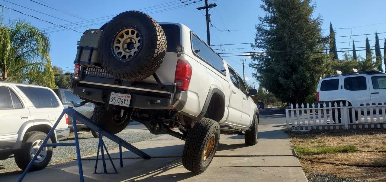

    Vegasstunts
    Vegasstunts Well-Known Member
    Dec 27, 2019
    #314287
    751
    16 TRD sport
    All of them.
    Cool. I keep a eye out. I'm local and have your rear bumper. With some slight modifications lol20201107_144449.jpg

    SLCGUY
    Apr 28, 2015
    #154145
    122
    Kyle
    Salt Lake City
    Same. I just did straight cuts on the tubing. Did another test fit with the crossmember plates and she wedged nice and snug between the two. Just need some time to get em welded.
