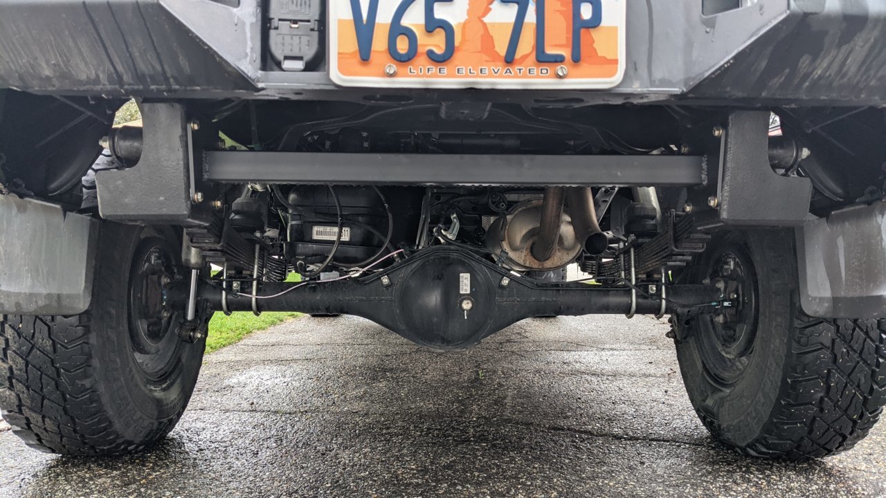

    Paint has been halted due to a very nice, much needed snow day. But she’s getting there!

    Crossmember ✅

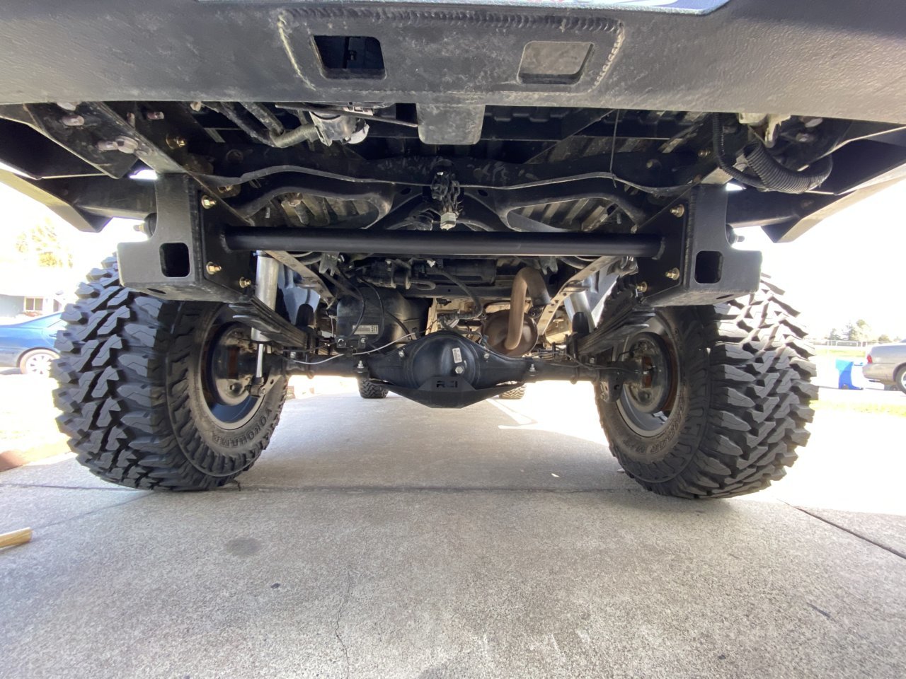

    Bamf hangers and shackles installed with custom crosstubing

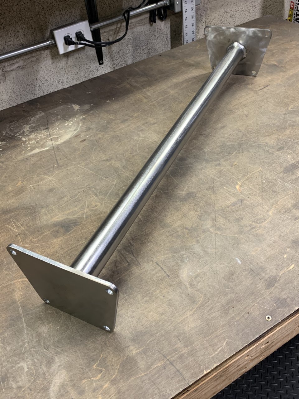

    Fabbing up the crossbar finally

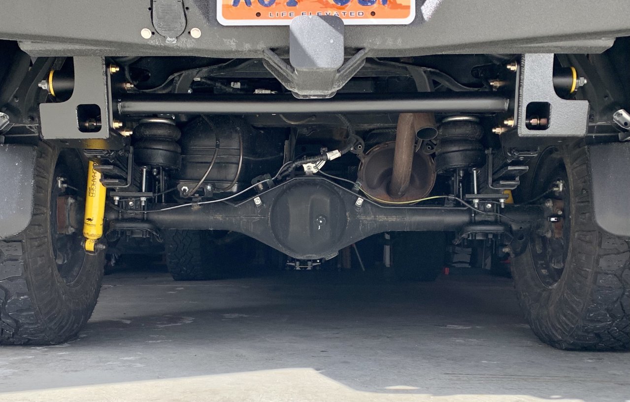

    Cool. That makes sense. I am painting and did the same. Came out easily with the exception of the weld nuts. The plates fit over them like a stud and make removal interesting after welded. I had to spread the rear hangers to remove for the final welds and paint. The updated version looks a bit simpler.

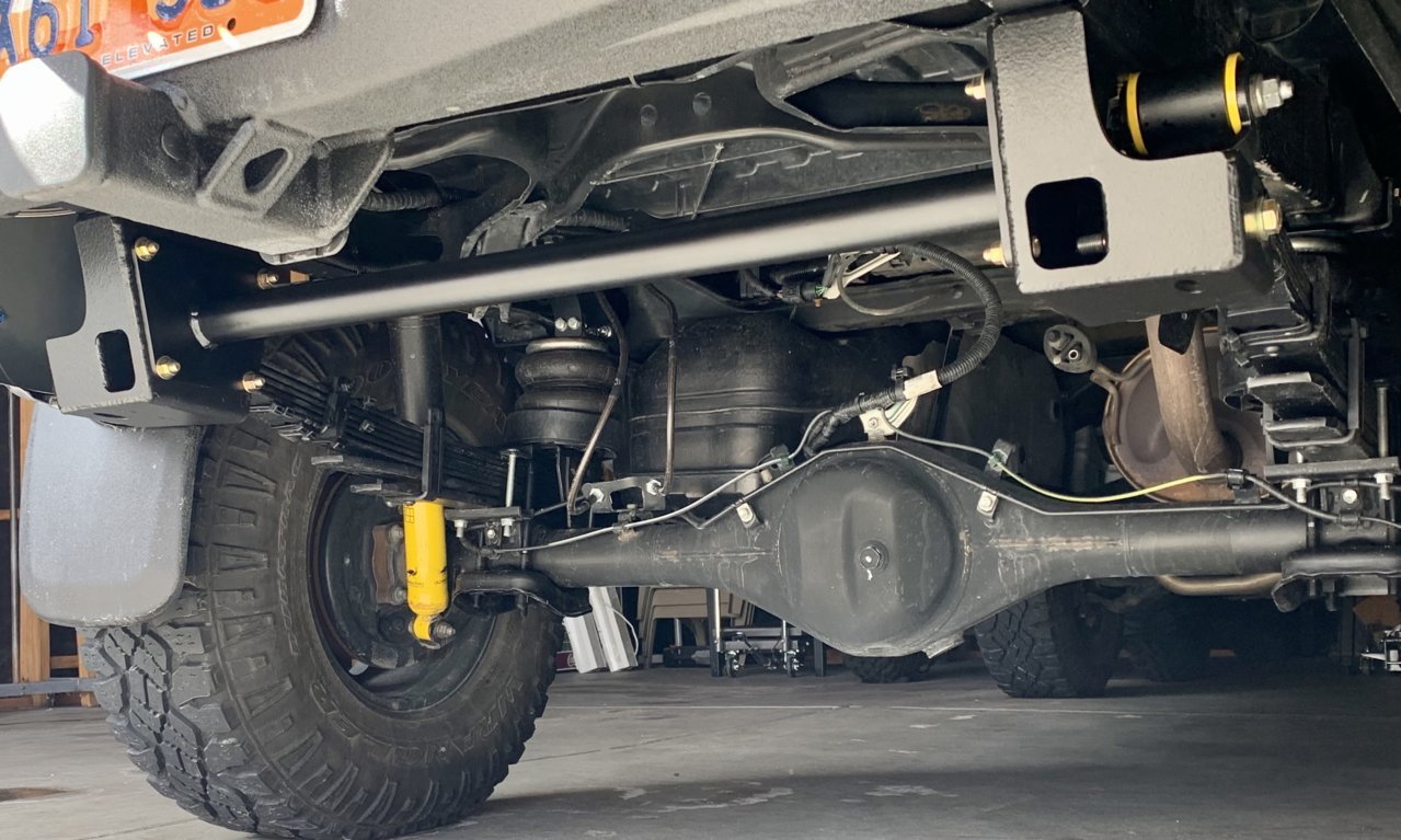

    Final product. I'm pretty pleased with how it turned out. I was amazed by how much I could flex the frame pushing on the hangers along the axis of the crossmember with my bare hands. This should solve that
