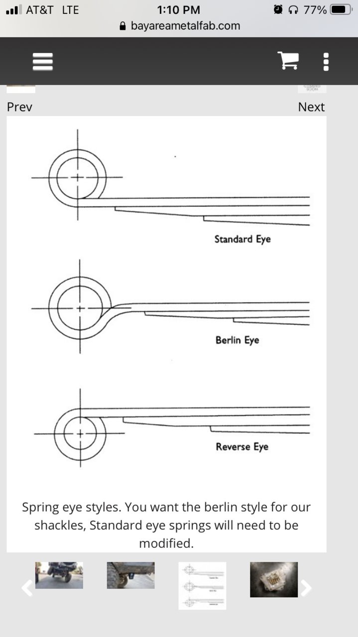

    So I saw some pics of the OME95R on here of some people trying to make it fit with the shackles and hangers. If its possible could someone post up here a little but better of a picture of where exactly they trimmed that second leaf to get it to fit and work. Thanks in advance.

    Hey @JLee I’m installing a full bamf rear end for someone and am having issues with the shackle binding at full droop. Droop it out so that the shackle is just about metal to metal with the hanger, then go to jack the axle back up and it binds and just lifts the whole truck and the shackle doesn’t pivot.
    I see you mention using a Berlin style wrap on the leafs. Is this what is causing the binding? The leaf just pushing on the shackle at the wrong spot?

    You really don't want the shackle going past flat at full droop if it inverts it could want to stay like that until you hit a bump. what shocks and springs are you using?

    King 2.0x12’s and icon rtx or whatever they’re called. Customer I’m doing it for provided all the parts and was missing a few things like resi mounts and extended brake lines. But thanks for the input. He wanted to add limit straps so I’ll make sure to measure for them so that the shackles don’t go past horizontal

    So I’ve gone I over this thread, Berlin style hangers seem to me the best ones if not they need to be trimmed. Has anyone purchased any from atssprings and had luck with no modifications. Just bought a Travel trailer and want to finally upgrade the rear leafs but at the same time make sure they work with the hangers & whatever shackles I end up getting

    Are Deavers Stage II Berlin eye?

    Yes, the U402 springs are Berlin style.
