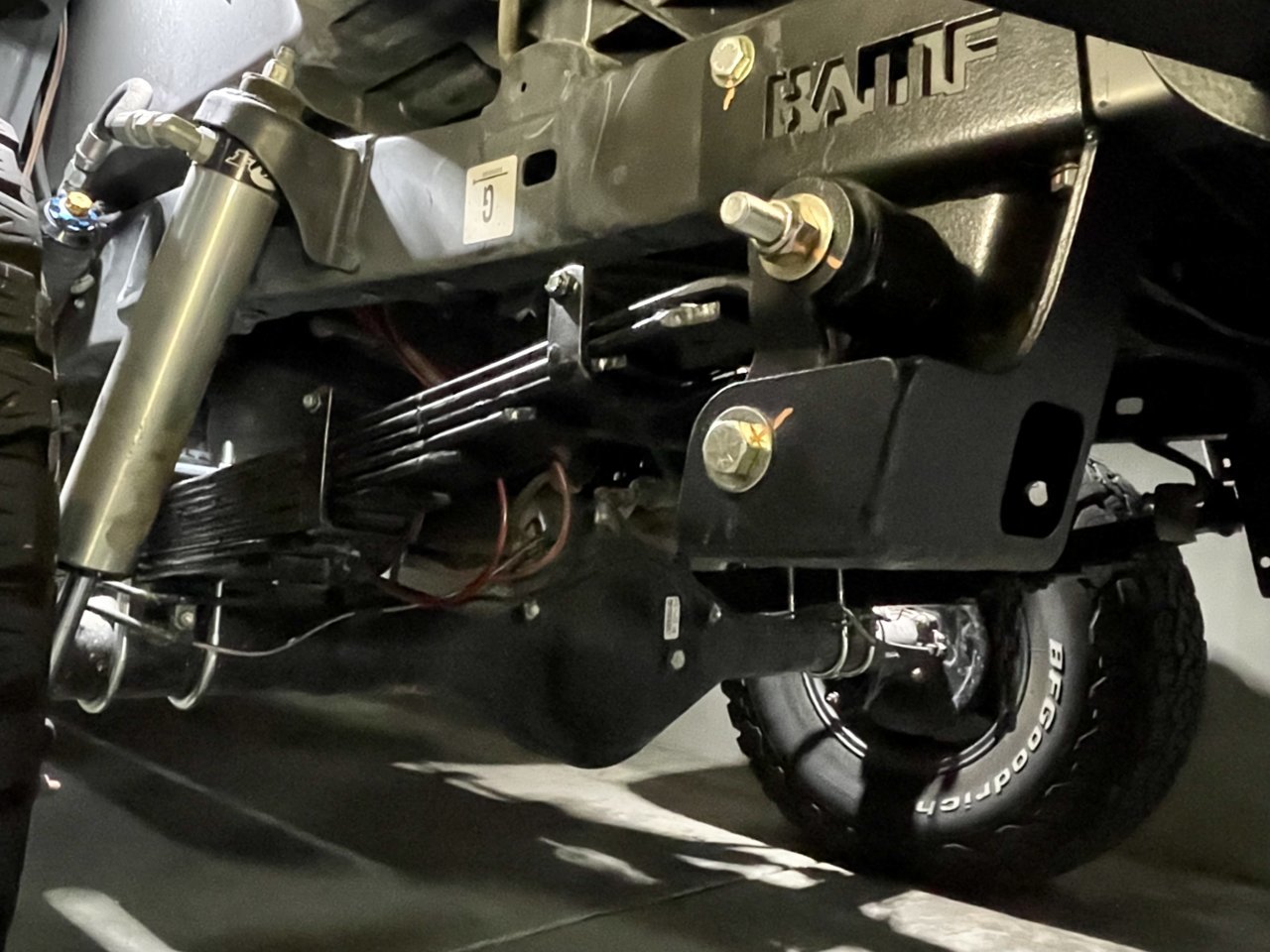

    Installed mine A. It looked to me the same geometry at the stock how they came out. And can actually grease it super easy lol

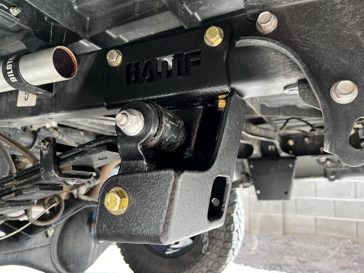

    Done! Ordered by me, paid for by wifey, installed by Beeps. I did something right!

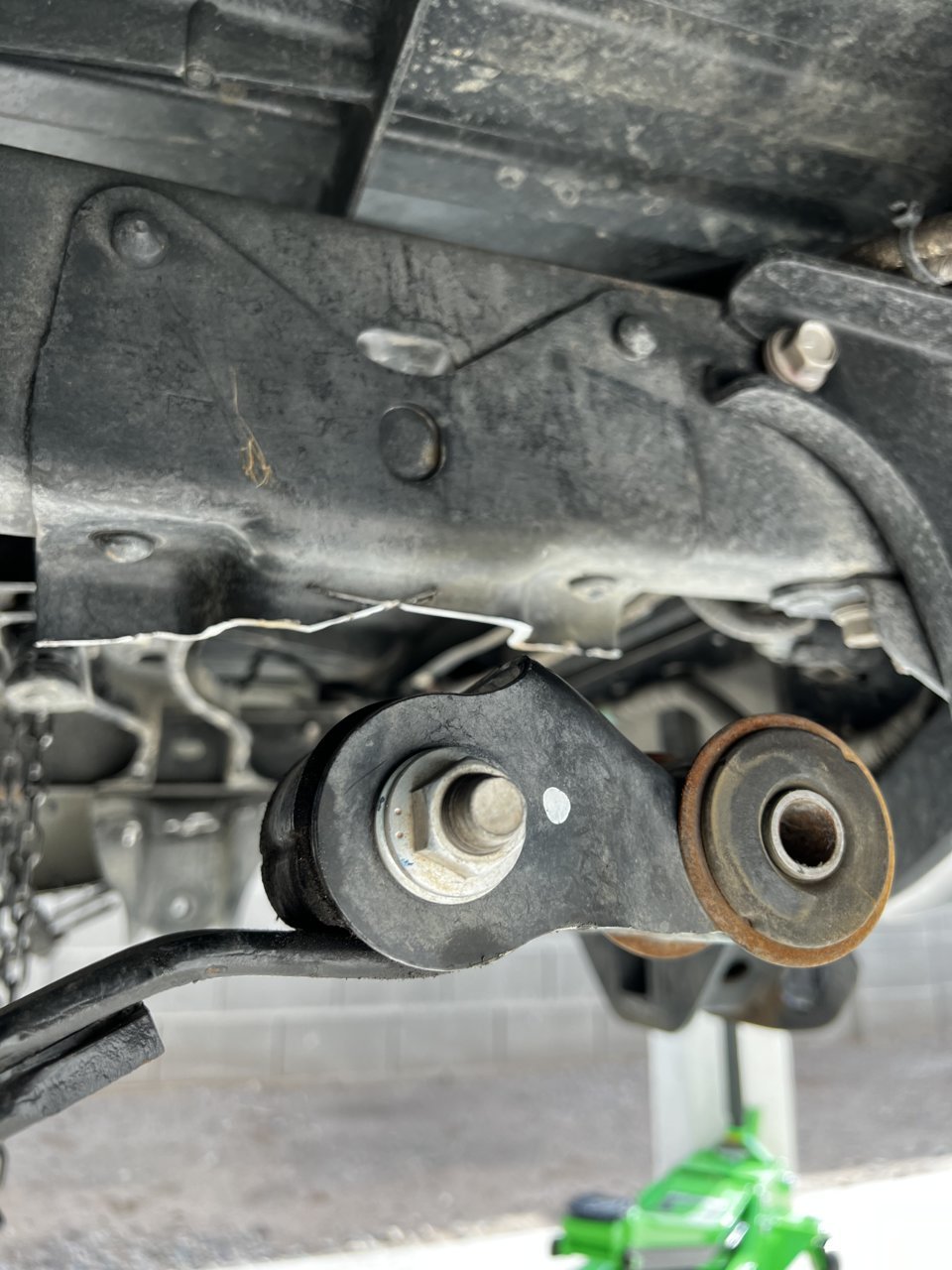

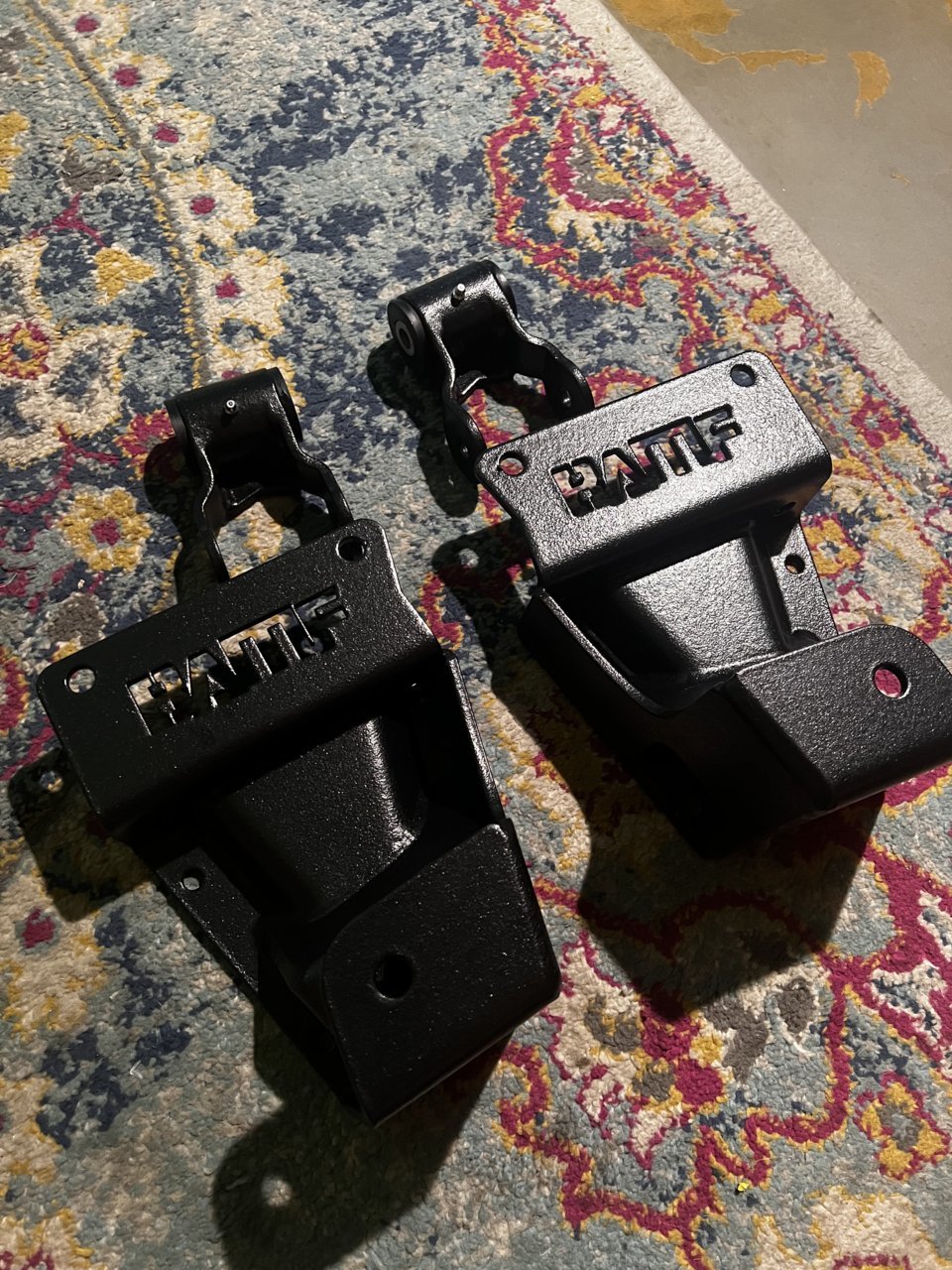

    I’m going to chop out the old hangers this weekend. Any recommendations on what type of bit I should use to drill out the rivets?

    Grondnthr heads of the rivets flat, and use a beefy punch (I have one from an old air hammer) and a 2lb sledge.
    Works pretty good

    Thanks for the advise. I ran out of day light yesterday so about to get back to it and finish it up today. I used a ball joint press tool to punch out the bottoms after grinding everything flush. Worked really well. Just need to finishing drilling out the holes, flap and paint the frame and reassemble. Hopefully will be done in the next few hours.

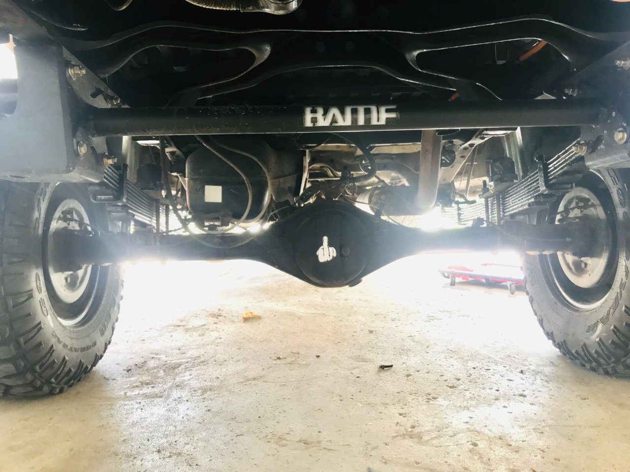

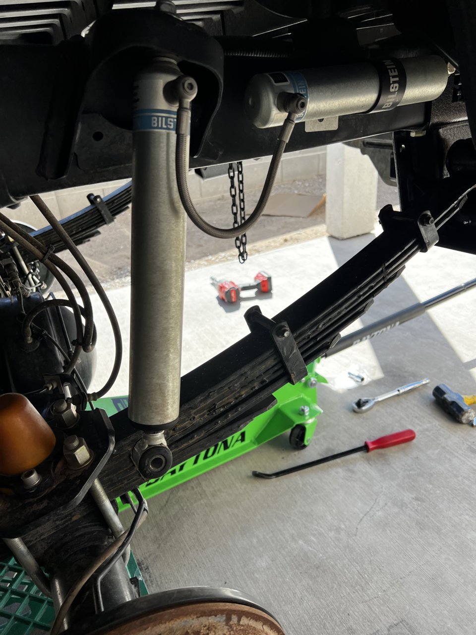

    Finished up. Had to use the stock bolts for the shackles to springs because I didn’t want to drill out the bushing sleeves. Maybe another day. Found one of my 5160’s is shot so now I have a good excuse to go to 14” 7100’s. Relocation kit has been ordered.
