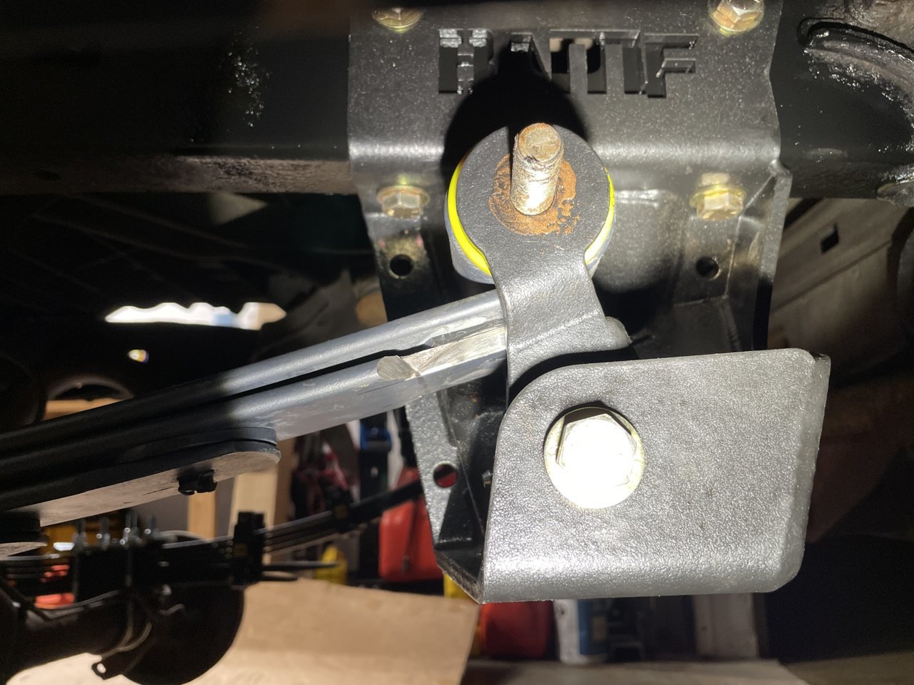

    Has anyone else had problems with the shackles locking forward at full droop?
    Hd hangers & hd shackles
    Running dakars
    currently no shocks if that makes a difference. Just cycling right after install.

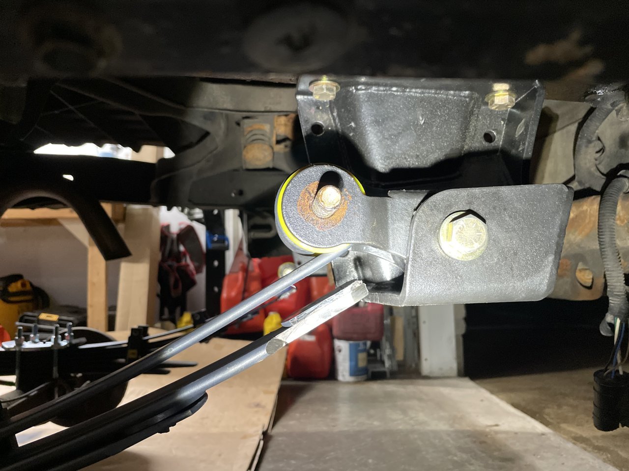

    I’ve helped it passed and cycled it to ride height then just comes all the way back and locks forward at full droop again
    grease nipple is forward
    *edit*
    The rest cycles fine to ride height after helping the shackle about 1/4”

    I haven’t had this problem yet but I’m going to be adding limit straps next week for that reason. You may also want to trim that second leaf. You can see where it is making contact with the shackle.

    Your shocks (12” or stock) will be the limiting factor, it’s not going to lock then.

    And already trimmed, i just havent painted it yet
    That mildly concerning for if/when a shock were to break on the trail.. since we all know shit happens lol

    No matter what you do you are limiting the travel. That’s the point. If you droop out too much and the shackle is getting stuck, you limit the droop to where the shackle doesn’t go past horizontal. No matter if you use straps or some kind of spacer, your doing the same thing.

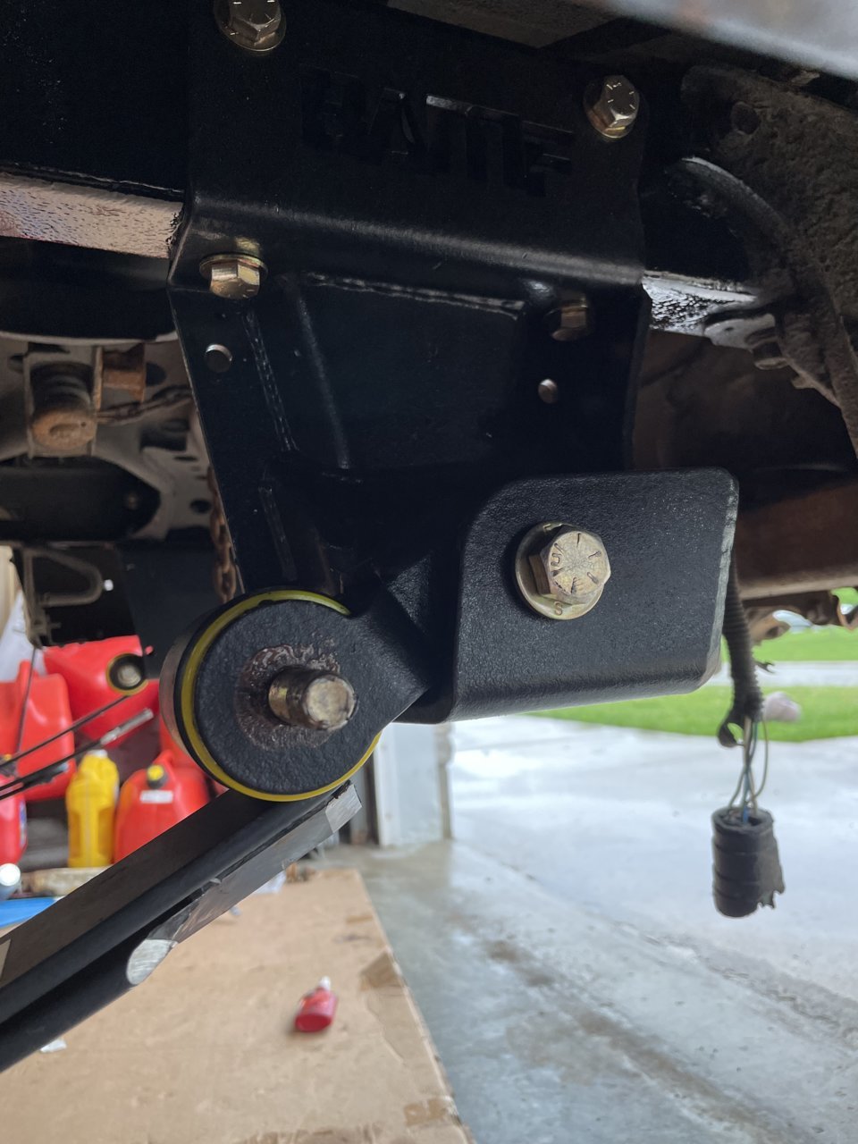

    Quick update with the shock installed
    full droop
    Ride height

    I’ll take nylon straps tensioning over metal on metal contact of a spacer. You might be able to make a bump out of a softer material to limit travel at the hanger but strapping is easier, cheaper and how it’s commonly done. Straps fix the problem you reported but you do you.

    Trim that second leaf an inch
