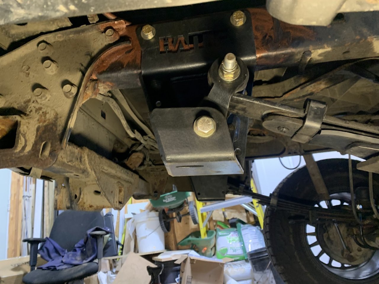

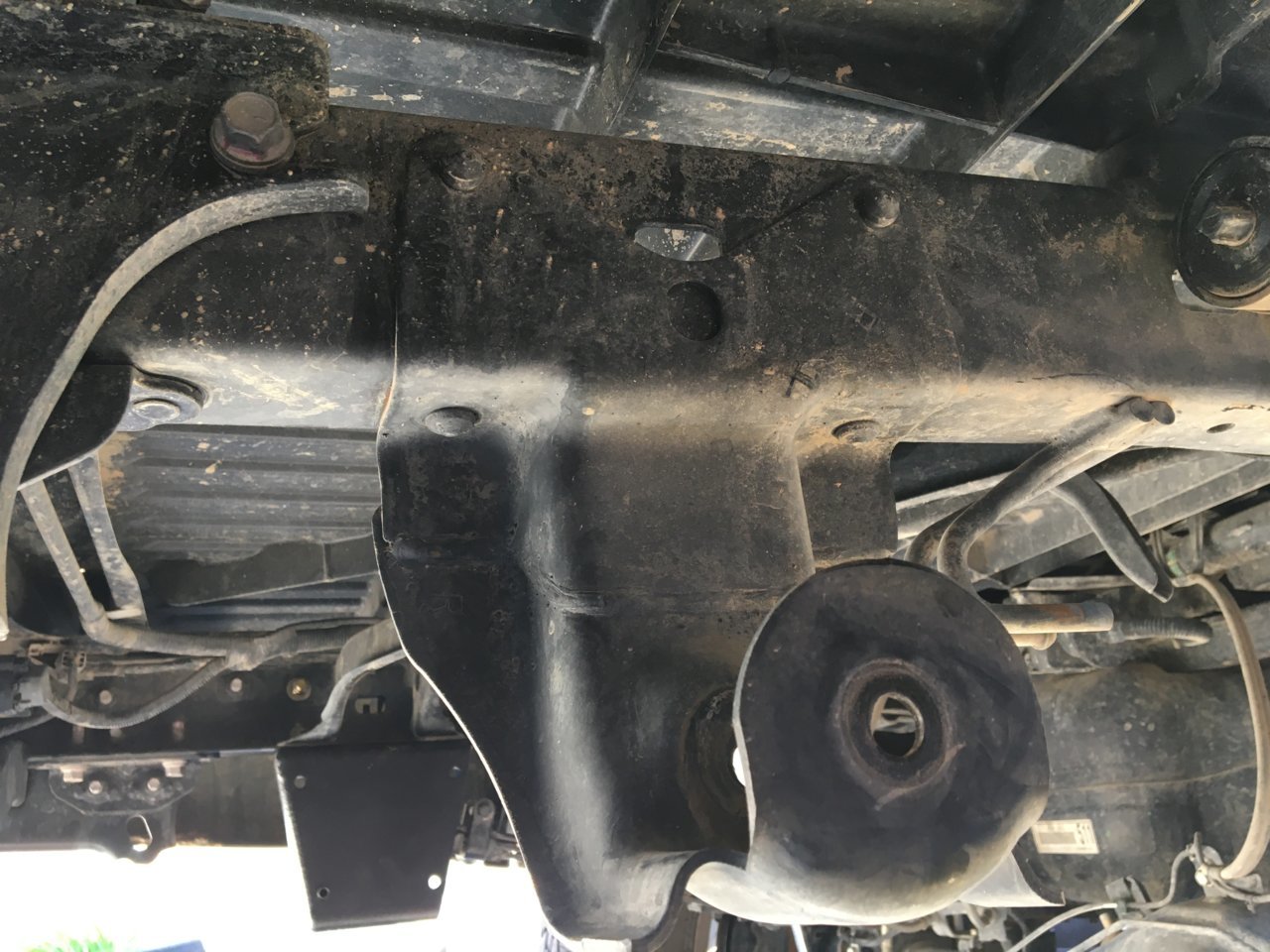

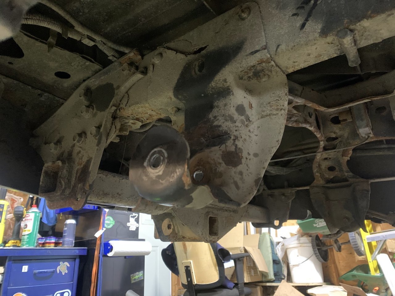

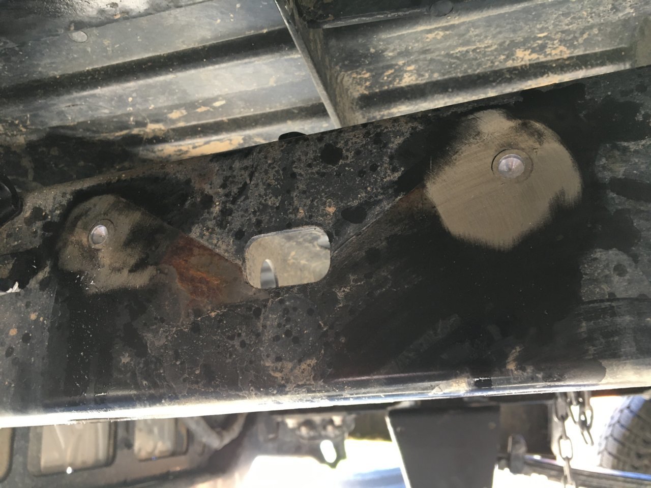

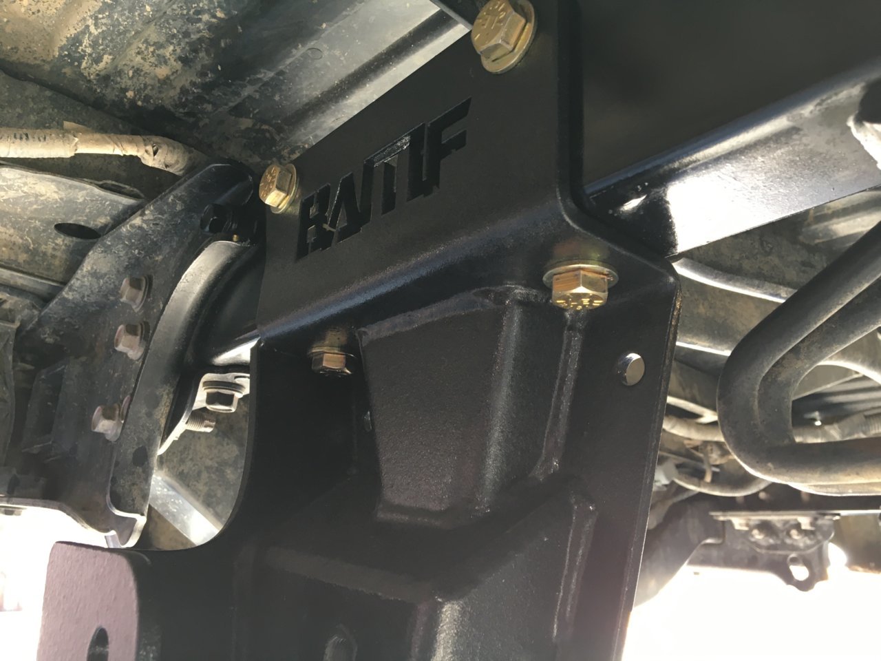

    Install really wasnt too bad. Now we've got the beef.

    Looks great! What was your rivet removal method?

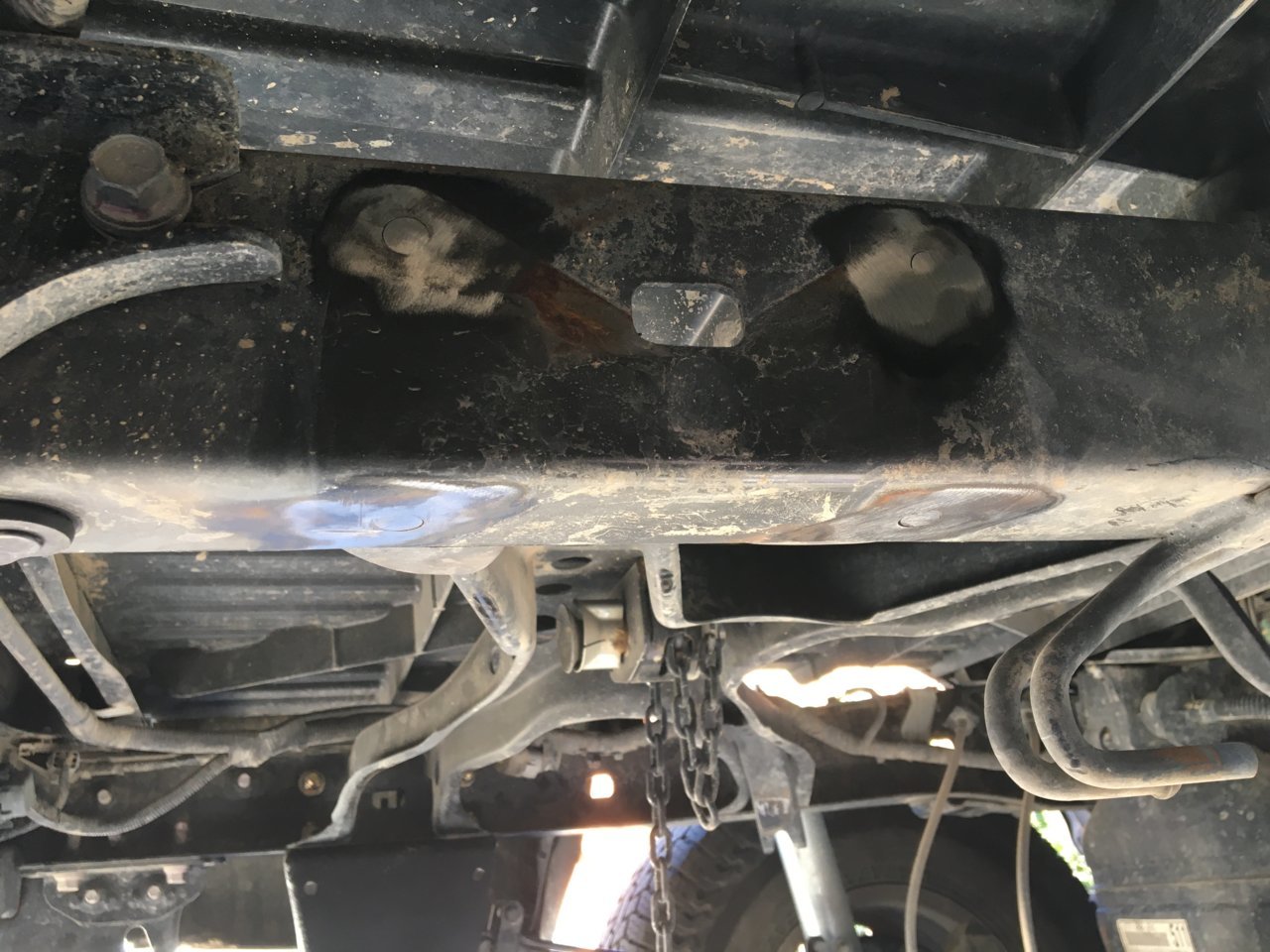

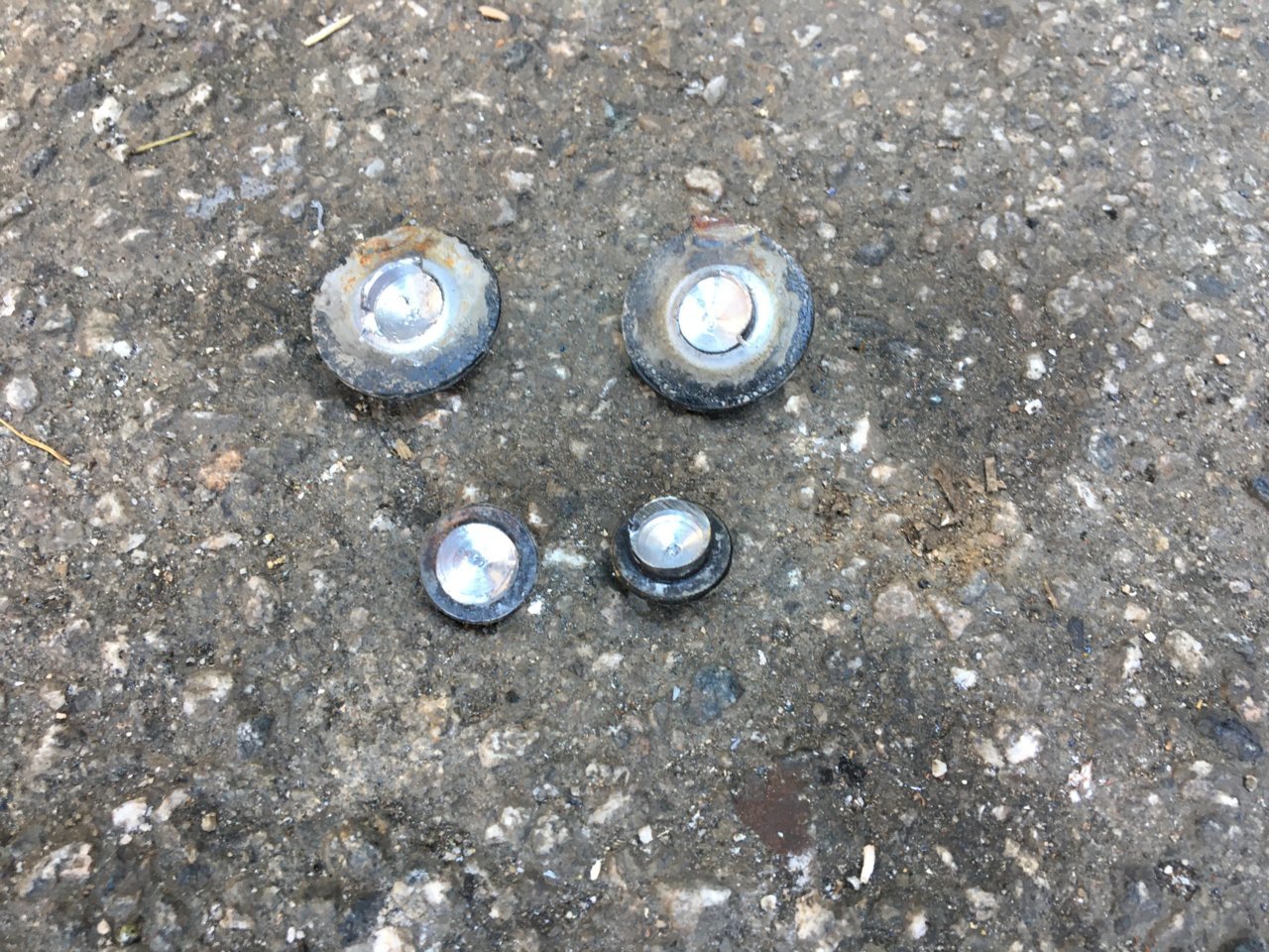

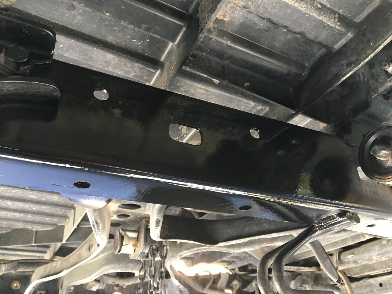

    I cut the hangers off then cut all the rivet heads off. Pry off remainder of the hanger. Grind rivet down to frame then centerpunch center and drill a divot with around a 3/16 drill bit. Air hammer for horizontal and ball joint press for vertical ones. Finish it off with a cold beer.

    Id definitely buy an air hammer if you dont have one. With my method taking out the rivets only took about 20 min per side.

    I’ve since started using a cheap ball joint press for the rivets under the frame and it’s faster and easier than drilling them out. Still grind them flat, but just use the press to pop them out. The x-member sometimes absorbs some of the shock from hammering so they tend to be tougher to just pop out with the center punch. The two upper rivets come out just fine using the drill and punch technique. I haven’t timed myself lately but I know I can get these installed way faster than most quoted times using this method, but my experience has a lot to do with that too.
