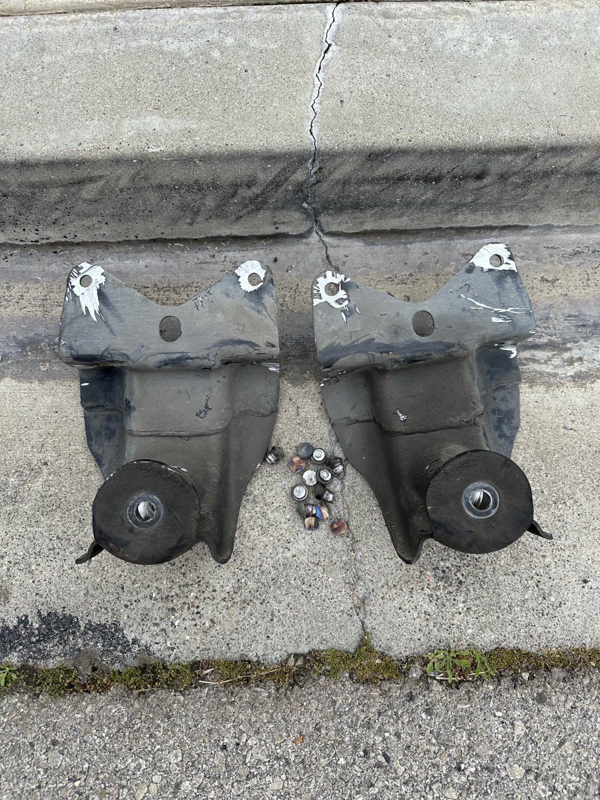

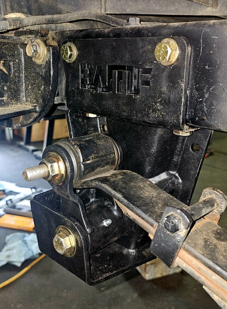

    Been sitting in the garage for about a year, but I finally knocked it out today. Definitely labor intensive, but pretty straightforward. Those rivets definitely put up a fight. Awesome product though!

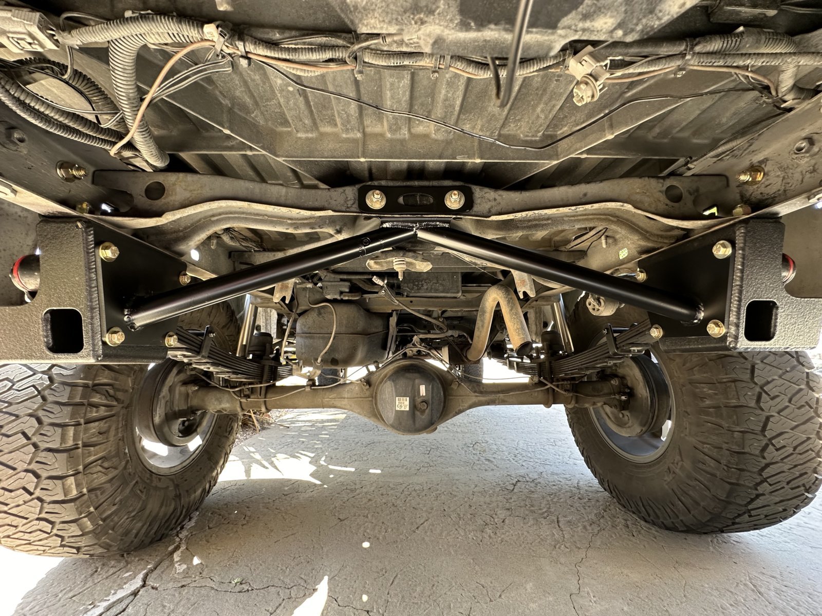

    Got the cross brace in

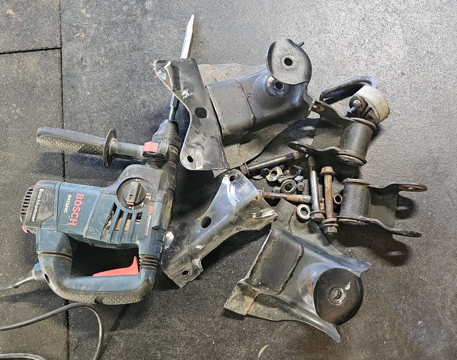

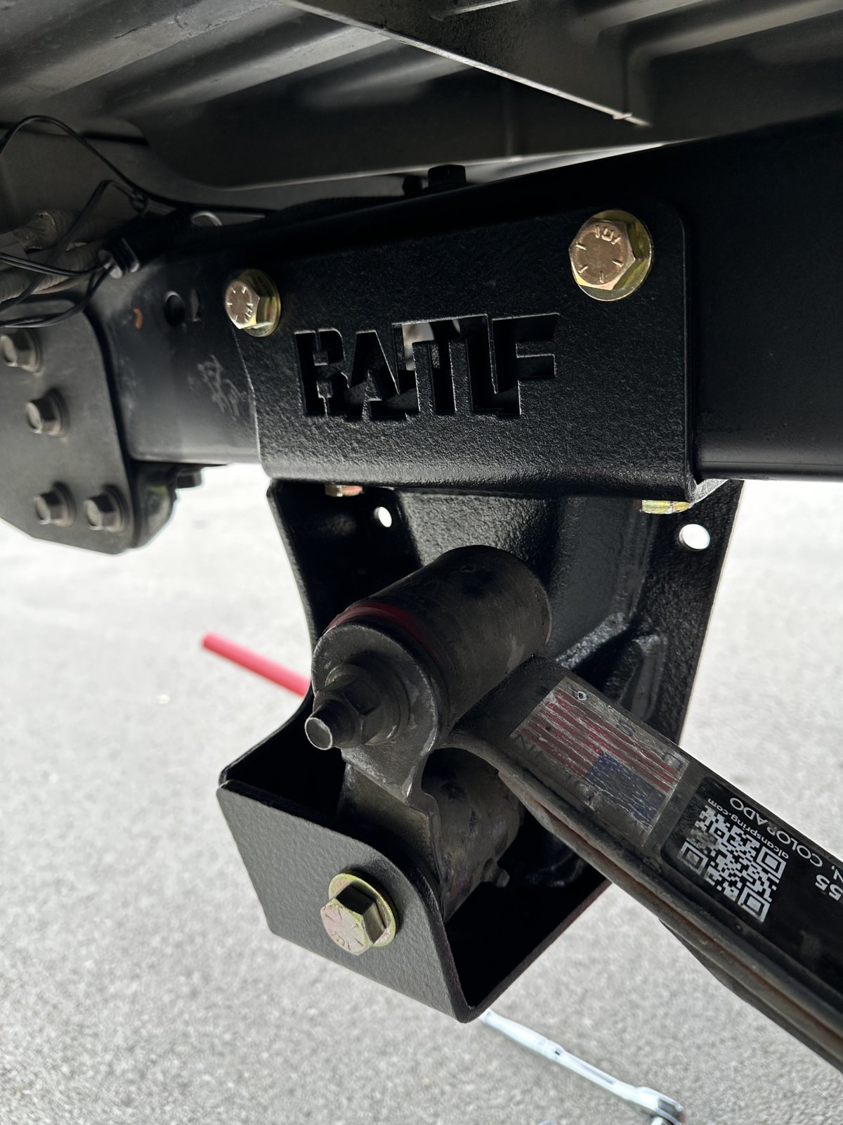

    I just installed these hangers with new HD shackles. I read through this thread and that people were having such a hard time getting the rivets out so I followed the advice of those that didn't drill them out but instead punched them out and used ball joint press. It made the job not that bad in my opinion. It was hard work and took a while. I did not have an air hammer but I do have a roto hammer drill so I used it to punch the rivets on the side and then used a ball joint press that I rented from Napa and the rivets came out quick.
    I highly recommend replacing the stock hangers if you're into rock crawling. I dragged the bottom of this truck over a lot of rocks last year and damaged the hangers pretty bad. One was pretty bent and it bent my leaf slightly which made it harder to get back on.
